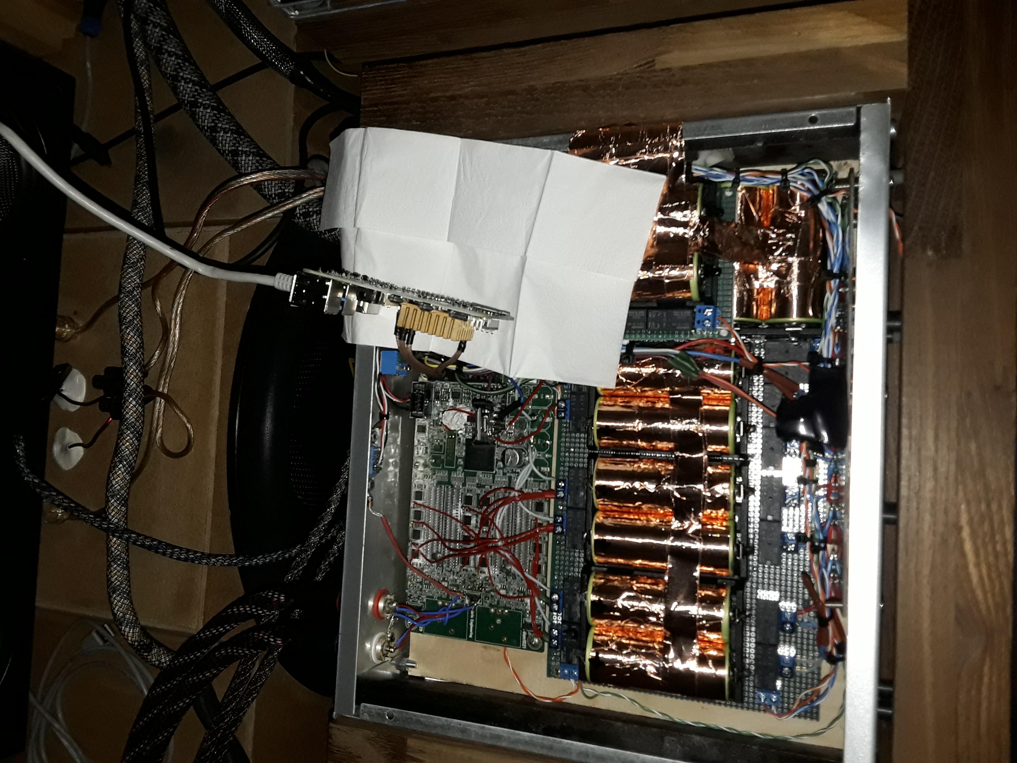

Wahooo! I'm in business. Just finished hooking up and testing my 300B headphone amp with intergrated DAM 1121 module. The HPA is a scratch built (and tweaked) version of the Transcendent Masterpiece
Worked first time and I've been enjoying a quick canter through various tracks from my music library while sitting at my work bench.
The first thing I noticed is that it's completely silent, such that I could hear the PC fan (not particlarly loud) even with my headphones on. Initial impression of the sound quality is extremely positive. I have some chores now but I'll have an extended listen later and hopefully try it using the USB Audio Pro app on my smartphone too.

This looks great! Congrats!
How did you realise the power switch?
It's the left hand knob - just a rotary on/off mains switch - that powers everything up except for the B+ for the tubes, which is on a 60sec delay.

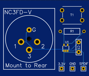

Hi all -- I've been thinking about a simple dam1121 build. This would be straight SPDIF input from either a Bryston BDP-1 (AES/EBU) or an Allo Digione (Coax); single board, single ended analog output.
Before I launch the project -- and potentially get to a point where I'm pulling my hair out trying to troubleshoot -- does the attached diagram reflect a potentially workable approach? The plan would be to get the DAC up and running using the referenced PSUs, with the possibility of upgrading down the line. Part of the interest is that I have the referenced regulators built and on hand.
For the SPDIF input, I was thinking of ordering a PCB that can attach to the back of the XLR jack with the transformer, IC, and passive components on board (mock up attached). Transformer would be the Murata DA102C.
Based on my reading of the manual, the four straps on J2 and J3 should be the correct options. Per post 60 in this thread, EN_AUDIO does not need to be strapped in this configuration.
Thoughts?

You might wanna check this post again 567, concerning the spdif “receiver”

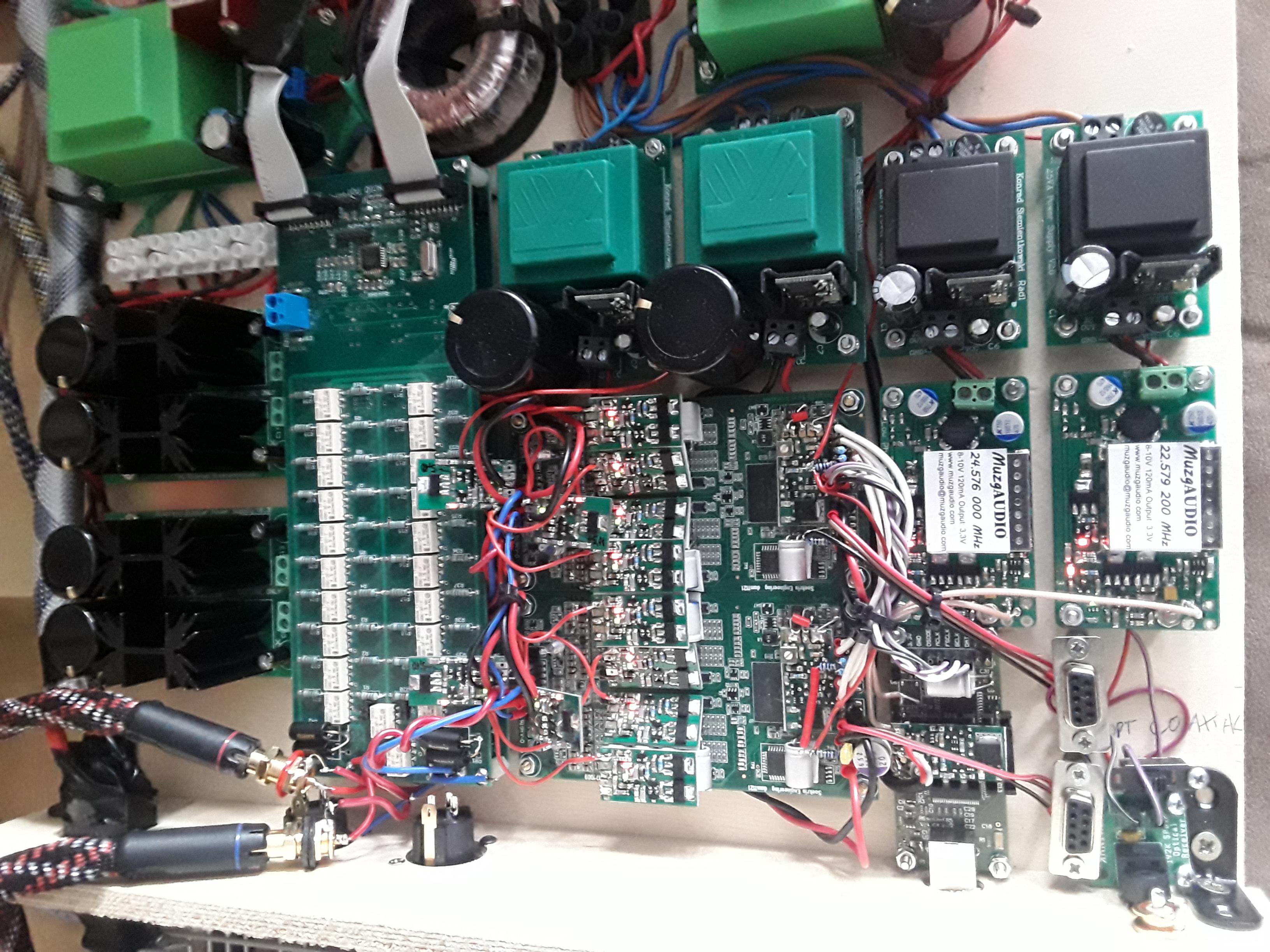

Have any one compared modded dam1021 with modded dam1121? I have build for my friend balanced absolute moded 2x1121 and when i compare with my full batery powered 1021 the 1121 is litle more transpartent but not that fluid like 1021. The difrence was that 1121 plays on usb amanero with very good self powered clocks(better that chrystecs) and 1021 have diyinhk xmos usb with stock clocks.
It have always be possible to connect multiple slaves to one master, with the digital inputs going to the master. That is mainly for doing digital crossovers using the biquads in the multiple dam1121's, or for balanced or parallel operation.
