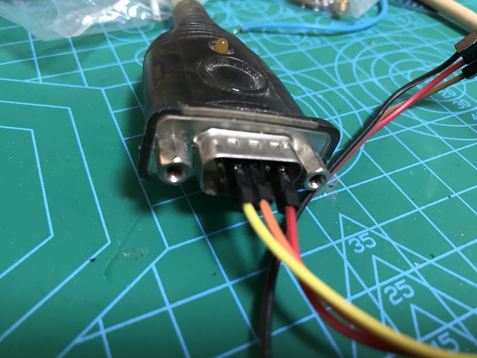

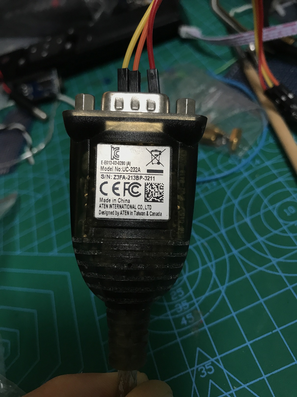

I used this USB to serial cable (Aten UC-232A) which works with dam1021. As I only connect TX, RX and Gnd, I guess it doesn't damage the card yet.
So do I need to add a TTL to RS232 adapter in between?
Why not just buy the right cable, they're around $10....
Thanks. I have done updating. I have several USB serial and USB TTL cards, just I didnt take the TTL to use until another member told me.
Why dont you update the manual to add a word "TTL" to give a hint to people instead? I do a full text search of the dam1121 manual but I can only find the word "serial" but not "ttl".
TTL and RS232 both belongs to serial. TTL and RS232 must be specified. Otherwise people would just need to trial and error.

Actually TTL would be even more wrong.... It is 3.3V levels, just as stated in manual, which you're supposed to read....

Finally I have success using a USB-RS232 adapter to update the firmware to 1.21! Yay.
