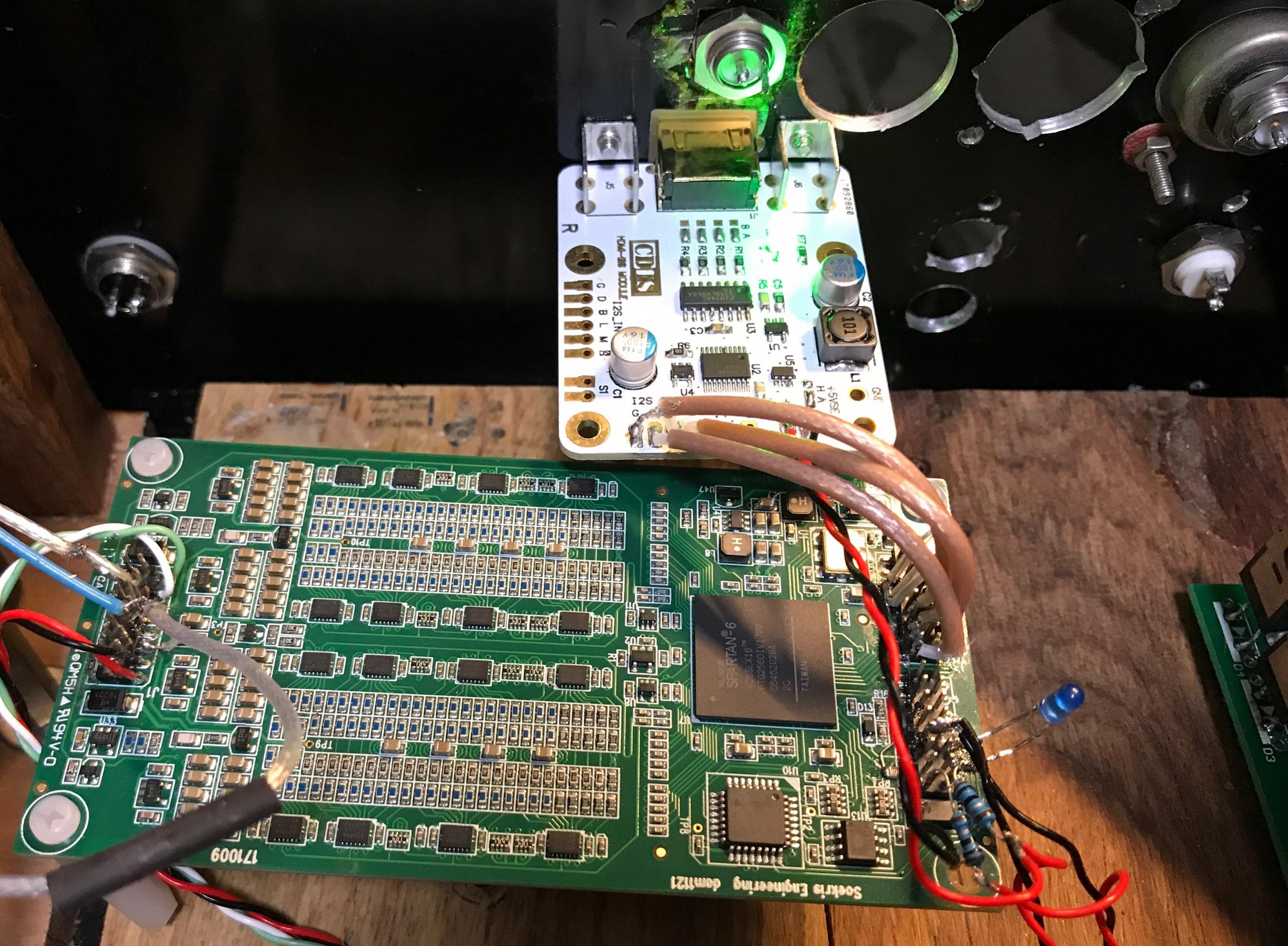

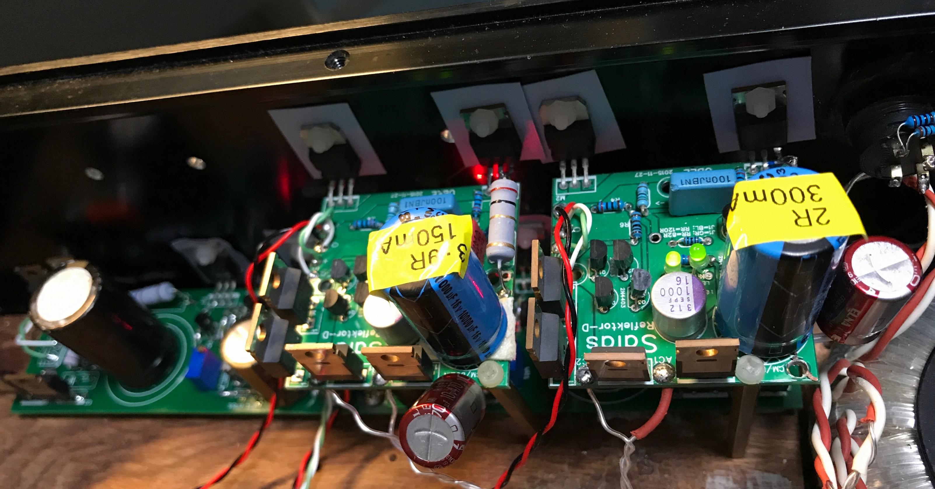

Completed, put my dam1121 into a chassis.
Used four Salas shunt regulators.
a pair of v1.3 for +/- analog 5v
two reflektor-d for two digital 5v
this sounds great event better with tnt's filter, its really up front without sacrificing musical content, for me usually up front normally means lack of definition but not with 1121, been looking for this sound for many years, last time i owned a ref dac was many years ago a technics slp990 which sadly was stolen and never seen again.
Excuse me, do you mean the SQ of dam1121 sounds great?
even better with tnt's filter?
yep this 1121 SQ is what i am talking about and yes better with tnt filter
Have you compared it to other custom filters? I've got Paul's Nyquist filter in at the moment which I'm enjoying.
Another positive vote for TNT's filter. It's not a massive effect, but I'm getting slightly more resolution than the previous filter I was using, one of Paul's Nyquist filters.
