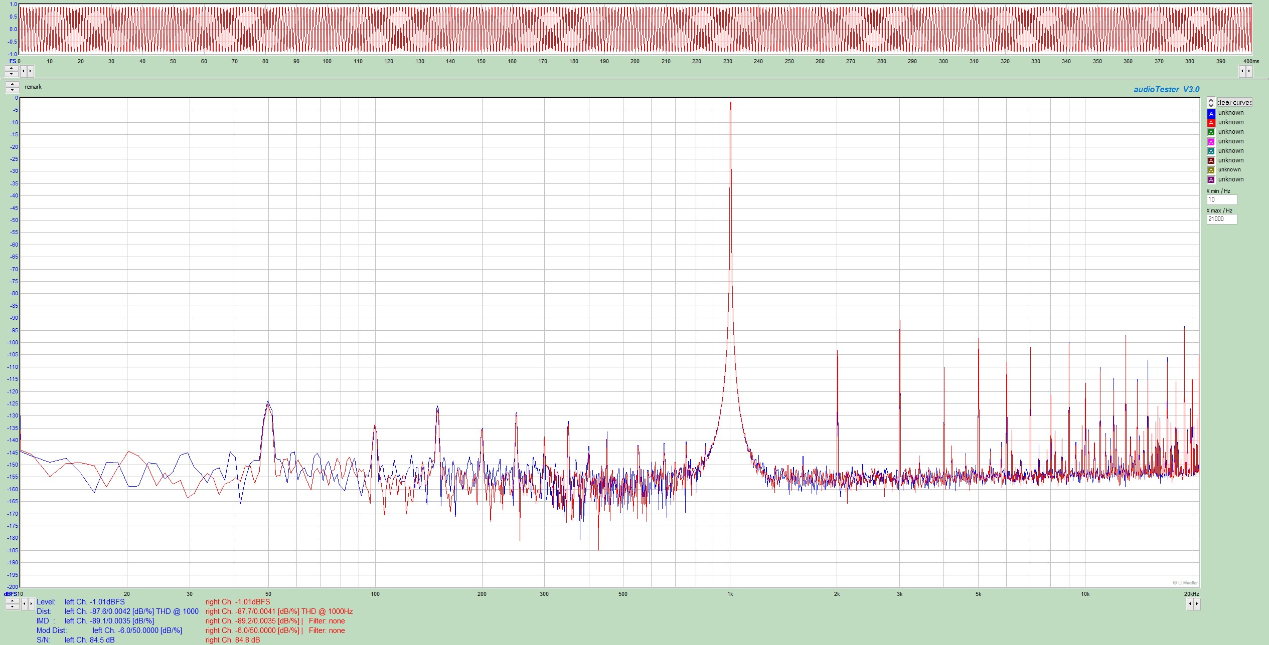

strange distortion!
My 2 1121 balance DAC beta was finished,but I get a strange distortion when I set the PC volume is 0dB and the 1121 volume control set to -3dB .If I set the PC volume to-3dB and the 1121 volume control set to 0dB,the distortion is disappear~😕
Is it looks like the data is overflow after SRC?
