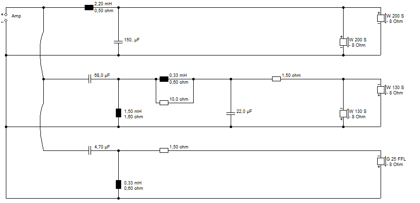

All looks good to me. It's actually a butterworth phase on the MTM section, which is very Joe D'Appolito, and gives good power response.
If you are going to criticise something you should give a reason. Better still, fix the problem. Otherwise it's useless.IMO, not so good (if Boxsim is reference)

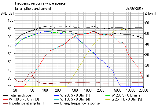

An exaggerated frequency response scale along with an overly detailed resoulution would probably make any speaker look awful. But I really don't see much wrong with this one. I couldn't improve it.
c.f. Troels Gravesen's Classic 3 way: SEAS-3-Way-Classic
Aside from doubling and halving of crossover values to allow for doubled drivers, it's scarcely different. It's a good design.
The Visaton drivers are pressed chassis, but not unlikeable. The G 25 FFL - 8 Ohm is scarcely different from the H0881-06 27TFFC.

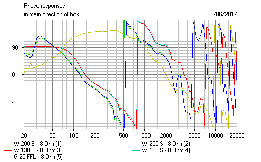

An MTM design always get criticised for lobing, but that to me is a feature. It has a PA like projection and goes loud. The impedance is commendably flat, the phase is nicely 90 degrees, and I don't think a big 100Wpc Rotel amp will struggle with it. A fine design IMO.

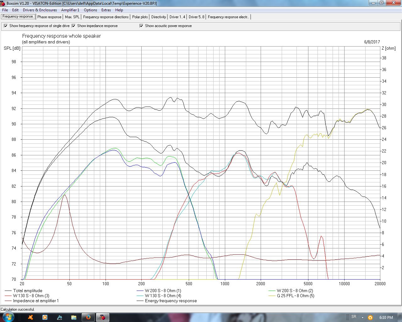

It's just a driver artifact on the W 130 S - 8 Ohm.
A FR peak at 1.3kHz. I had a better time modelling the 4" W100S-8, as it goes. But that won't go as loud. If you were going to hammer this speaker at parties, a 1A fuse on the tweeter circuit would make sense. Might protect the amplifier a bit in case the tweeter blows.
W series seems useless as midrange. SC 13 is much flatter, but lacks excursion. AL 130 has enough excursion, but is quite expensive.It's just a driver artifact on the W 130 S - 8 Ohm.
When placed in room there will be worse drops anyway.>> you should give a reason <<
4,5dB drop from 1,3 kHz to 2,2 kHz ......
But I would expect flatter response from speaker with 5 drivers.
Thank you all for your input. I will certainly assess the midrange when these are up and running.
