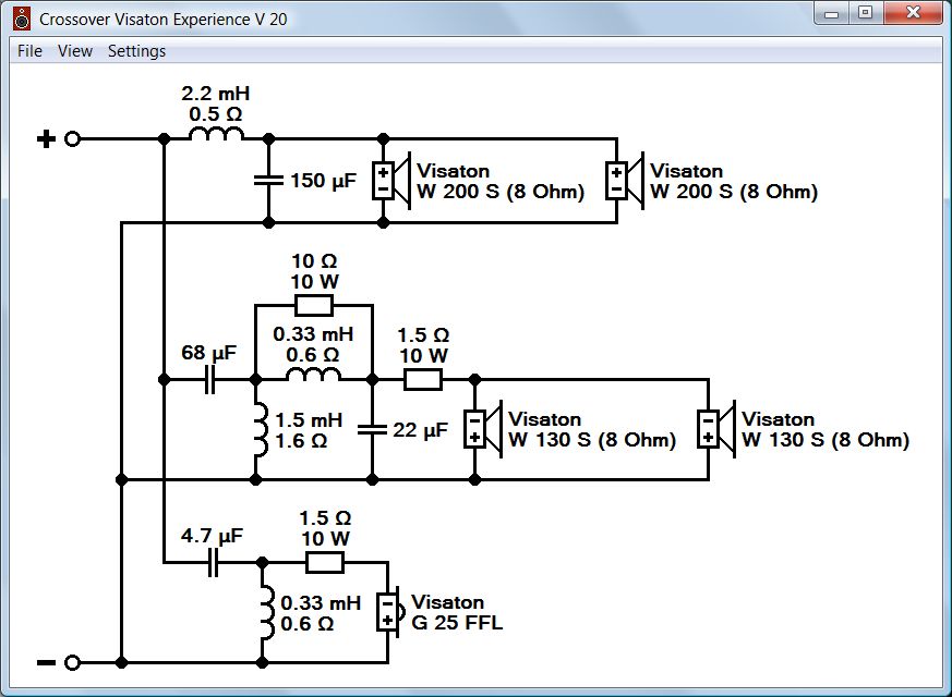

- Both the woofers and midwoofers are wired in parallel. And that leads to the impedance going to about 3 ohms between 100 and 200Hz. Phase is not given but if its negative, that would make things even worse. I hope you have a really tough amp.

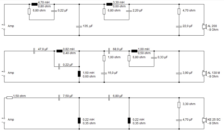

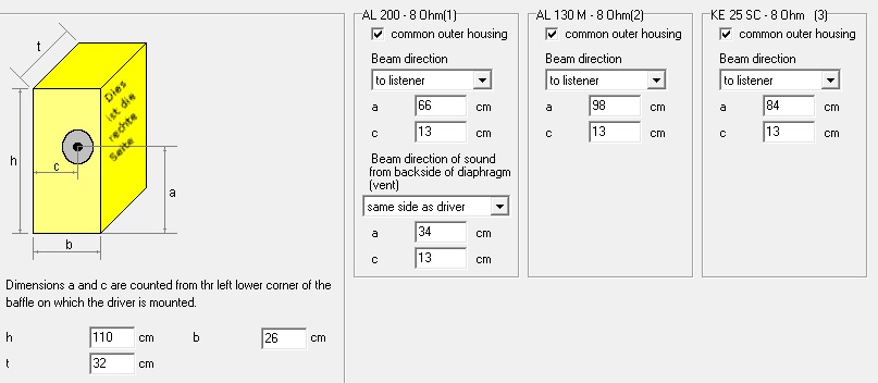

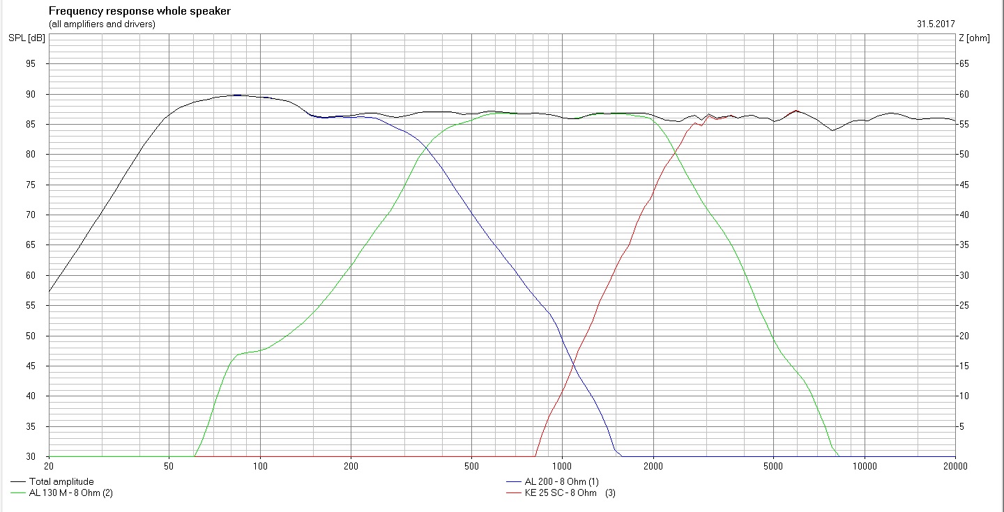

Oh i've forgotten another impressing 3 way with Visaton AL130M and KE25SC and
the Alcone AC10 Woofer..
Or maybe better, full Visaton project..

I am not experienced creating crossovers, but i like speaker wish work with less parts
as possible.

I think you will not be disappointed. An impressive cabinet and great sound for a reasonable price. But you need an amp capable to drive a 3 ohm load. Enjoy! 🙂

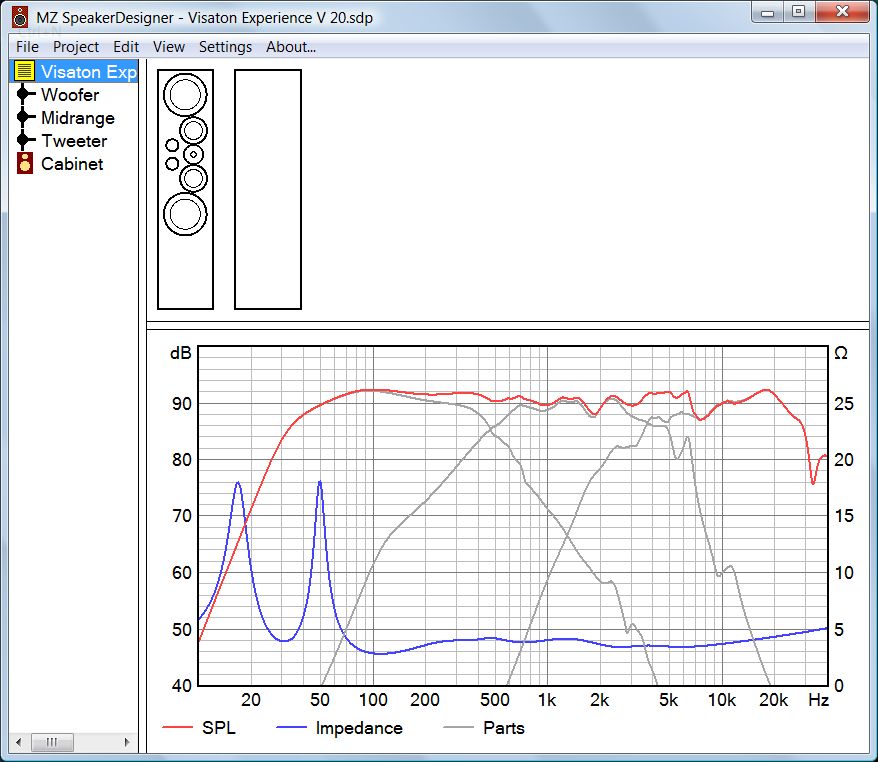

Experience V20 - if placed properly with enough distance to the room boundaries and the listener - is still one of the greatest kits price/performance-wise. This is why it's still around almost 30 years after its introduction. 18mm chipboard will be fine. Probably you have to adapt the plans slightly.
