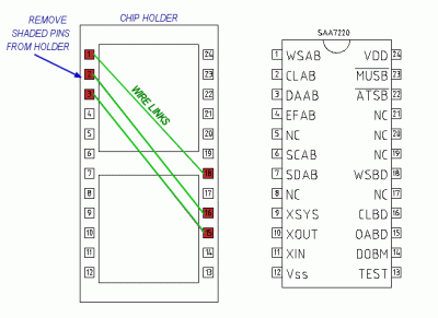

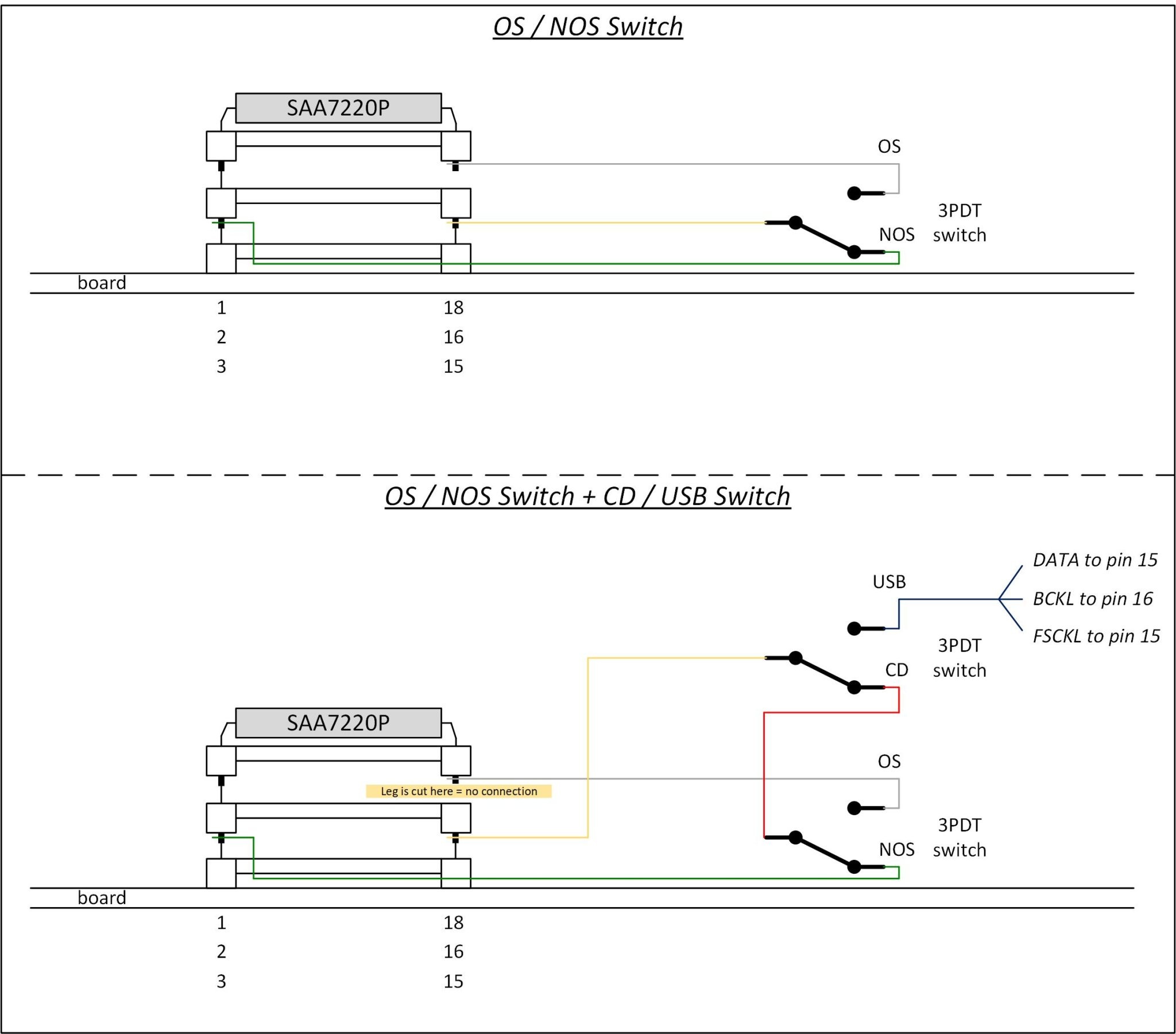

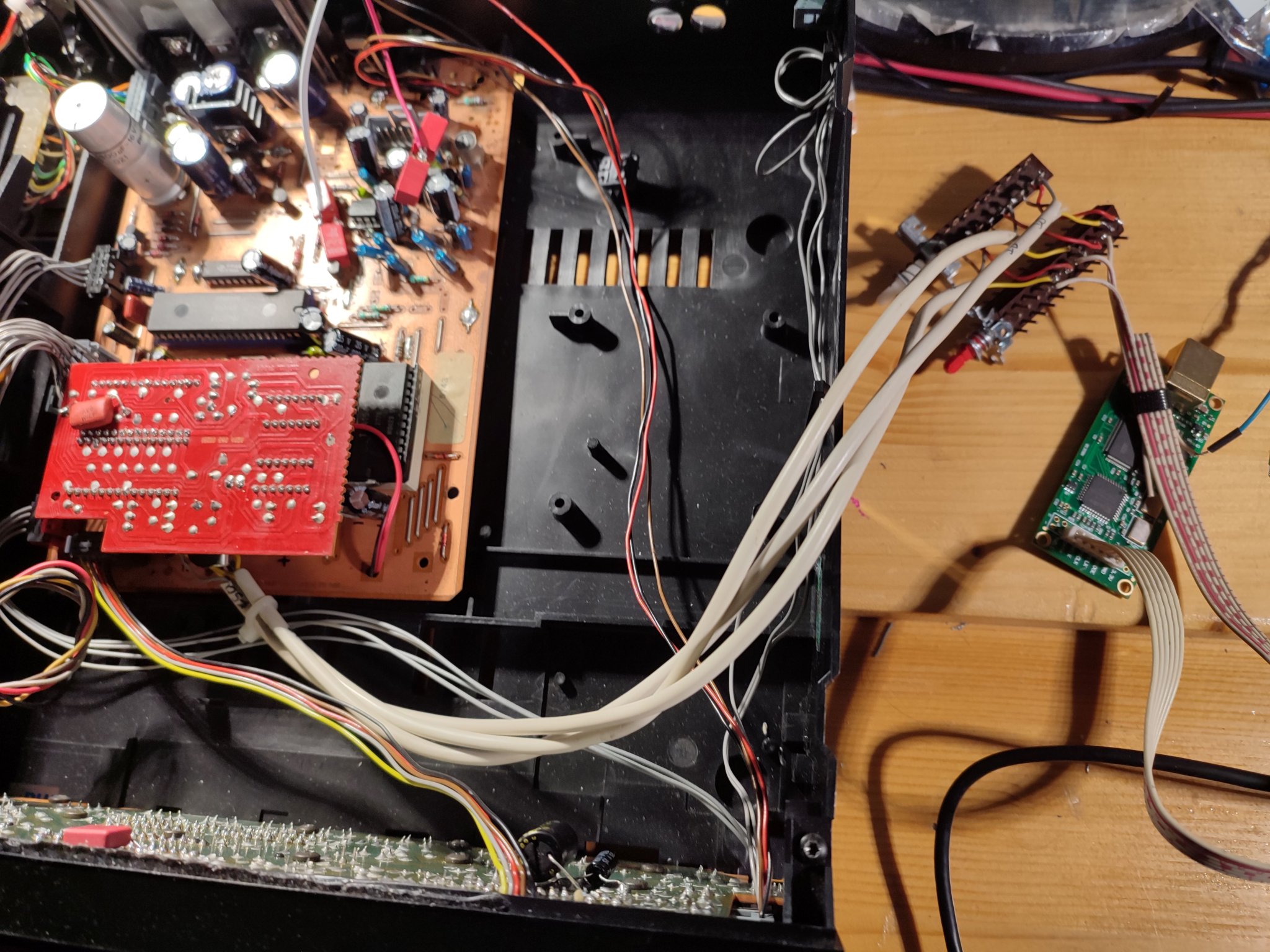

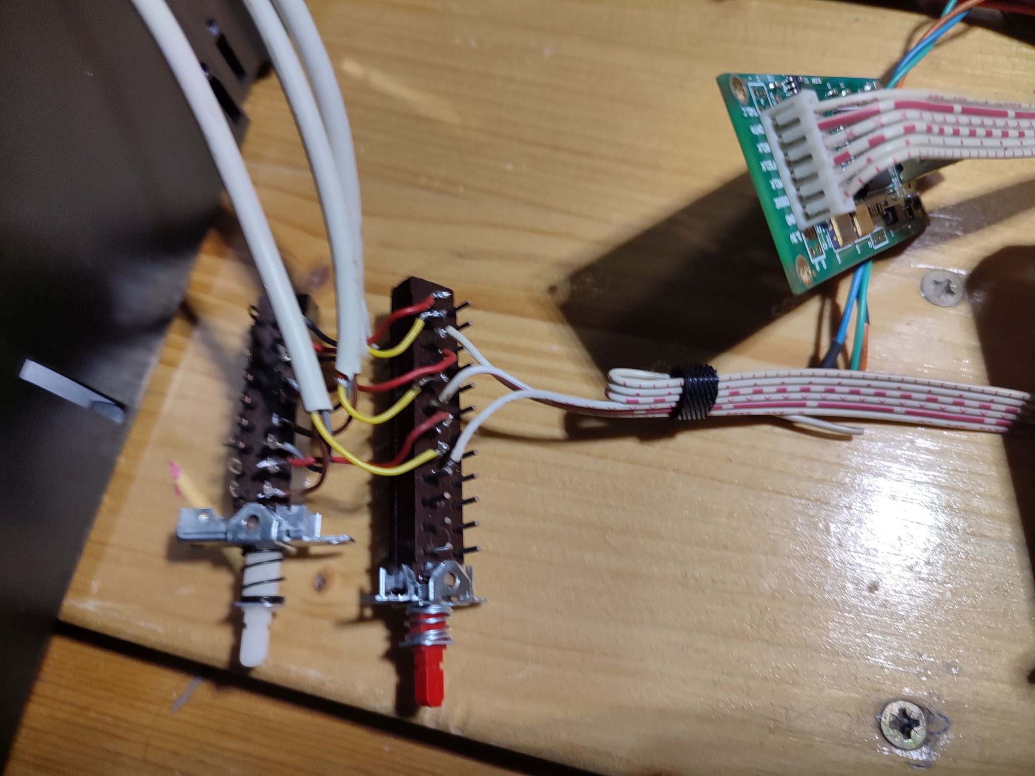

Here are the schematic and pictures... I didn't wanted to cut traces on the board, so I used 2x 24-pin sockets to arrange the connections.
1. First I tried the NOS mode with SAA7220 in place (as the 3 wire bypass from famous SAA7220.gif, attached, doesn't worked - no sound and the CD is spinning continuously) and I was amazed from the new sound from CD. Definitely I will not waste time on putting switch/wiring on this anymore, but I wanted to have a switch for real comparison... both the trebles and bass are shining.
2. Then added the second switch to alternate between the CD (in-built decoder) and USB. Amanero ground is not connected - it doesn't matter - with or without ground connected, there is normal sound when filter is out and there is pink nose with filter inserted.

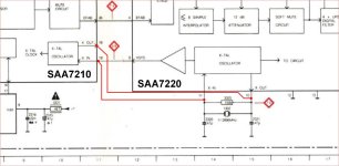

Removing the SAA7220 removes the clock leaving the TDA1541 powered but the CD mechanism uncontrolled hence the spinning and the sound working.
Item 2 above covers the rest.

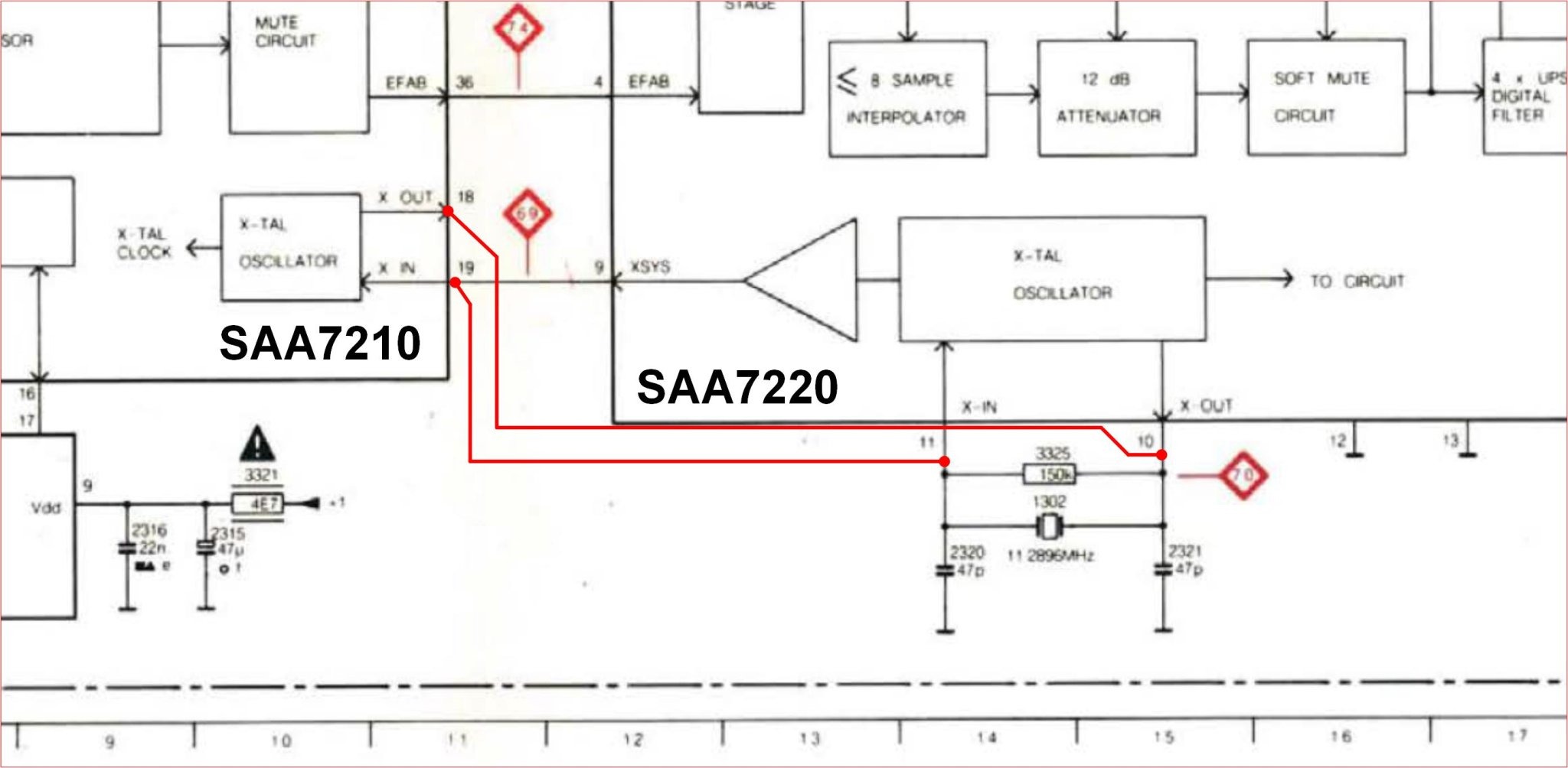

Thanks for this - I decided to check if SAA7210 could work with on-board crystal for SAA7220 and completely get rid of the it...
And encouraged by the other thread for Marantz CD-56 service manual came to the following:
SAA7210 pin 19 must be connected to pin 11 of SAA7220 socked (I actually put bridge between 9 and 11 pins directly in the socked).
SAA7210 pin 18 must be connected to pin 10 of SAA7220 socked - I solder a bridge wire underneath the board.
SAA7220 removed of course and the 3 NOS leads connected as in SAA7220.gif to transfer the DATA from SAA7210 to TDA1541 DAC.
CD receives commands and works properly.

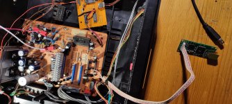

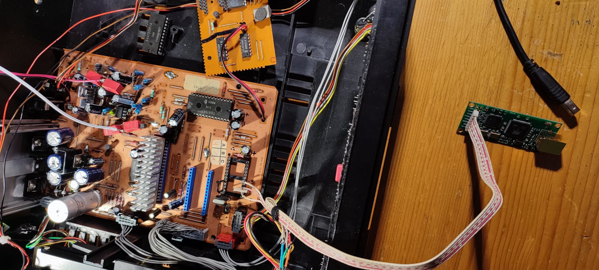

No change in CD / USB switching - when I disconnect the switch and activate the USB there is only noise... so I connected USB directly to the SAA7220 again to check the Amanero settings, but this was not the case - 16bit / 96000Hz works ok. You can see here.
Then I plugged back the socked with the 3 NOS bridges with the switch and solder the Amanero output leads directly to the bridges on TDA1541 inputs 1/2/3 and after switching off the NOS bridges and connecting the USB, the sound appeared! I soldered also the ground lead from Amanero to the board ground as there was a tiny crackling noise...
My guess is that there was induction in the 3x long 3-wire leads between the socked and the switch between the CD and USB signals causing the noise...
So I need to rearrange the switching in different paths - one for SAA7220 socked and one at TDA1514 inputs... will post update with the result.
