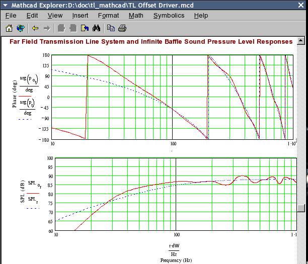

What do you think about this sim?
Line parameters (TL Offset Driver.mcd):
Length: 70 inch
Offset: 18 inch
Driver end: 3.25 x Sd
Open end: 0.9 x Sd
Density: 0.35 Lb/Ft3
hey,
thank you arcturus, your ideas really work 🙂 seems that tapered line works better in that case. 🙂

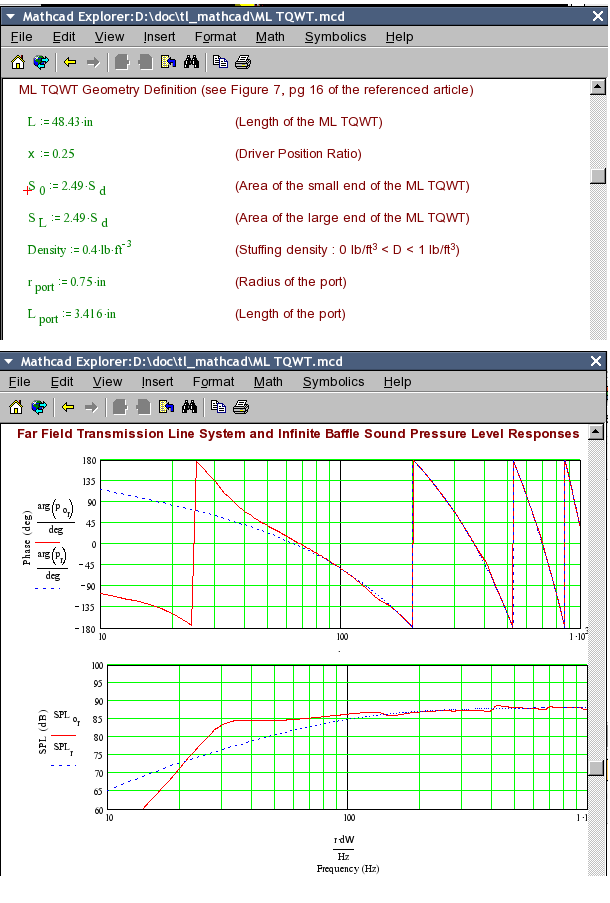

For low Qt drivers, I prefer a well damped vent tuned pipe to get more gain than a 'classic' TL can provide:
L = 48.43"
SO, SL = 366.62"^2
rp = 3.416"
Lp = 0.75"
density = 0.3-0.4 lbs/ft^3 if polyfil
Due to the damping, driver position isn't too critical, so anywhere between ~10.25" - 21.25" down from the top.
GM

I suppose you meant it this way:
SO, SL = 36.662"^2
Port radius = 0,75"
Port length = 3.416"
I ran a sim with these values. Seems like a very good solution... It gives great extension with minimal ripple at high end. Great! 🙂

You supposed wrong. 😉 You did inadvertantly gain some insight into how to easily convert a ML-TL (your sim) into a true TL variant, though the vent is much too small for a low vent mach at rated power and the driver's ideal location will be somewhat lower.
GM
GM:
I didn't realize that your design uses a resistance port (Variovent?) at the TL's open end. Perhaps that's why I got a SPL peak at ~38Hz of about 8dB magnitude in my simulation. (ML-TQWT.mcd)
But don't you think it's quite a big enclosure needed for this?
I've never seen a "restrictive port" used with a TL-enclosure. I've seen that technique used only with sealed enclosures, that's why I didn't understand you at first. I'm sorry :cannotbe:
Greets!
No problem, you made a reasonable assumption based on 'classic' TL design thoughts and the sims. Sure you have! A reverse tapered TL is a restrictive (mass loaded) port alignment, I just kept it simple to build. Add enough stuffing and it's ~aperiodic (aka resistive, Variovent loaded), so to compensate for the damping, more box efficiency is required to boost it back up just as the sim predicts.
GM
