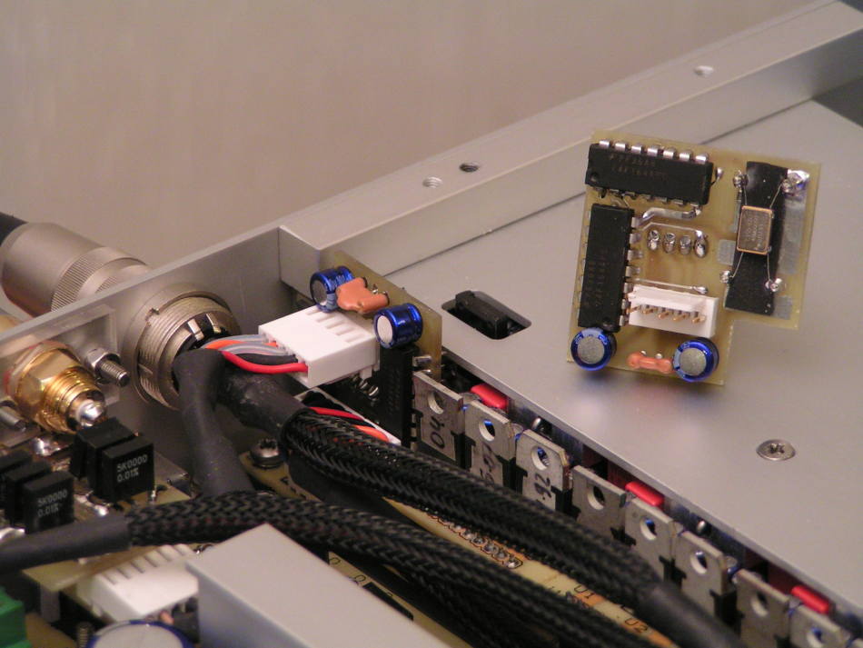

Local reclocker
Hi all,
Finally another update,
This one was initiated by onnosr, telling me he heard slight performance differences between USBDI2S module and SPDIFDI2S module.
This puzzled me a bit since both reclockers used identical reclock circuits, except for the SPDIFDI2S module being connected to a clean 5V power supply.....
The BCK clocking scheme bugged me for some time, I also wasn't happy using multiple reclockers. So I decided it was time to improve this.
This weekend I designed / installed the local reclocker. The reclocker is placed directly on the DI16 / DI8M core PCB to ensure shortest BCK signal path, it reclocks BCK from both USB / PCM2706, and DI2S. It provides an extreme low jitter clock directly at the DAC chip inputs. The existing reclockers on both USBDI2S and SPDIFDI2S modules were removed / bypassed. I put a custom 12 MHz oscillator in the USBDI2S module (74HC161 IC socket) for PCM2706 clock.
The clocking scheme has been simplified / improved:
Old situation:
USB > PCM2706 > reclocker > I2S > DI2S > I2S > I2S interlink > clock buffer > DAC chips
DI2S > I2S > I2S interlink > clock buffer > DAC chips (no reclocking)
note: The DI2S buffers are used to attenuate common interference, and provide I2S source selection.
New situation:
USB > I2S > DI2S > I2S > reclocker > clock buffer > DAC chips
DI2S > I2S > reclocker > clock buffers > DAC chips
Note: both digital audio sources are now reclocked. The reclocker can now run on an external clean power supply (no longer connected to USB power supply).
The photograph shows the local reclocker in my DI 8M reference DAC, another reclocker is placed on the heatsink for a better view. This reclocker can also be used with the DI 16.
Measurements:
The oscillograms taken directly from the TDA1541A chip BCK inputs show very clean rasor-sharp transients, now it's no longer possible to measure the jitter with my oscilloscope, even after minimum brightness setting and focus fine-adjust.
First impressions:
The improvement is immediately audible, no direct comparisons necessary for this mod. The sound-stage is wider, sound is smoother, cleaner and more detailed than before. Even at low volume settings the sound quality is exceptionally clear and detailed.

Ringing could be reduced by significantly increasing both bandwidth and sample rate, this however isn't very practical for the reasons I already indicated.
The whole timing and clocking issue results in 7 or 15 linear interpolated samples placed between the existing samples in real-time, (Direct Interpolation).
This increases both time resolution (from 44.1 KHz to 352.8 or 706.5 KHz), and amplitude resolution (from 16 bits to 19 or 20 bits, however this depends on tolerances).
In the process it also acts as a linear filter, effectively attenuating higher harmonics, but since it's no brickwall filter, intermodulations with fs still occur, as fs is too close to the audio range. However, higher harmonics are effectively attenuated. This is the reason why I can leave-out the analogue filter, similar to the Trinity DAC.
Because I use multiple DAC chips, each chip has to process less higher harmonics, as it runs at fs (NOS mode), and part of the interpolation takes place in the analogue domain as well.
