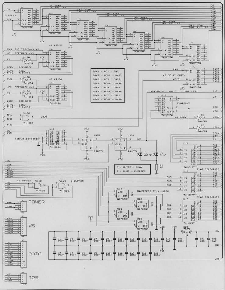

dual format timing chain schematics
Hi tubee,
Thanks for your encouraging words [post#860]
Yes, combining all these activities is very hard work, I actually did listen to the octal D-I DAC all day, testing the USB to I2S interface. I am very gratefull for the support I get from diyAudio members.
So let's get on with the project. I have been optimizing the USB to I2S interface lately, especially the reclock circuit. Asynchronous reclocking usually takes 2 clock cycles of the reclock source (48 MHz with the USB interface). One to lock the positive going edge, one to lock the negative going edge (2 D flipflops in cascade). I only used one D flipflop for the positive going edge of BCK and a digital (crystal controlled) one shot circuit to overrule / lock the negative going edge. So the circuit acts like being reclocked at 96 MHz, the time between the rising and falling edge of the reclocked BCK is now fixed. Next I am planning to go even further by locking on both positive and negative going edge of the reclock signal, whichever comes first locks the positive going edge of BCK. This would compare to a reclock frequency of 192 MHz.
I also added a schematic diagram of the autodetecting dual format timing chain, since I haven't posted it yet.
This circuit accepts both philips and sony format signals. So the I2S interface that is now standard for the octal D-I DAC can be used for both.
Shift registers U1...U7 generate the necessary DATA delays for both formats D6...D56. U8 is used as synchronous divide by 6 or 8 register during the positive half of WS, U9 is used as synchronous divide by 6 or 8 register during the negative half of WS. This is necessary in order to maintain perfect synchronization with both BCK and WS. Taps are provided for philips and sony format WS delays. Both U8 and U9 provide the synchronized clock signal for the actual WS shift register U10. So basically the WS delay circuit only needs 3 shiftregisters. The different tap settings for each format are necessary to maintain equal delays between interpolated samples.
U11 is the format converter, it delays WS 7 BCK pulses and inverts it in order to accept the sony format. The format converter is bypassed when the philips format is detected.
U12 and U13 are used for actual format detection. Detection is obtained by strobing unique patterns derived from counter U12. The blue LED lights when philips format is detected, The white LED lights when sony format is detected.
U14...16 are multiplexers (digital switches) that select all necessary signals according to the received format.
U19...U22 are inverters used to obtain ND2, ND4, ND6 and ND8.
