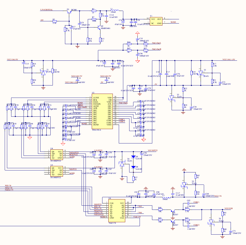

With the AMR CD-77 I used CMOS to PECL "translator" IC's (MC100EPT20) with a TL431 based supply that had a diode as additional temperature compensation, to undo the temperature compensation build into the IC (TDA1541 is not temperature compensated).

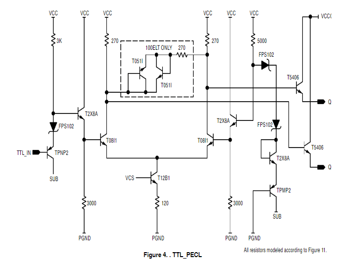

For illustration, here more or less the insides of one of these CMOS to PECL translator IC's:
The outputs are basically differential Emitter followers.
Here the full TDA1541 schematic from the CD-77, it's long discontinued:
It includes the DEM reclocking per HTP. Each TL431 shunt is fed from a CCS which is off board.

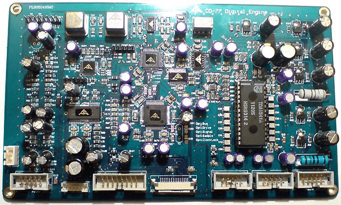

And this is what it looks like on a PCB:
On the left hand side are all the CD drive electronics,
Thor

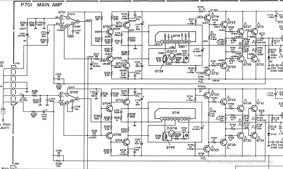

Thorsten, the PM-75 looks interesting.
(Looks like a high OLG design, it's a composite amp with 5534 opamps).

Yes, the interesting point is the bias ic.
I got OPA828 to replace the OPA and I think I will reduce the loop gain a bit (lower loading resistors on 2nd VAS).
But the DAC is the killer part. Have a look.
Thor
I did take a look at it, yamaha dir, saa7220 filter, quite complex secondary pll (not easy to figure out).
What about the analog section after the dac, are you still using all those opamps? Opamp I/V, and apparently a high order low pass filter with GIC cells (opamps). And a servo, to source a part of the bias current of the tda1541 and keep the opamps more or less centered (but the final output is cap coupled).
