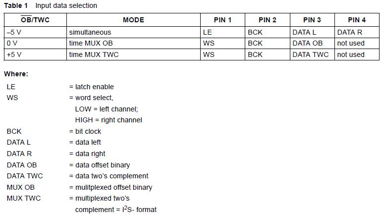

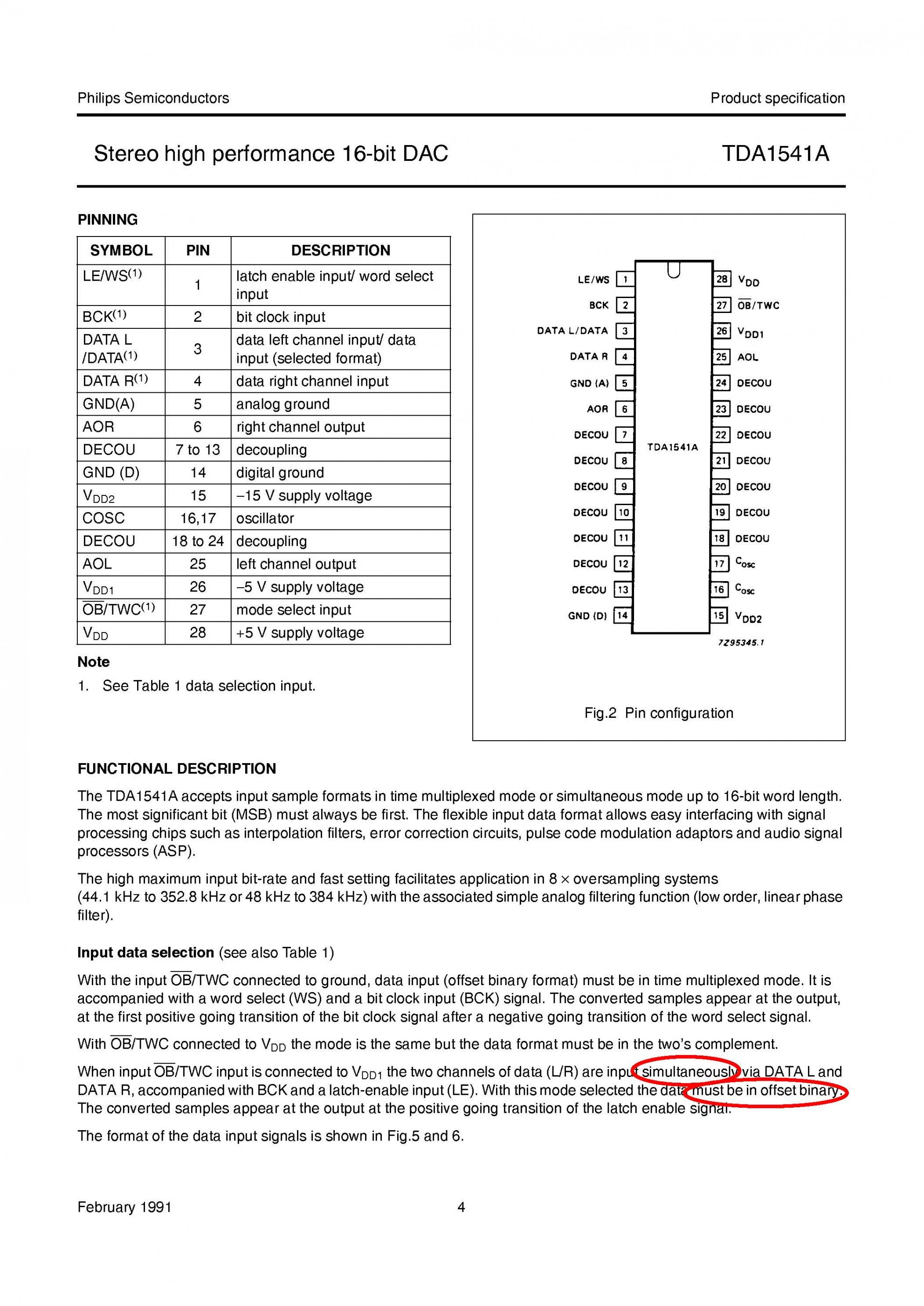

The TDA1541 (A) chip accepts input data in only two formats: OB or TWC. In both formats, the MSB is interpreted as a signed bit.
Actually there are three formats: simultaneous, time MUX OB and time MUX TWC.
In the PCM1704 chip, the conversion of numbers to the desired format is done inside the chip, and as a result, each of the two internal DACs operates in a dedicated 23-bit segment. Two 23-bit DACs, each working in its 23-bit segment, result in a single 24-bit DAC.
The size of each segment for the TDA1541 pair is 15 bits, since it is impossible to transfer a 16-bit natural number inside the TDA1541 (A) chip, only 15-bit. One bit (MSB) is inevitably spent on the sign of a number. Two DACs, each working on its own 15-bit segment, will result in a single 16-bit DAC.

I use a decoder that formats two different data streams, one for each segment. I use TDA1541A simultaneous interface, pin 27 tied to -5V.
