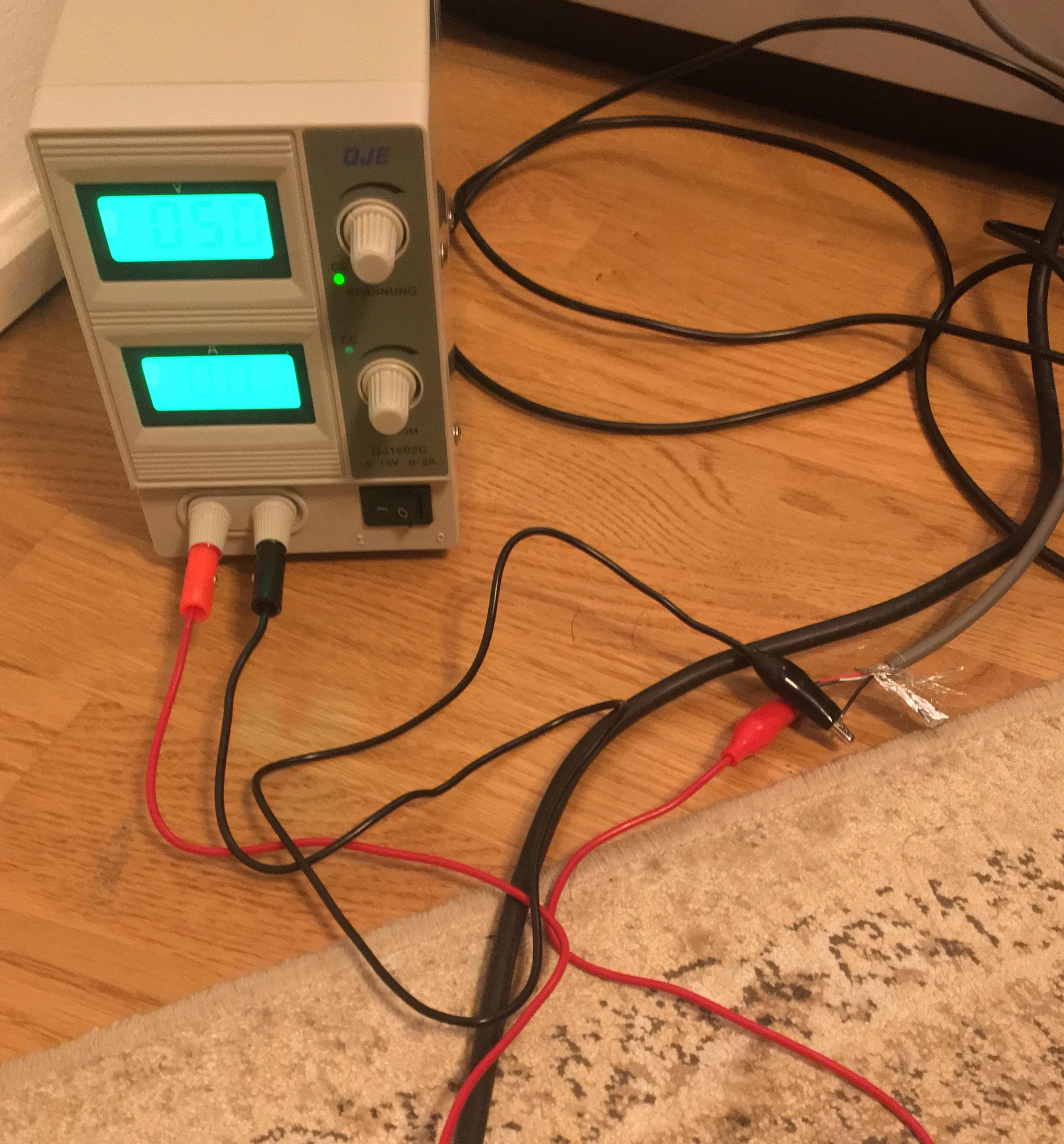

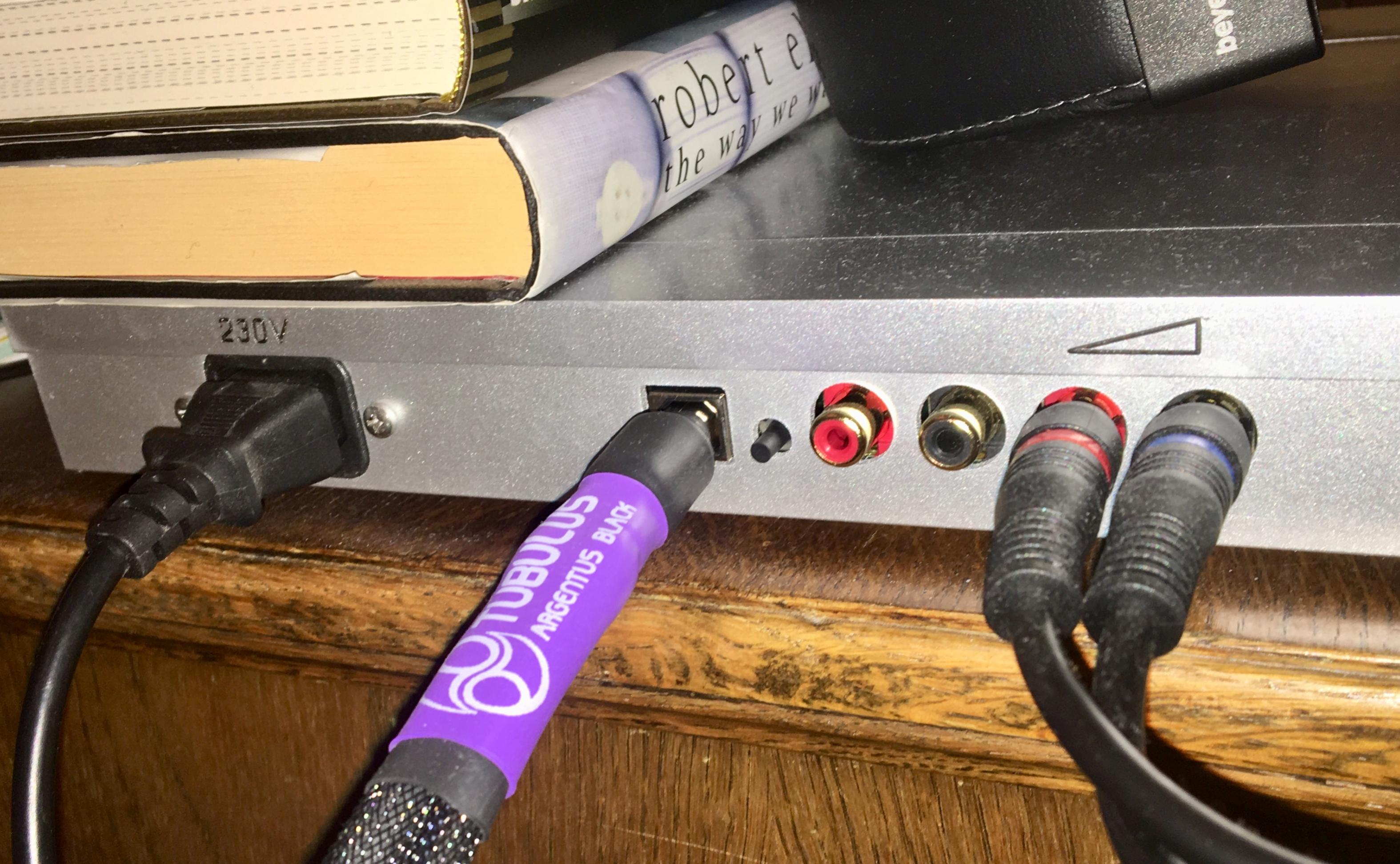

Can I please share a quick summary of my humble findings regarding the USB power supply topic:

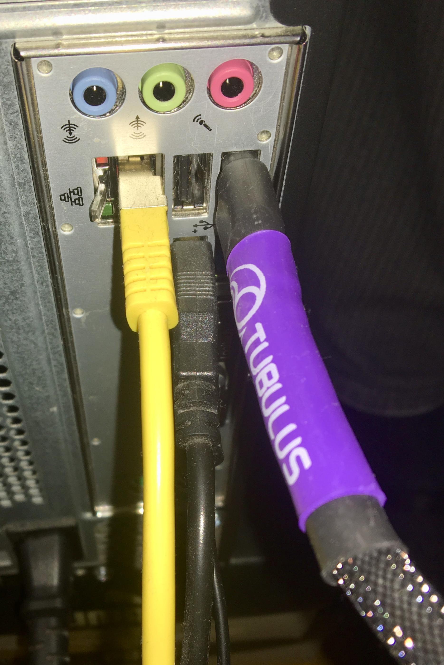

At the moment, I'm still running my Mosaic UV from my PC (with Foobar and Kernel Streaming, works fine) until I have found the most suitable setting for the Mosaic, then I will look into the Raspberry et al. music server side. At first it was not trivial to find an USB port that would actually provide bit perfect playback, some did seemingly work but produced clicks and dropouts as well as no 'bit perfect' green light at any time, but then with two USB ports it worked fine.

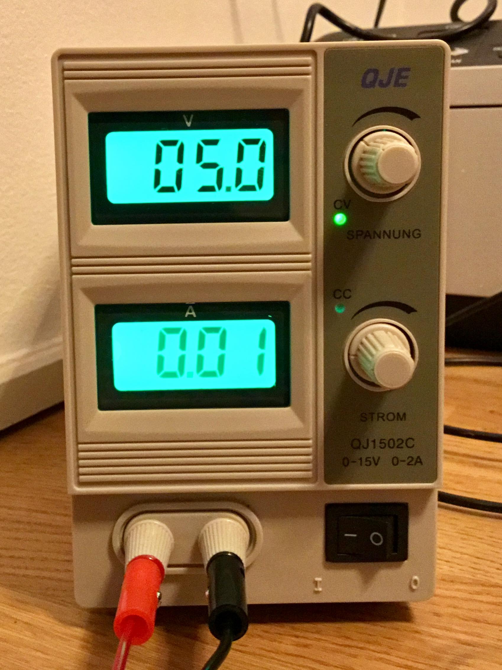

As said above, I had then purchased the TUBULUS ARGENTUS USB CABLE V2 DUAL HEAD. Only one of these two USB ports on my computer let me use the data from this port and the power from another - still with bit perfect results, but interestingly the green light went on substantially quicker! I can only guess that the reason for this is less crap on the signal lines, but have no evidence. Although I don't trust subjective observations, I still found sound reproduction quite more detailed, bass a bit deeper and clearer, soundstage more precise, but as said this is all subjective, no measurements or 'correct' A/B testing done.
Now I have connected the Power cable of the Dual Tubulus to my lab power supply to provide clean, mass and potential separated USB power to the Mosaic as signal for host detection - see pictures. Works flawlessly. This way I think we can eliminate the above discussed detrimental USB power issues and their effect on the USB signal (which itself of course is still covered in a lot of crap and dirt as it comes from the PC, but already music reproduction is brilliant). I don't think I will bother to experiment with battery or so but just leave it that way for the moment. Because next up is powerline conditioning for the Mosaic.

I see the USB plug of the Mosaic is touching the cabinet : does it make a ground loop with the Earth wire of the supply IEC cable of the Mosaic ? Or it doesn't matter cause it's not on the analog signal outputt ?

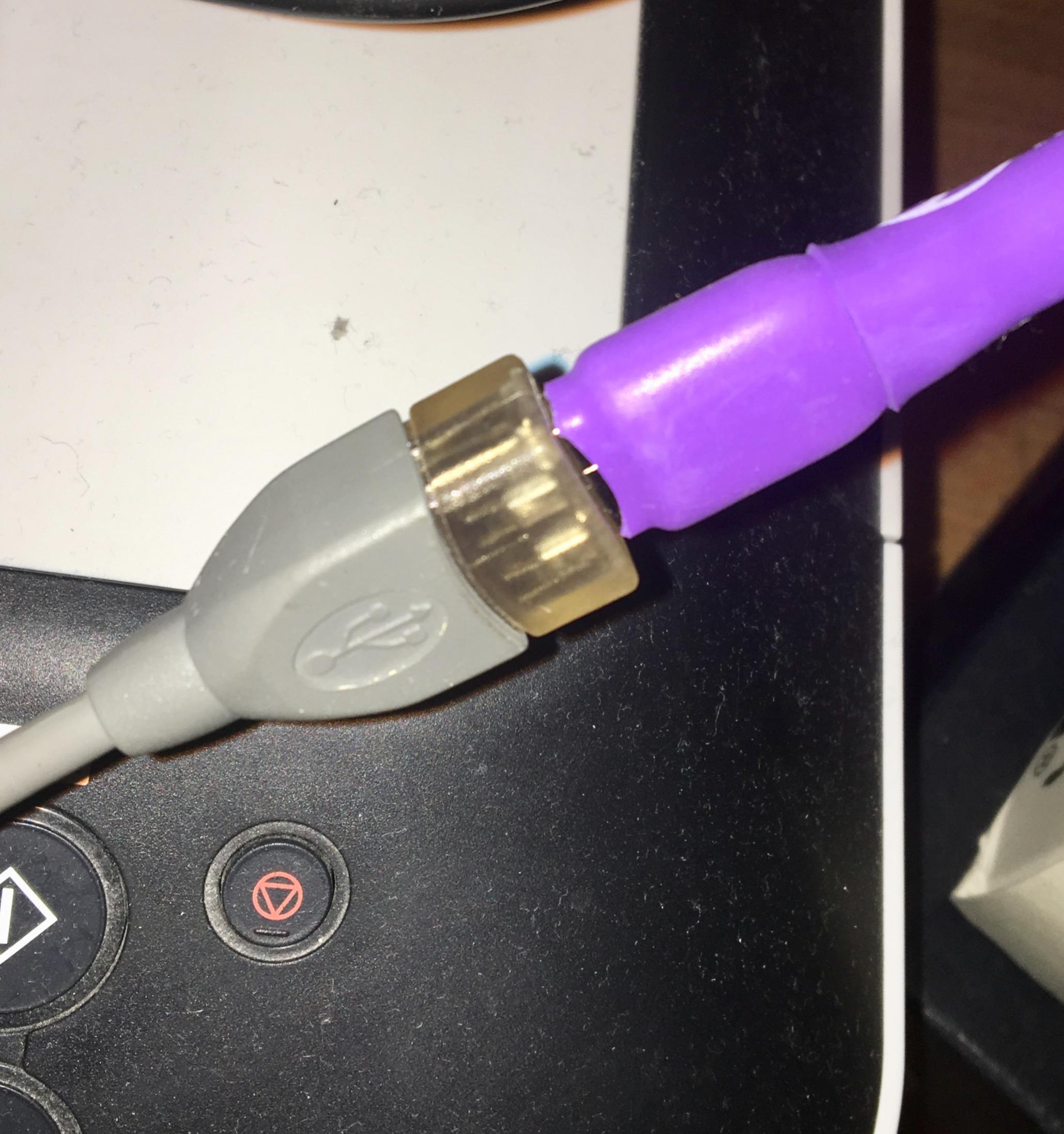

No, I didn't do these experiments or modifications (yet).
- I use the Tubulus cable as it is (75 cm version), with metal plugs on all ends.
- From my understanding, the shielding on the USB data cable is connected to the Mosaic case on the receiving end and to the PC case on the host end, as it should be.
- The shielding on the USB power cable is only connected to the Mosaic case on the receiving end, it's cut open on the other end and I don't know really if and where to connect it to - the case of the lab power supply probably isn't a good idea (as its output is decoupled from mains anyway), maybe mains GND/Earth, I don't know. As long as the shield is not connected on one side, I'm likely creating an antenna (it would probably be better if this part of the Dual Cable, the USB power cable, wasn't shielded?), but not sure if it matters too much - on one hand there's not really any current flowing, as you can see from the power supply's display, just the voltage potential required for sensing the host, on the other hand John explained above that an opto-coupler is being used for this in the Mosaic, so for the time being I would guess that closing this shielding wouldn't matter too much, but I can be wrong of course.
Can't edit anymore, so addendum:
It just occurs to me that the shielding for the USB data cable part of the Tubulus Double Head cable is of course physically connected with the shielding of the USB power cable part through the USB B plug... So whatever detrimental effect I cause on one shielding will also be present on the other - which means I do have to care 🙄
Will need to decide whether to use no shielding at all on the USB power cable part, or leave the shielding in place and connect to Mains Earth near the lab power supply.

When I said "as it should be", I was mentioning the USB data cable - as this has metal plugs on both ends, the USB A plug connects to the computer and the USB B plug connecting to the Mosaic, that's how USB cables typically interlink when they are both mains powered (so not one being USB powered by the host), as is the case here with PC and Mosaic. That's how I also read the material in the links you have provided. So in order for the shielding to work properly in my case, both ends are connected with the respective cases of PC and Mosaic, "as it should be" 🙂 Both cases are grounded to mains earth via their EU mains connector plugs.
It's exactly the other way round: the USB data cable has an end-to-end shielding as described above, the USB power cable which I have connected to my lab power supply doesn't, the shielding is open at the end of the power supply but connected to the case at the Mosaic through the USB B plug. And the negative return wire isn't ground, -V and +V are just a potential difference which the Mosaic sees to sense the host. -V is not connected to GND or mains earth at the end of the lab power supply, as it is "floating". I'll leave the shiled open at that end for the time being I think.
