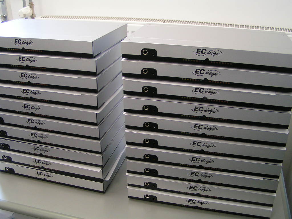

You might like following picture.
Great! We expect the invoices soon, then.
Maybe I'll get my Mosaic before my birthday, with chance 😀
M.
Hi paul_peraic,
Hello john
Yes it is good to see .
Will they be ready soon ?
Kind regards Paul
