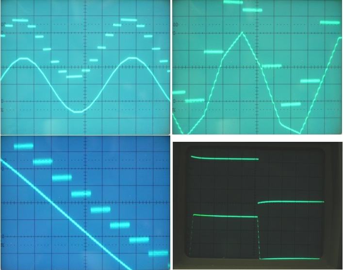

One possible way to synchronize the DEM oscillator with WS is the following:
1.8nF 1% film or NPO cap between pins 16 and 17 (DEM oscillator runs on timing cap).
330nF film cap in series with 22K between WS and pin 16 (synchronization circuit).
Filter cap value (14x) 1uF.
Buffer is not required.
Has anyone implemented the above designs? I have now implemented it and overall it sounds very good. However, I did notice a very slight digital distortion on very low level signal (amplified of course by subsequent stages).
The distortion is much much less than the distortion there is when there is no DEM lock. Can the ones who have implemented this have a really good listen?

I changed from BCK>WS synchronisation for DEM on the way ECdesigns suggested. My listening experience is that there seems a little improvement in black background and less distortion. On the other hand it keeps on my mind that the timbres of instruments sounds less 'real' then with WS sync. I should make a switch to figure this out...
I use a free running DEM oscillator with timing cap. I reduced capacitor value so it oscillates around 3 MHz, it is then synchronized -not triggered- with the bit clock BCK (2.8224 MHz). So DEM clock jitter basically remains similar to a correctly functioning free running DEM oscillator. In order to meet 1% frequency stability, the DEM clock should not fluctuate more than 28 KHz or 35us peak to peak jitter. In practice it is no problem to achieve much lower values, this means I fully meet the conditions to stay well below 0.25 LSB error.

The input resolution remains 16 bits, the time resolution is increased (88.2 KHz sample rate with 2 chips, 176.4 KHz with 4 chips, 352.8 KHz with 8 chips). The extra samples are derived using linear interpolation (delay and add scheme).
Output bit resolution is theoretically increased to 17 bits (2 chips), 18 bits (4 chips) or 19 bits (8 chips). In practice the output resolution is limited by DAC chip bit errors and matching between DAC chips.
The result is a smoother output signal (oscillograms at the beginning of this thread) when using NOS. This in turn improves performance when using (pre) amplifiers and interlinks that were designed for use with analogue audio sources.
Linear interpolation causes trebles roll-off in combination with NOS. The wave form starts to resemble triangle wave shape at increasing frequency when fewer samples are available for reconstruction.
However it works fine when applied after digital filtering. This technique is applied in the Cambridge CD3 CD player in order to achieve 16 times oversampling using 4 x TDA1541A.

Hi,-ecdesigns-
Thank you for fast reply.
Output analog signal can't have more information than had the input digital signal. Even theoretically.
The practical resolution 1541 not more than 15 bits. At the best you may obtain resolution 16 bits.
This as law of the conservation
of energy.

Hi SSerg,
I mentioned this:
I didn't mention that we get more information out than we put in. I just mentioned that the output sample rate can be increased to 88.2, 176.4, or 352.8 KHz and that the output bit resolution can be theoretically increased to 17, 18, or 19 bits.
The gained output resolution is used for smoothing the NOS DAC output signal.
I attached some oscillograms. Upper traces show plain NOS DAC output signals, lower traces the same signal but now with 8 times linear interpolation (8 * TDA1541A). These show the desired smoothing effect.
