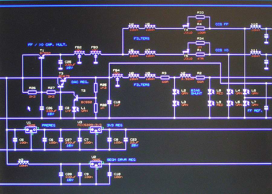

Yes and no, I can use both, as the SD-player runs both on a mains adapter or battery power supply.
I attached part of the SD-player schematics that shows the power supply.
The DC voltage enters a discrete low-noise LED-referenced series regulator with integrated capacitance multiplier built around L1, T2, and T3. This series regulator concept also works very well for TDA1541A power supplies (+5V, -5V, and -15V)
It then feeds LED shunt regulator (L2 and L3) through a passive filter. The voltage of this shunt regulator is then filtered again and drives a second LED shunt regulator (L8 and L9). The voltage on the anode of L8 is then used as 3.3V reference voltage. I left out decoupling caps as these color the sound.
Both master clock and high-speed synchronous reclocker are powered using a capacitance multiplier (T1), filters, constant current sources (T4 and T5), followed by some more filters, then driving a 4V LED shunt regulator. Both constant current source and LED shunt regulator form a constant power regulator.
The LM326 is unsuitable for use as external reference voltage as output noise is too high, and it's very difficult to keep integrated circuits of this complexity under control (stability), resulting in sound coloring / degradation.

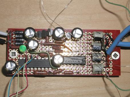

Here are the schematics of +5V, -5V and -15V LED-referenced series regulators with integrated capacitance multiplier for the TDA1541A. Exact output voltage can be set with R3, R8, and R12 (higher value increases output voltage, lower value decreases it).
The circuit works as follows (using +5V schematic as reference):
R1 and C1 form a low-pass filter that attenuates ripple voltage. R2 feeds the cleaned-up DC voltage to Darlington T1, driving it into saturation. C2 provides frequency compensation.
The output voltage is divided by R3 and R4, and connected to the base of T2. T2 emitter is connected to a green LED (approx. 2V).
As soon as the voltage across R4 exceeds 2V + 0.6V (V-BE), T2 starts conducting, reducing the current flow through T1. This way the regulator settles around the required output voltage.
If R4 was removed from the circuit, output voltage would settle around V LED (2V) + V-BE (0.6V) = 2.6V.
The circuit responds very fast (minimum delays), and noise levels are low enough for audio applications.
The LED could be replaced by suitable low-noise zener diodes, but do carefully check effects on sound quality.
Keep in mind that the noise produced by the reference diode is amplified by the attenuation factor of the voltage divider. With the 5V regulator, the LED noise is amplified approx. 1.9 times.
With the -15V regulator LED noise is amplified by approx. 2.7 times.
So try to find an optimum between reference diode noise and voltage divider properties.
The voltage drop across LEDs with different color are slightly different:
Current = 20mA.
Infra-Red LED, approx. 1.3V
Red / Orange LED, approx. 1.9V
Yellow LED, approx. 2V
Green LED, approx. 2.1V
Use plain LEDs (no low current LEDs) for lowest noise. Don't use blue or white LEDs.
I used green LEDs for these voltage regulators as they provide highest voltage drop (2V).

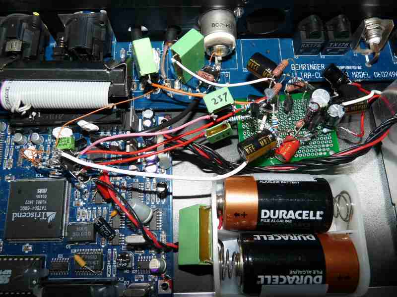

Hi, I used 2 D cell batteries for the 3V ref. I kept the dac on for a long time and the voltage now drops to 2.89V.
I used 750R for I/V and I measure the I/V output voltage to be 2.06.
The tda1543 Vdd is 5.5V
I just wonder if a lower value I/V resistor would be better.
BTW, thanks EC.
The tda1543 /w EC tweak and 2sk170 output stage mate with the deq2496 sounds shockingly good. Much better my other non-os 1543 dac and a tda1541 dac I once had.
I believe the dsp in the deq2496 has already done some filtering to the digital signal so I am not sure if this dac is non-os.
Also, the output stage is extremely important, just passive I/V is not enough. Adding the 2sk170 output stage with 2+ gain really improve the overall sound.
FYC said:
Thanks EC for the answer and the effort to plot the oscilloscope out, yes it is clear that your signal swing somewhere between 1.8V and 3.5V.
However, I would rather do the calculation the other way round:
I think you are biasing the load resistor to about 3.3-3.5V? The way you mount this R to the DAC, coupled to the fact that the power supply at 3.3-3.5V can only source current, create a ceiling for the MAX voltage that can be output by the DAC --> hence the 3.5V in your signal chart. With 23mA flowing thru 680R, you got a voltage swing of 1.56Vpp, so the MIN voltage will be just about 1.8-2V, also fall inline with your signal chart.
I think if we just put 2 alkaline batteries in series to give a 3V bias, the R load cannot exceed 520 ohm (1.2V/23mA) in order to stay within the DC compliance range. If using the LED voltage regulator you mentioned, then with 3.3-3.5V, your 680R works perfectly. This is the best you can get out with a 5V power supply. If we push up the VDD to 6V, this will allow us to use 3 alkaline batteries in series at 4.5V (1.5V below VDD conforming to DC compliance), and a possible swing of 2.7Vpp (4.5 - 1.8) with a load resistor about 1.2k Ohm.
I wil try to experiement with this. And again, thanks for this innovative idea.

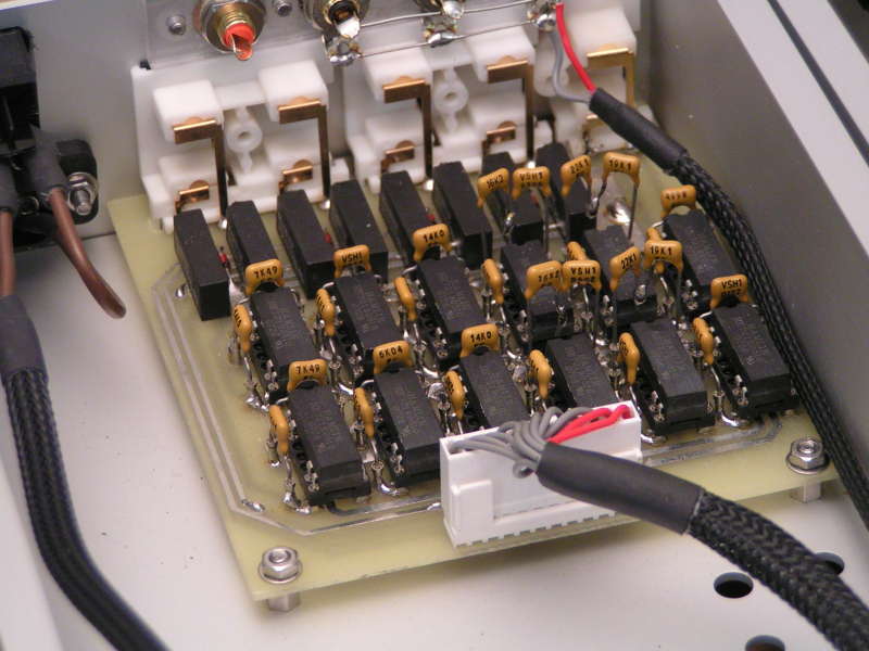

Hi 2A3SET,
It's far more better than regular pot, and some people even prefer it over TVC.
I did built several versions of these lightspeed pots, mainly using matched LED / LDR couplers from Farnell (black cylindrical housing with 2 wires on each side), bought 50 or so for matching.
I also tested home made LED / LDR couplers, even with multiple LDR's and LEDs and experimented with different LED colors (LDR spectral sensitivity).
Although the lightspeed volume control didn't sound bad, closer examination exposed non-linear characteristic (LDR) that couldn't be corrected. I would feed in a linear saw tooth signal, and I would get out a distorted non-linear sawtooth signal.
This non-linear distortion may add some nice touch to the sound, but it's not transparent (neutral).
I achieved best (most transparent) sound quality so far, by using binary logarithmic attenuators (64 steps) with bulk metal foil resistors.
I attached a photograph of this volume control, it's still my reference.
That looks very interesting, john.
If it isn't a restricted design, would it be possible to see the cct and the pcb layout?
I once built something along similar lines from Twisted Pear (very compact unit), but the sound didn't suit particularly well (the resistors, I understand) but it still works okay.
Hi jameshillj,
Yes I could post schematics and PCB lay-out. The reed relays are controlled by a Microchip controller (PIC16F876) that also ensures minimum clicks / pops. It can also drive a RGB LED for volume indication.
The unit also has remote control (built around PIC16F84).
Resistors need to have low noise, so either bulk metal film, non-inductive wire wound (Mills), or high wattage metal film.
Relays also have effect on sound quality (permanent magnetic field from the coil, interference injected by the coil, and relay contact properties).
These would be nice relays, DPDT, hermetically sealed and 5,000,000 switching cycles.
http://nl.farnell.com/teledyne/172-12/relay-dpdt-12vdc/dp/9906908
If you only need volume control for the DAC (no other audio equipment connected to your set), I might have a better solution.
Put variable I/V resistors in the power amp, close to the input circuit. The DAC output current is fed to the I/V resistor in the power amp (current loop). This should eliminate impedance matching problems, and minimize interference as the current is translated into a voltage very close to the power amp inputs.
