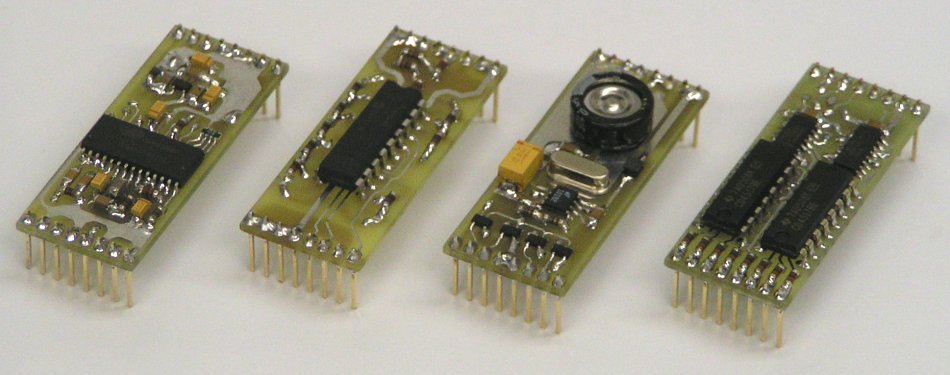

Hi all,
Project update,
I finally decided to go for a modular DI4T main board. All major circuits are now placed on small modules. This provides easy upgrading, troubleshooting and repair, and enables higher performance.
I split-up the main electronics in 4 modules, I attached a picture of these modules. Each module measures 0.82" (2.1cm) x 2" (5.1cm), and has an 8-way pin header on each side. The modules can also be used for other projects.
The one on the left is a complete SPDIF receiver module, based on a CS8416. The Toslink optical receiver module RX177L can be directly connected as the SPDIF receiver module has both an integrated SPDIF attenuator, and a capacitive coupling to RXP and RXN inputs. The loop filter is optimized for lowest jitter in order to prevent data corruption. Mode set resistors are included too, the module is set for slave-clock mode and I2S output. The integrated Micrel ultra low noise 3.3V LDO regulator (specified @ 260nV SQRT Hz) provides a clean power supply for the receiver chip.
Module connections: GND, VCC, SPDIF input, BCK input, WS input, DATA output and MCK output.
The next one is the Micro-controller-based tracker module. It's basically a Microchip controller, a discrete 10-bit R2R DAC, built using 0.1% SMD resistors, and a low capacitance output filter. The R2R DAC provides an analogue control voltage to tune the VCXO master clock module. The MCK input provides the source clock frequency reference, while the BCK input provides the master clock frequency reference. The micro-controller also runs on BCK (2.8224 MHz), so inter-modulation between multiple clocks is prevented. The module provides a "locked" output that indicates when the tracker has locked to the digital audio source.
Module connections: GND, VCC, MCK input, BCK input, Locked output and analogue control voltage output.
Next one is the master clock module, this module holds a discrete VCXO oscillator, and 4 ultra high speed separate clock buffers. The master clock generates 2.8224 MHz and has a pulling range of approx. 100ppm. The super cap is also integrated on this module. The low capacitance control voltage filter blocks unwanted interference. I wasn't able to measure any jitter with my measuring instruments when running this VCXO module on the novel charge-transfer power supply.
Module connections: GND, VCC, analogue control voltage input, and 4 buffered clock outputs.
The module on the right holds a 4 x interpolator, scrambler, WS, and differential DEM clock generator. The circuit is built around 4 x 64-bit shift-registers, counters, multiplexer, and inverters. The outputs have resistors installed that are part of the I2S input attenuators.
Module connections: GND, VCC, DATA input, BCK input, WS output, DEM output, NDEM output, WS16 output, WS32 output, WS48 output, WS64 output, DATA16 output, DATA32 output, NDATA48 output and NDATA64 output.

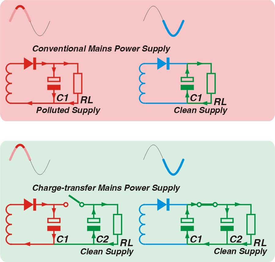

I already blocked source jitter, but I didn't block mains noise. Clean power supplies turned out to be just as important as low timing jitter. Battery power supplies have the potential of providing a clean power supply voltage, but using batteries can be rather problematic.
First I had the illusion that a super regulator could solve this mains noise issue, it turned out it can't. The noise still enters through the multiple closed current paths between transformer, connected electronics, and connected equipment (amplifiers, CD players, Computers). The noise causes both DC and ac voltage drops across GND, that are then added to the clean super reg output, resulting in virtually similar noise levels at the load. Even worse is that the current path often extends to connected equipment, causing even more problems.
So I figured the only way to get rid of the mains noise was to completely interrupt the current paths between transformer and electronics while still transferring the required energy. In other words, I had to transfer energy from transformer to load without actually connecting both.
Well I have come up with a suitable solution, the charge-transfer power supply. It completely interrupts the current path between both transformer and load (blocking mains noise) while still transferring energy from the mains power supply to the load.

Charge-transfer power supply basics
Hi maxlorenz,
At first I tried all the tricks that are commonly used in an attempt to obtain clean power supplies (Schottky diodes, exotic caps, filters, ultra-low noise voltage regulators, super regulators, gyrators and so on). But compared to a good battery power supply, all these tricks simply seemed to fail.
I spend quite some time figuring out what caused this, why does a battery power supply work so much better, despite comparable noise levels?
It appears to be the pollution on the supply current path, a battery creates a pure DC supply current path, while a mains voltage creates both a DC and ac (pollution) current path at the same time. Since this current runs through all connected electronic circuits, it pollutes all.
So I attempted to mimic a battery power supply using a mains power supply. My batteries are electrolytic caps, and they are depleted within a few hundred milliseconds, so they need to be charged frequently, 50 ... 120 times a second. This is done by using an electronic power switch that is operated at the mains frequency (half-wave rectifier), or double mains frequency (full-wave rectifier). The trick is to charge this capacitor without introducing the unwanted polluted current path between transformer and load.
They say that a picture tells more than a thousand words, so I added a simple basic schematic of both a conventional mains power supply, and the new charge-transfer power supply.
I used the red color to indicate the polluted current path, and the green color to indicate the clean current path. The dark red color at the peak of the sine-wave illustrates the charge current flow, the electronic switch is OPEN during this short charge cycle.
The blue color indicates no current flow (rectifier diodes are not conducting). This basically means that the unwanted charge current path is interrupted (open circuit) during this time
These charge-transfer power supplies seem to be able to mimic a very good battery power supply, while running on a heavily polluted mains power supply.
I already tested 3 of these charge-transfer power supplies (+10V, -10V, and -20V) in the DI4T, the impact on sound quality could best be described using your phrase "I have no words ....".

Hi John.
Is the PS thing your invention? You should be careful then, other people might steal your ideas. 😉
I am still loving my batteries with TeddyRegs. I think low impedance is the key.
However, sooner or later I need try your approach.
