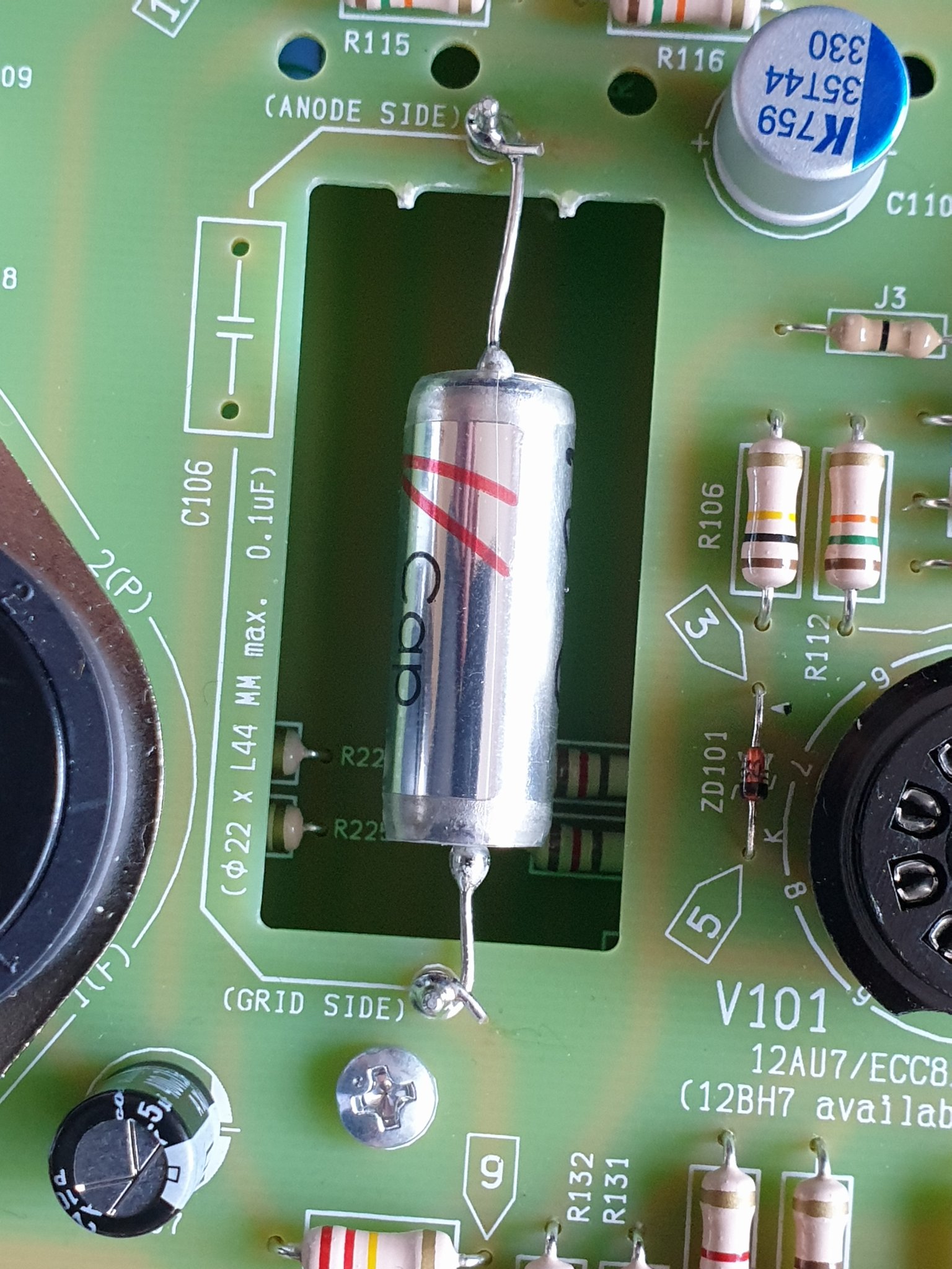

I think I got lucky. I couldn't see anything on the caps to indicate alignment - and hadn't stumbled across this part of the thread - so just installed them this way. The installation notes that Victor points to say: "Another way to identify outer foil is the writing on the label flows towards the outer foil." (since the leads were cut after soldering, I can't tell from the primary way,: The short lead indicates the outermost foil, and should be connected to the lowest impedance path to ground.) But as the picture shows, the writing flows in the direction of the grid side: whew! (Or am I missing something?)
