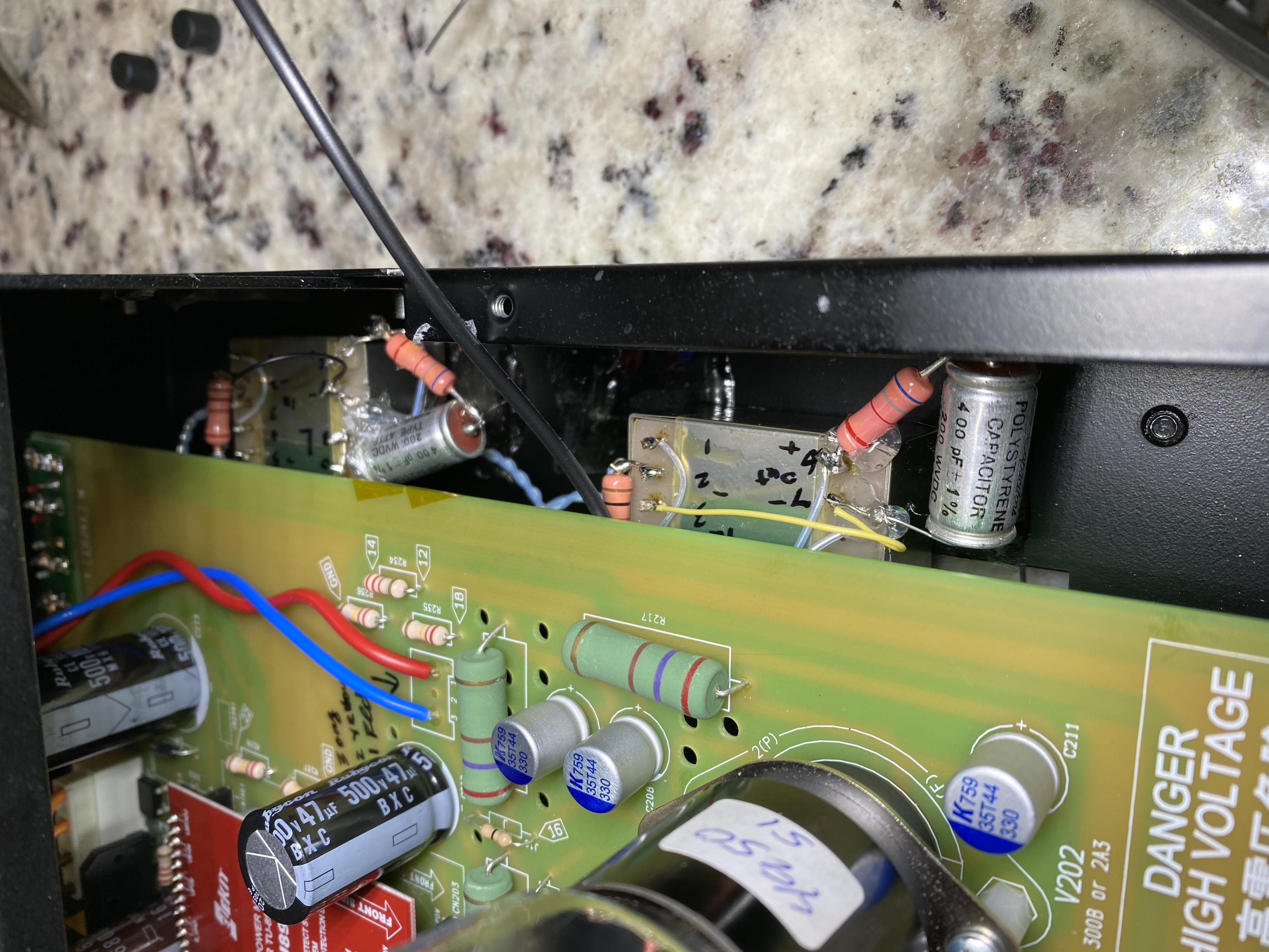

Victor is totally awesome to deal with. We as a community are lucky to have Victor. Today I swapped out my Jensen transformers to Lundahl 1690 as an input pair for balanced input. There are upgraded performances from VS the Jensen. Soundstage is wider VS Jensen which is narrower, the depth is a bit elusive as I think the Jensen is narrower so it projected about similar depth but the illusion is deeper. Also the Lundahl has better retrievals in low and high extensions, clarity and airiness is also upped a bit. It is definitely worthy an upgrade
Thank you Victor once more, it isn’t your cup of teas to special order the 1690 but you did so for me anyways!!! Love it !
