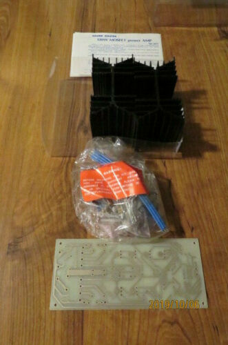

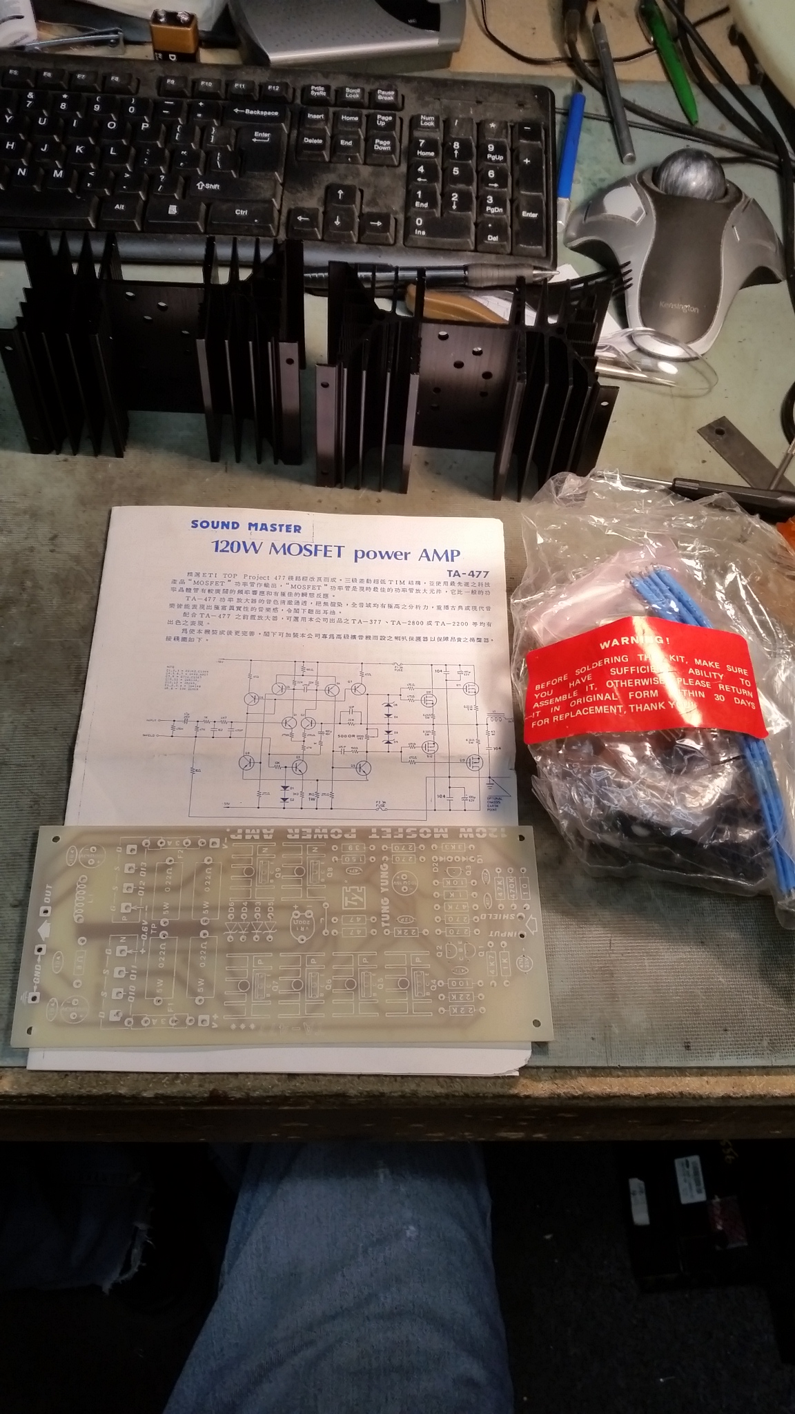

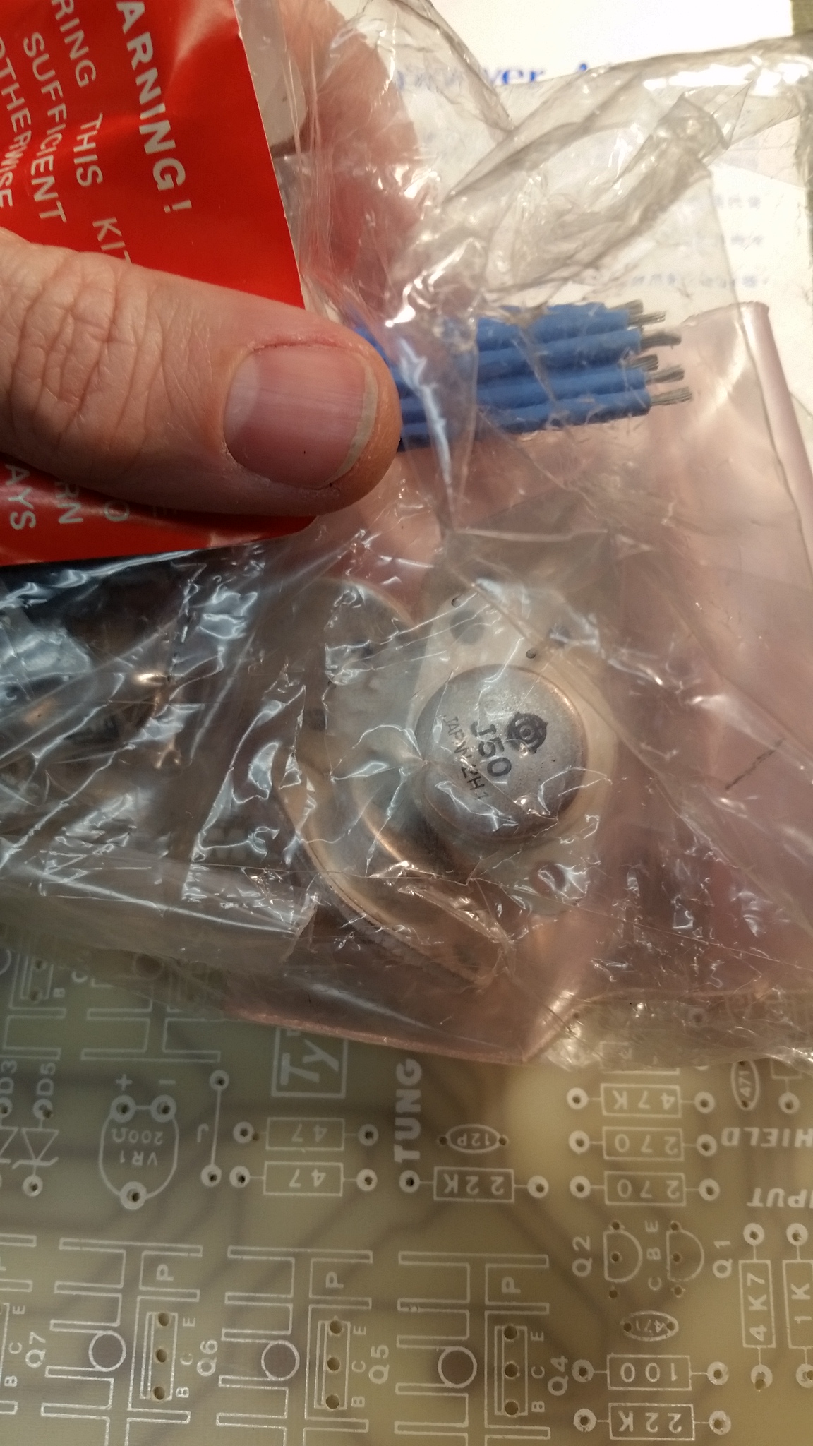

Cruising eBay the other day I came across this interesting 120 watt Mosfet Amplifier kit. I placed my bid for a few bucks and won it! the 4 NOS Hitachi mosfets alone are worth several times what i won it for. Sadly there was only one and I seriously doubt i will find another so I thought it would be fun to build this as a General Purpose Shop duty amplifier.
I didn't know anything about these kits. but apparently this was from the Mark V era of kits? and I found a thread here on DIY that appears to be related.

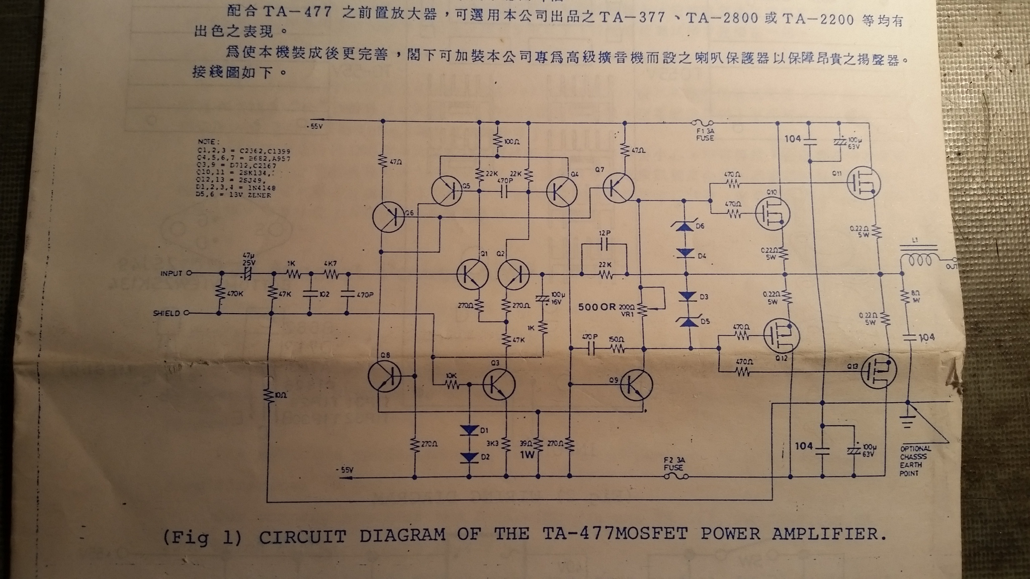

there are several mods mentioned in this thread and I thought a review of them and any others to help make this a solid reliable amplifier might be in order. your input is welcomed.

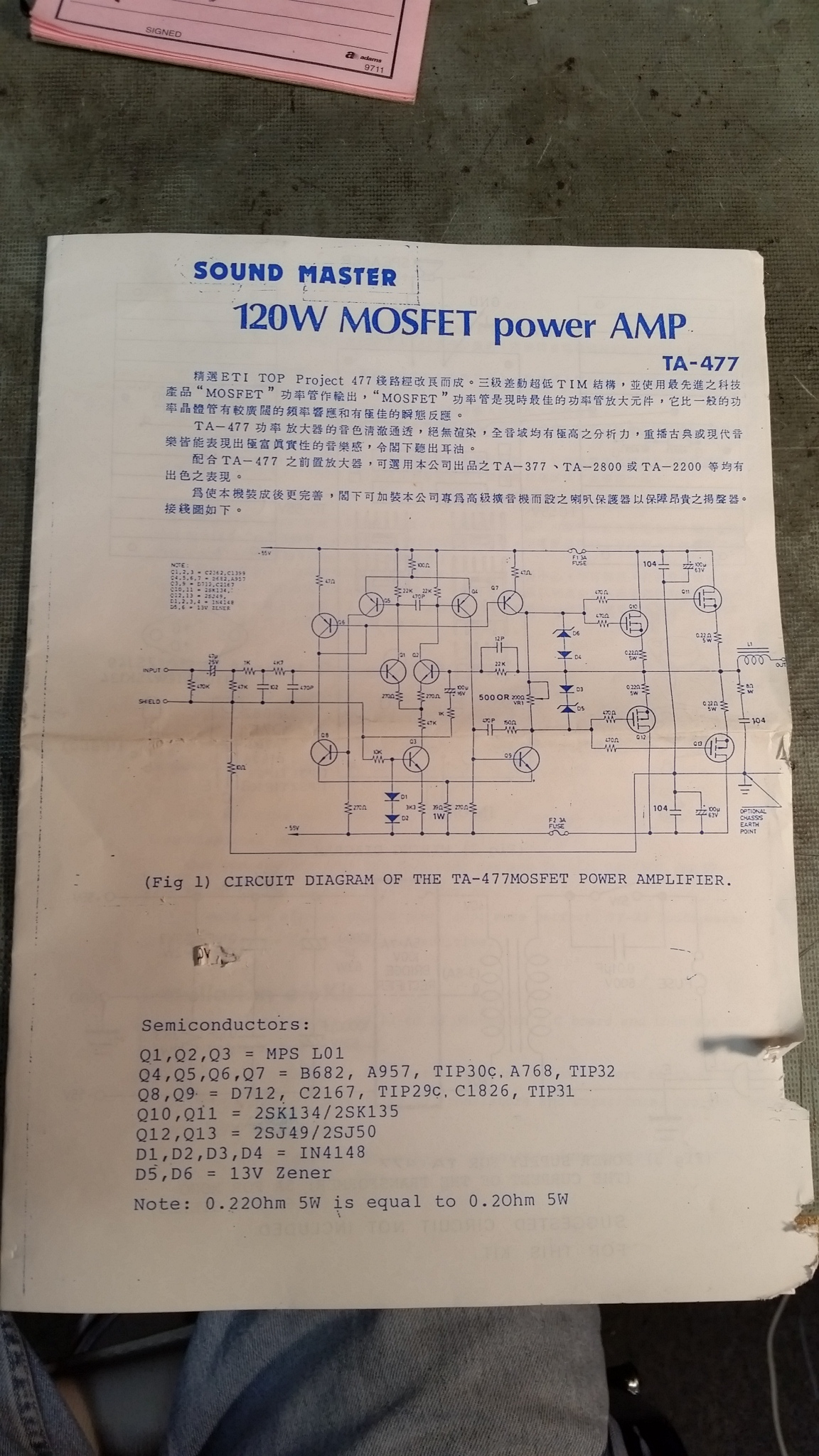

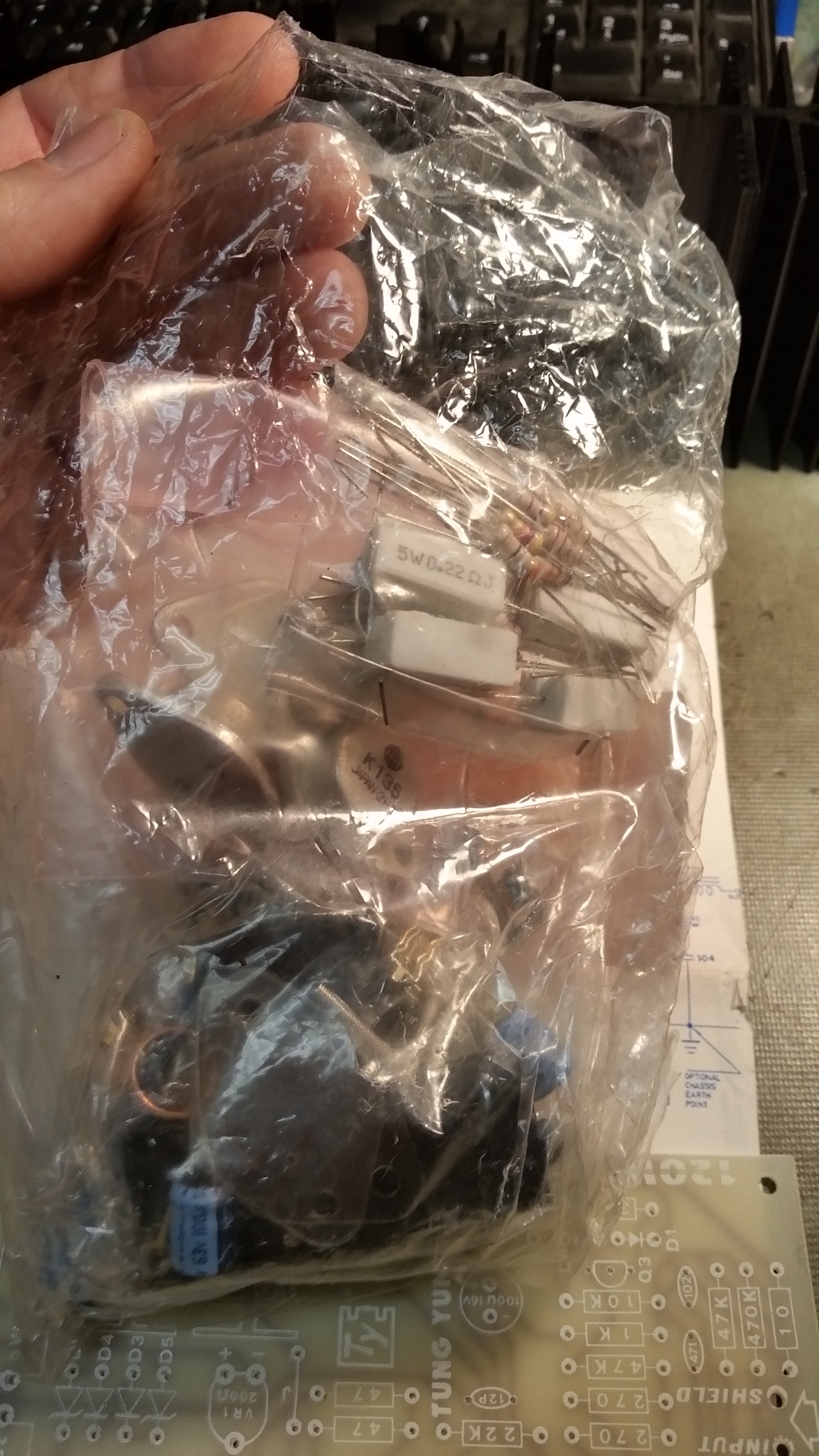

i had time tonight to assemble most of my board. the input transistors and constant current are MPSL01's but all the others are TIP31/32's which I am betting could/should be replaced with better devices.

I have a derivative of the ETI477 in an edition of collected project from ETI, which includes ETI499 a "General Purpose 150W power amp module".
If you compare this to the schematic you have, there are some changes to resistor values, transistor types, and the compensation method. The 12pF lead capacitor in parallel with 22k has been replaced by R12 in series with C4.
The MOSFET stoppers are 220R with gate to source capacitors of 330p for the 2SK134. The top ends of source resistors R22 and R24 are co-joined by C7 under the pcb.

Not quite. Here's a short history and actual ETI477 schematic which is a little more complex than Hitachi's minimal power application note design, as we might expect from a mathematician such as the designer, David Tilbrook. Fixing the ETI 477 100W Audio Amp module – Blogubarra

Very interesting. SO. In the interest of reliability. again, My intent is to use this as a GP shop amp and not a audiophile home amp, my intent is stability and reliability. what mods should be done to make it as stable as possible??

I would because I don't think the TIP series transistors are much good as drivers for mosfet or BJT output stages - only 3MHz Ft and low gain like a small power transistor, though they could work after a fashion in a BJT output stage assuming you have say, TIP31C/32C types to withstand the total of the rail voltages which in this case are +/- 50V. The original spec. Hitachi's driver semis were unusually fast for audio transistors in their day, so to avoid ordering thousands of semis and selling them off piecemeal, the only option for kitsellers was to use video drivers which were already fast enough, quite linear and readily available through TV service agencies.
