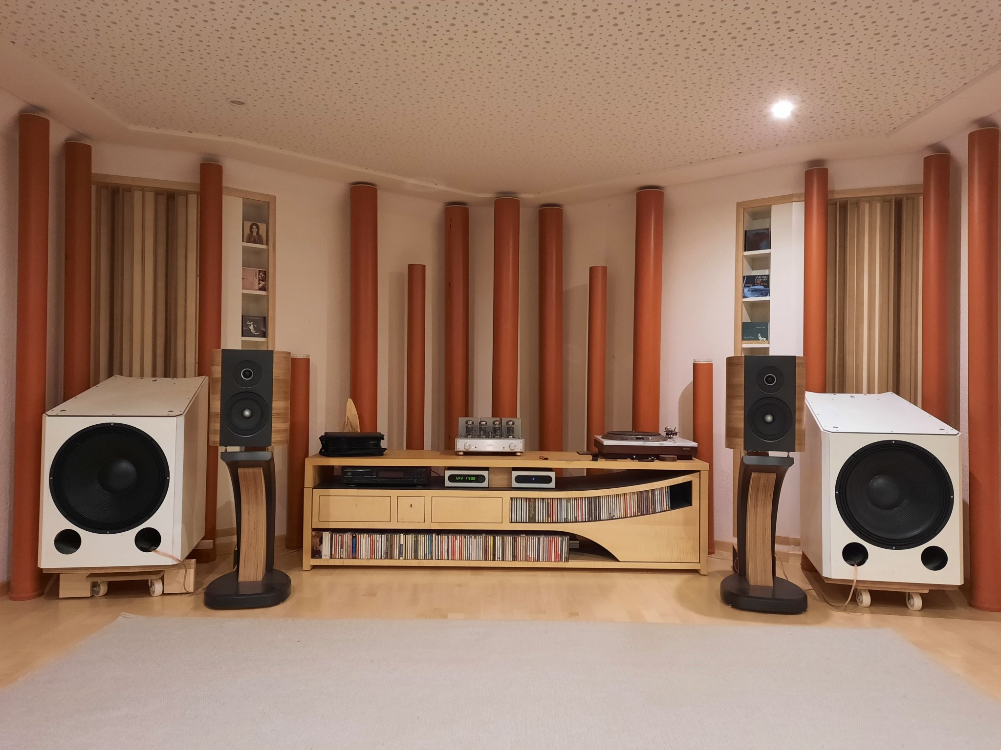

So, if you were wondering how the 18inch BMS 18N862 sounds like... this short video might give you a glimpse.
The BMS play with my current magico mini wannabe. I just plugged the BMS and the nextel mid to the same crossover 🙂 since the dedicated TL2 crossover is not ready yet. But what do you know? The sonofabitch is producing tremendous bass capabilities, powerfull, fast, and very accurate 👌😀
I recorded a trance track that made my jaw falls to the ground... no audiophile music this time!
Please use headphones
Needless to say that I took cover behind the sofa 😉

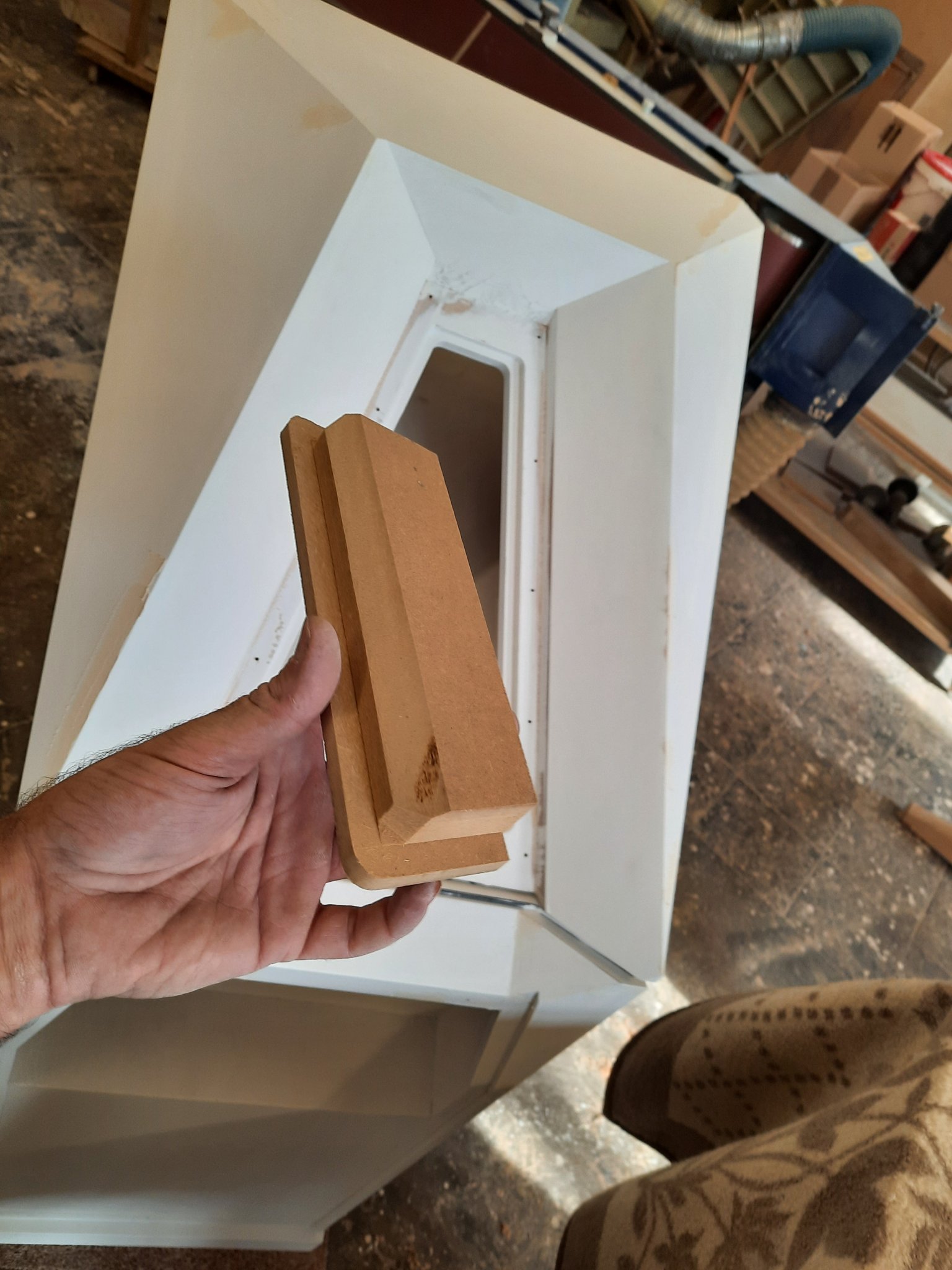

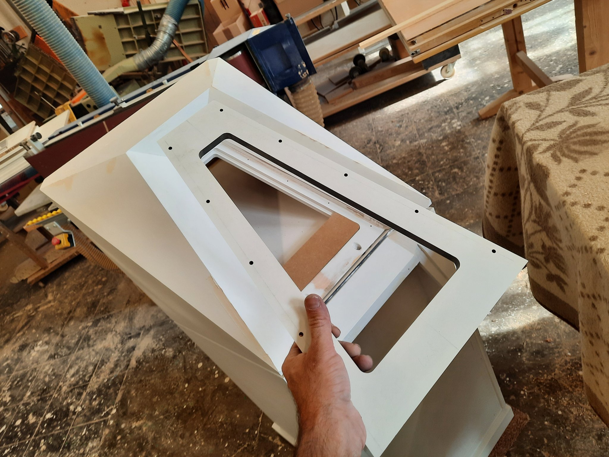

For cutting the circle I use this tool:
https://www.ebay.de/itm/22292281980...55-0&campid=5338722076&customid=&toolid=10050
Super easy to use. I also recommend having the drivers before routing.... and better still is to do a mockup routing to be sure you are routing the exact right size.

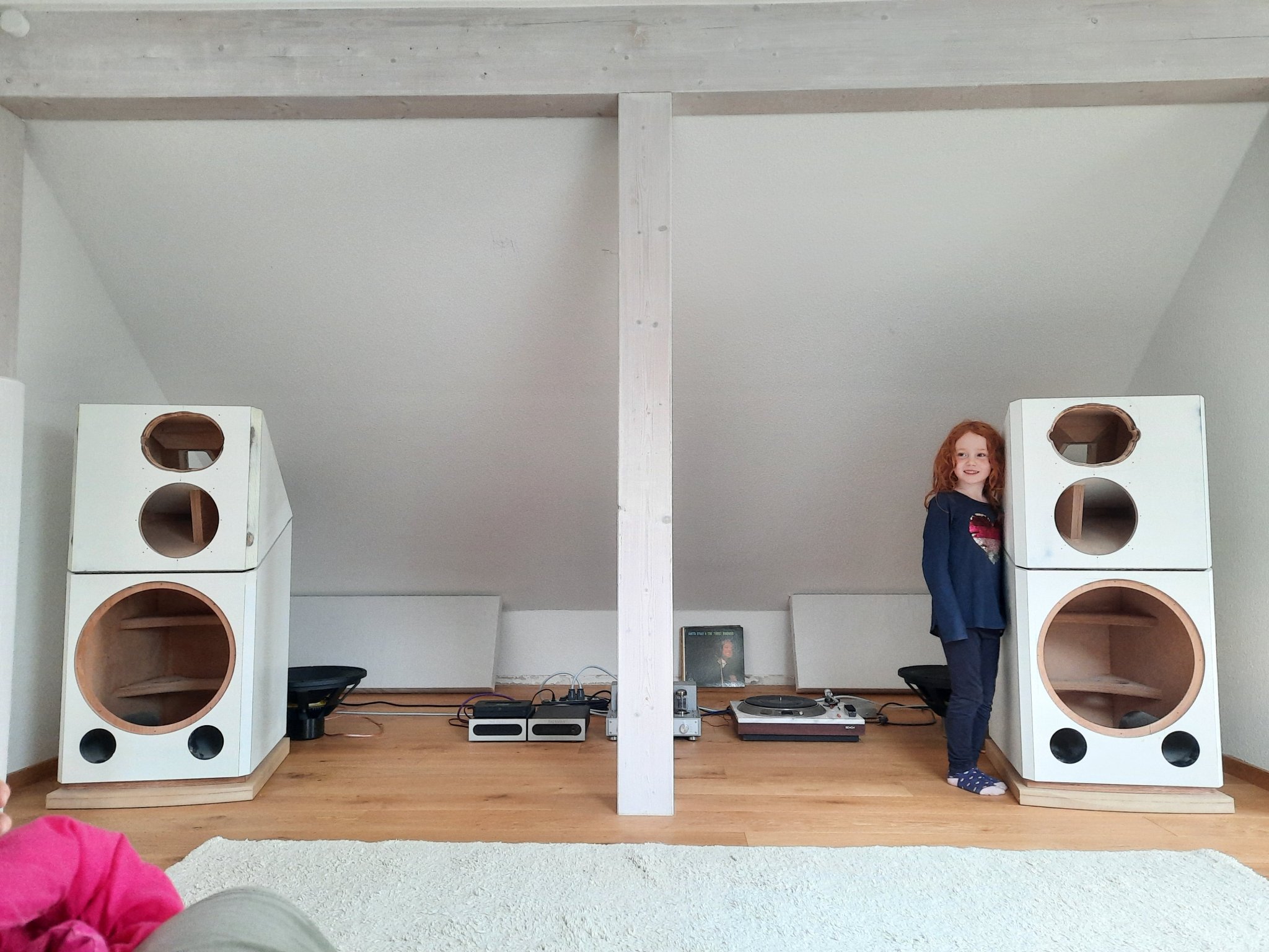

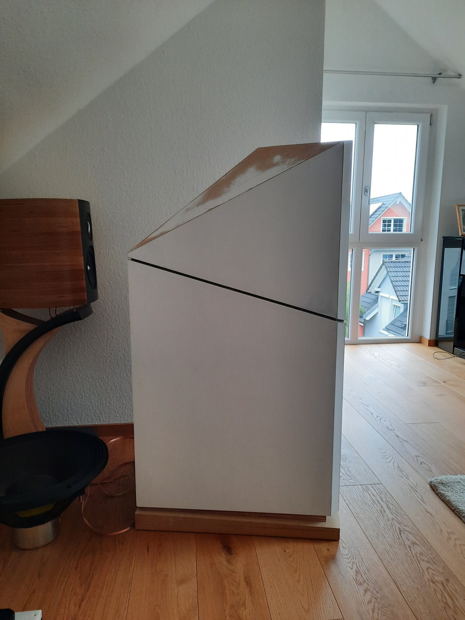

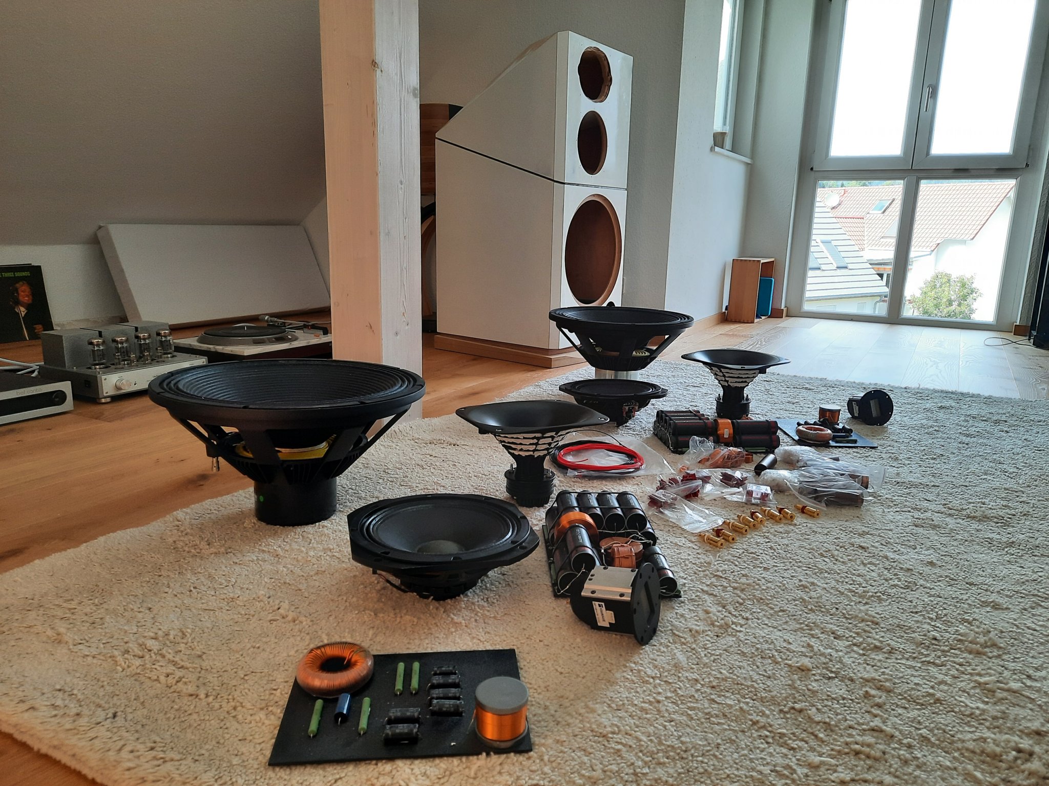

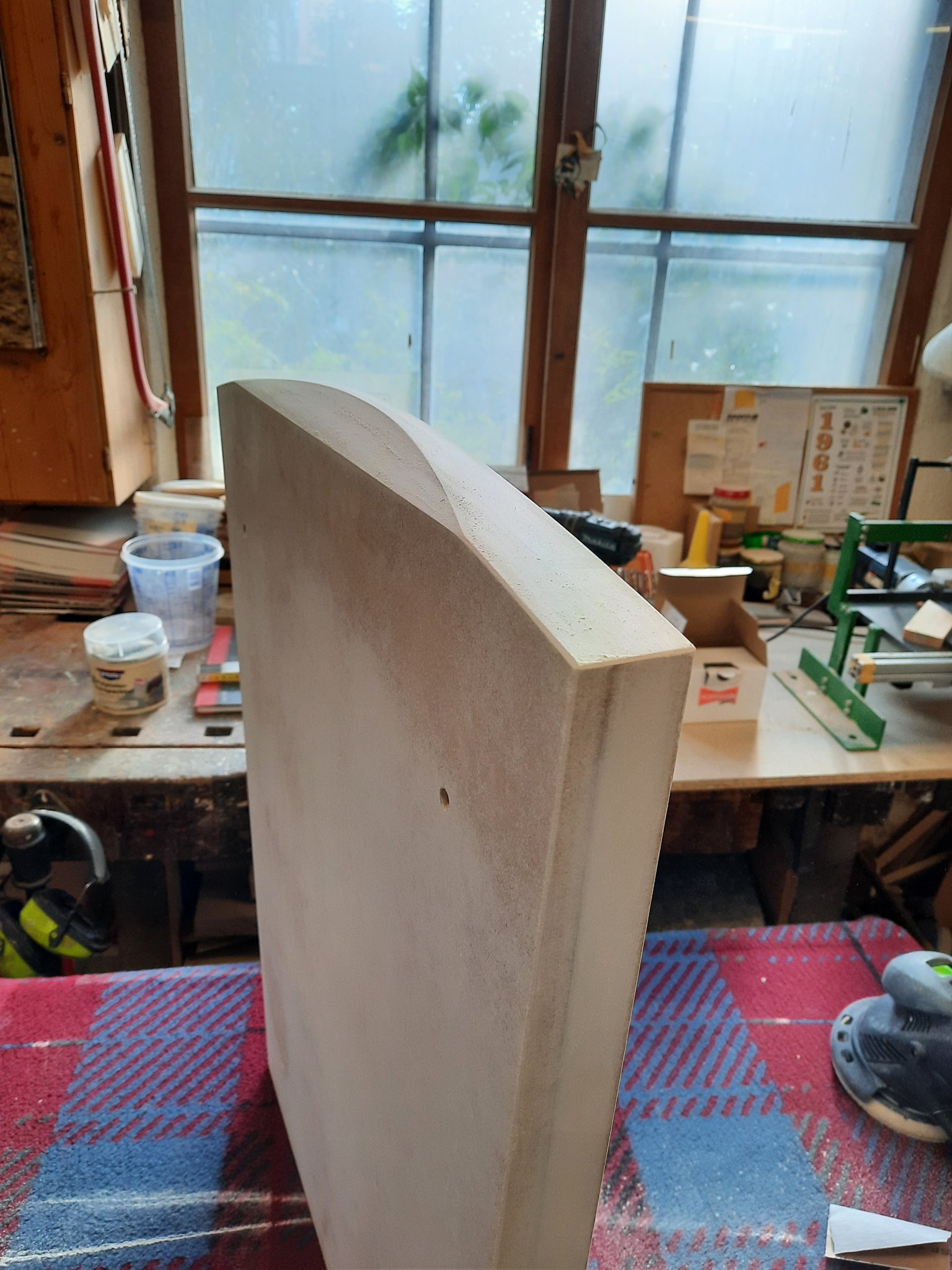

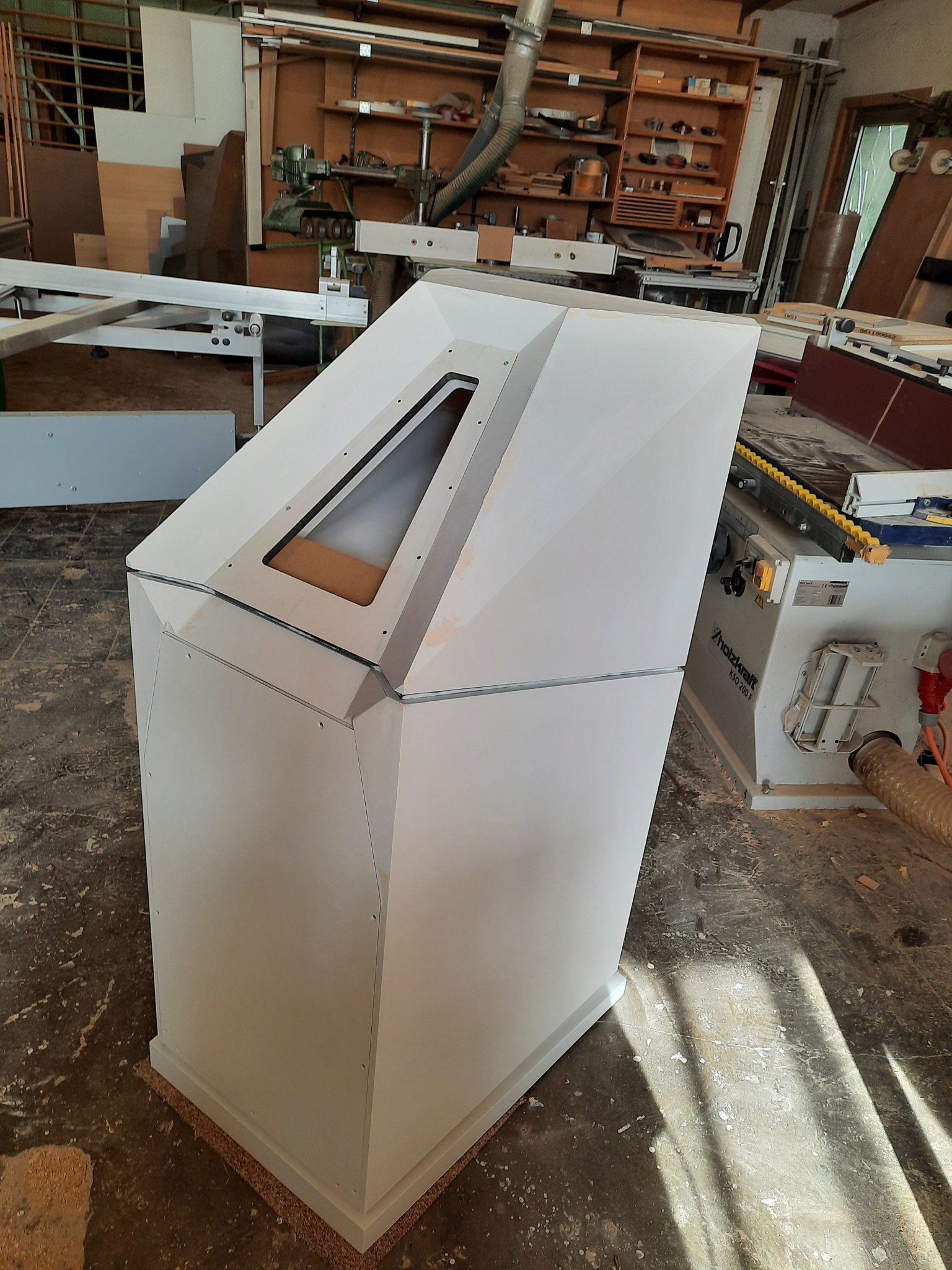

So , moving to a new house is done and my wife is content enough with my household and renovations projects that she let's me continue with the awsome TL2 work. I have decided to call it K2... named after the deadly K2 mountain... maybe not the tallest but certainly the most ominous mountain out there... a proper name indeed for the monstrosity the TL2 is. After setting my pair in our upmost floor, I tooked my clients pair to the workshop, starting today with primer color. Lots of work, but feels awsome to do those stuff I like After 3months of tedious renovation work.
noamgeller,
Hopefully you will get sound from these monsters real soon.
Well, good to know that your better half is tolerating these fridge-like structures 🙂, what does the little angel think of papa's new toys?

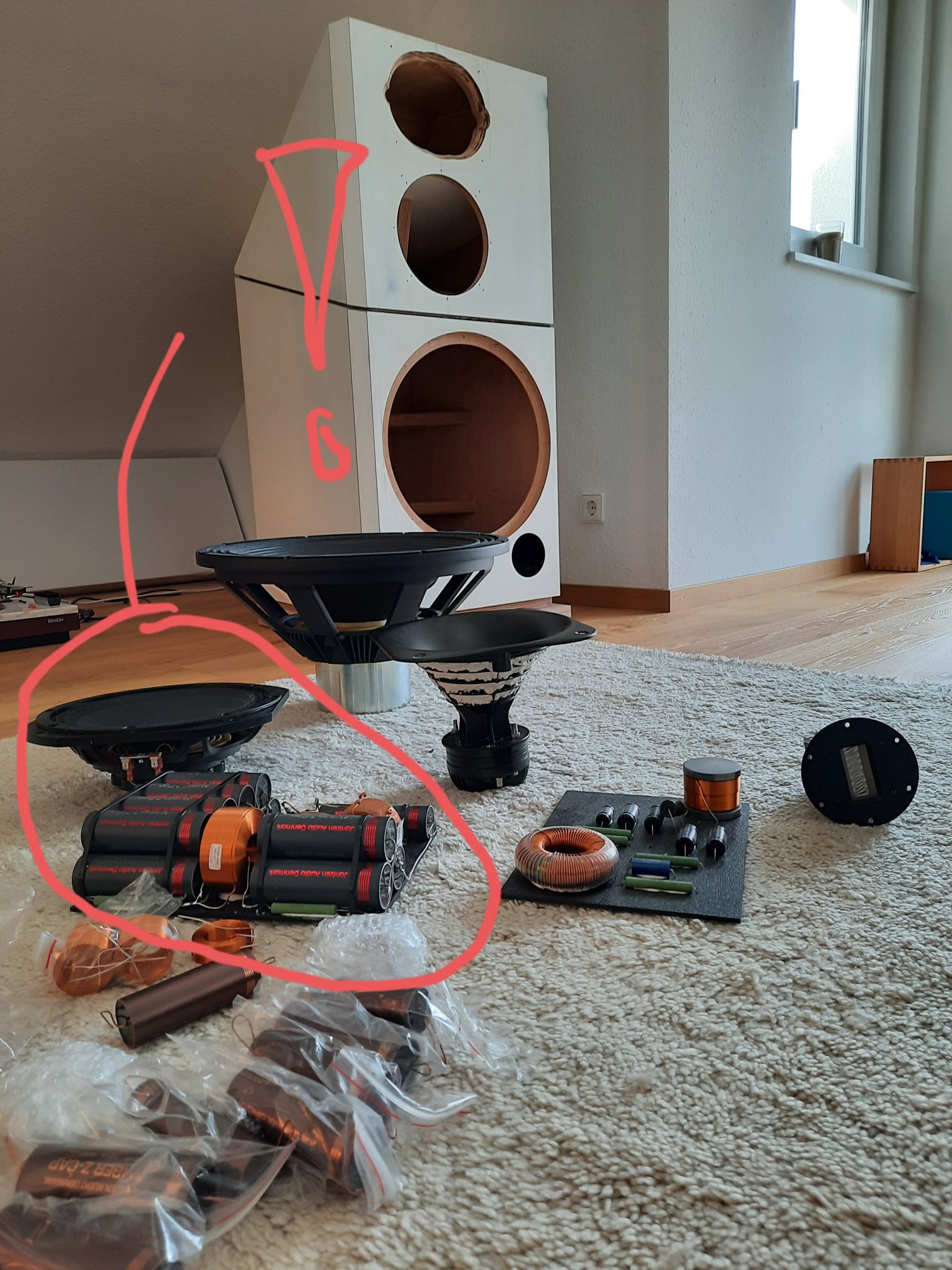

The crazy thing is that the chunkiest crossover (highlighted in red) is responsible solely of the 10inch middriver!!!Those caps almost look dangerous... 😳
Yes, that is the normal thing. Mid-range crossovers are always twice as big as the other two.
Great news! The other pair of the TL2 is playing in our new home. Here is a short video of how it sounds. (Headphone is recommended)
Beautiful listen room design and treatment... Speakers pretty cool too!Test, test
Congratulations!Great news! The other pair of the TL2 is playing in our new home.
So, do they live up to Munich standards, i.e. Viva, Lorenzo?
Thanks! Yes, this speakers are tremendous! They are very similar to the Lorenzo and Viva speakers, in their effortless presentation. Fast and snappy, huge soundstage, and vocal to die for. The best of it is that they don't break a sweat and almost always pleading to turn the volume up. Dynamic and fun at low volume, dynamic and scary at high volume levels.Congratulations!
