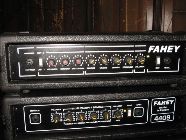

FWIW I build my amps in chipboard cabinets.
[image]http://img39.imageshack.us/img39/102/img0792qi.jpg[/image]
A front panel with the preamp, a back panel with power amp, PSU *and* the transformer directly bolted to it in 100W amps; bolted straight to the wooden case if 150W up, so there's *plenty* naked wooden surfaces all around ... never had a fire problem.
*Sometimes* I had to repair charred PCBs (and the wood above showed black greasy looking soot) , *always* because a power fuse blew in mid-concert and some "genius" repaired it with a piece of cigarette paper or replaced it with a fuse pulled from the car or motorcycle.
In that case yes, I have found exploded ballast resistors , cracked plastic power transistors, some showing a charred crater.
After all, if the fuse does not blow, *something else* must.
But never ever a wooden cabinet caught fire, even under such extreme circumstances.
We are talking over 10.000 (ten thousand) amps in over 43 years selling them commercially, so the data is valid.
