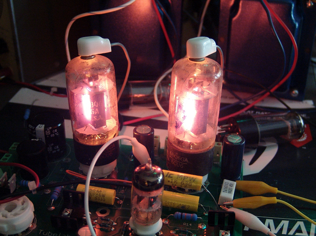

The direct IR radiation can be felt in some of my experiments. It can also be reflected with shiney aluminum foil.
I could obviously feel the IR in both of these rather extreme experiments. Look at the reflection in the OPT's. That's why they get warm:

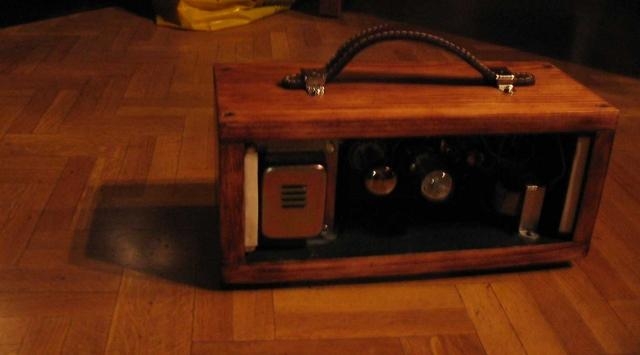

Well, I haven't read the whole thread but......you can see the 6V6 almost touching the wood there in that picture. The wood gets warm but that 'Champ' has several years, same tube, no problems. Still, the second time around I placed the tubes in an horizontal position. You have to take care doing that with the 5Y3. The datasheet tells you how to do it, I don't remember it now.
Actually I appreciate the idea of taking advantage of any direct radiation out of the cabinet. I'm gooing to make use of that. Conducted heat????? Where, out the pins to the socket and wires?There is also plenty of conducted heat

An interesting experiment you can do (but don't) is to turn the power tube base up and submerge the glass envelope in a large container of room temperature water. The envelope will remain cool but the tube internals will not be effected at all. Even if you hold the tube's glass parts to a low temp. the insides do not seem to notice or care. In other words you can't get more power from a tube using water cooling. I think what this tells us is that the energy goes right through the glass and heats the inside of the cabinet or whatever is in the line of sight.
You are right, in the normal case the envelope do cool by convection but ERY little of the total energy is going into the envelope, most pass right on through.

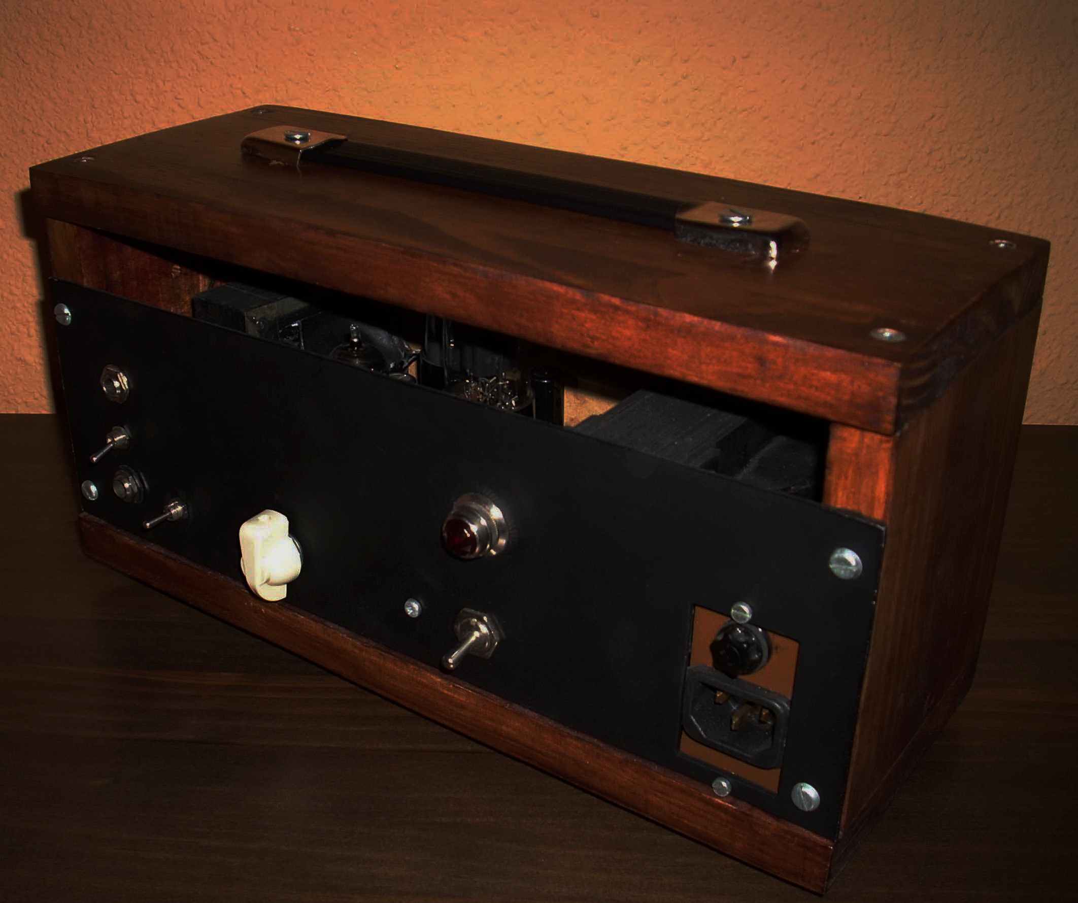

Power Plug - 6/12 Attenuator - YouTube
I wanna build something like this, I love that wood look man, old school/retro man just killer lol.
