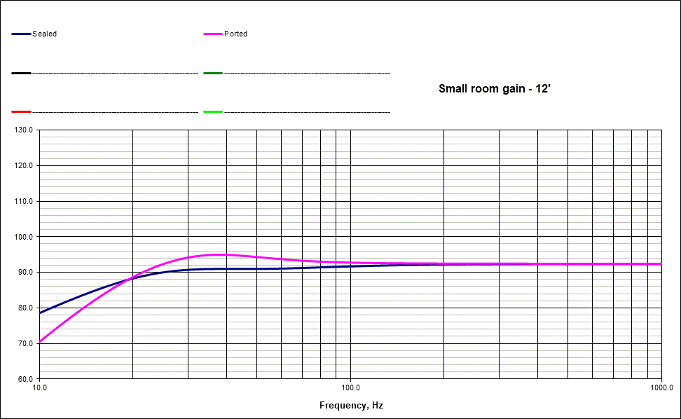

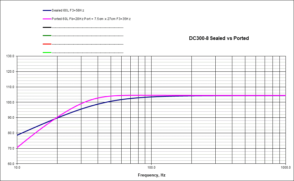

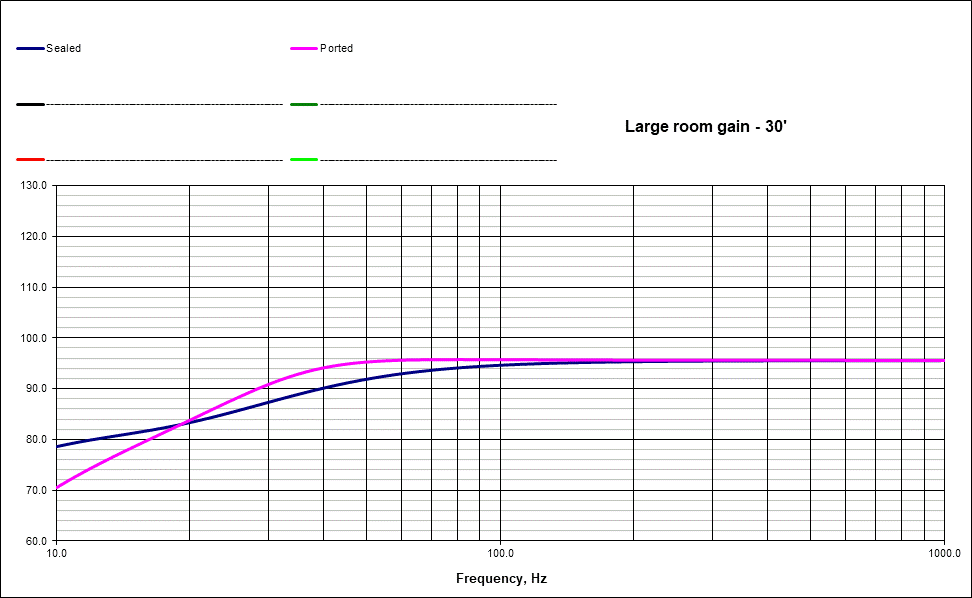

Attached is the DC300-8 sealed vs ported in 60L. Here's a drawback to the Tarkus mid - it needs a fairly large box, 13L internal in the original design which leaves less room for the woofer volume. Other mid choices could work in 4-6L which will give a lower F3 for the woofer with 10 extra liters.
Again I think Rich's suggestion is best - go ported and stuff it if you think that sounds better. And I think room gain in a large room will match better with the ported version since it will start lower in frequency than where the sealed version starts to roll-off up around 100Hz.

It's always a personal choice but I hardly ever look at the F3 point, for my tastes it is the F10 that is important and for that the sealed data point looks better to me.

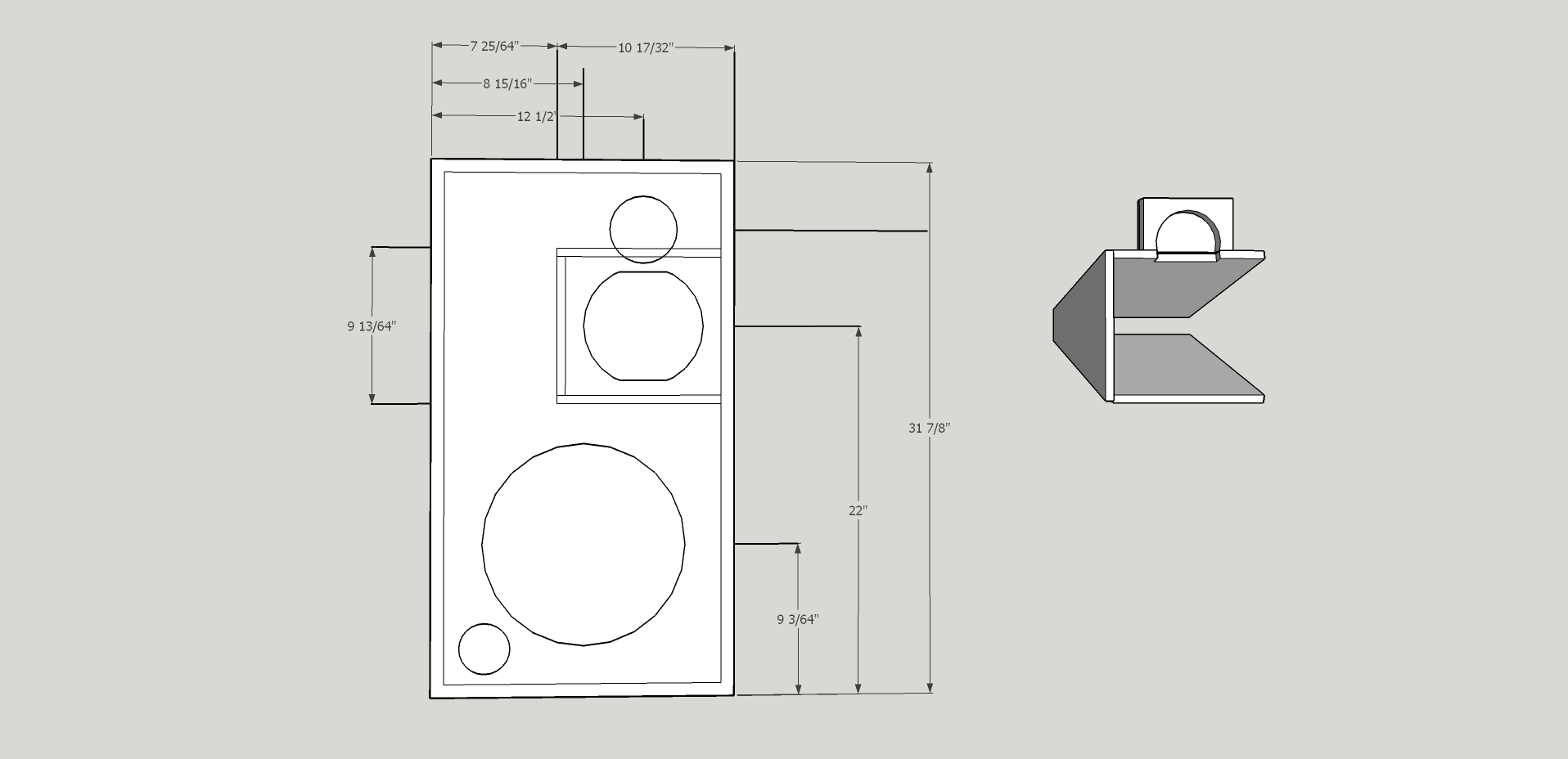

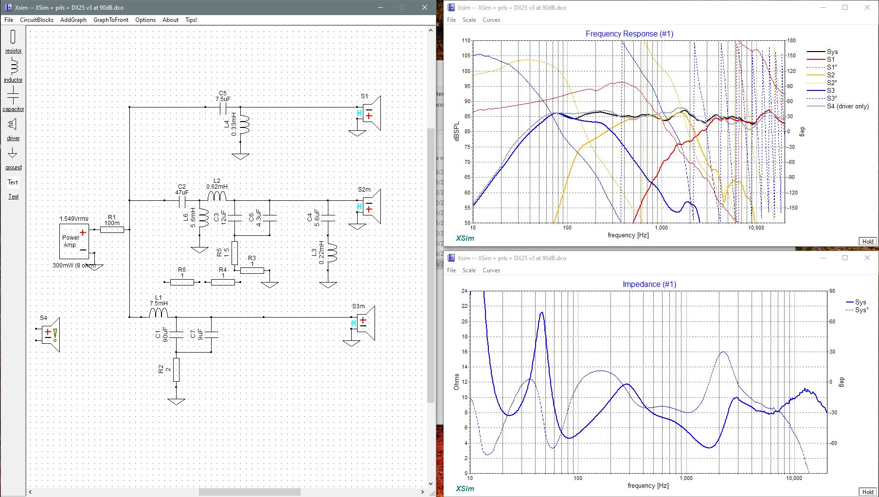

So here's what I've come up with. First I did a sim of the original Tarkus. The summed FR isn't exactly the same as what was measured which tells us that the real driver FR's and/or impedances are probably just a little different than in real life. Which re-enforces why it's always better to measure than to just sim. But that's ok. I just used this simulated summed FR of the original as the new target response which means that if I can get the new summed FR to mimic this one, it should sound the same as the real speaker measured in reality. This will be the grey curve in the FR pics below.
So just to be clear, it's ok that the FR isn't perfectly flat. In reality, it will be flatter than what is shown, but the original isn't completely flat either. That's a choice the designer made because it sounded best to him that way. But if you did want to try to get things flatter, I suggest a couple of ways to do that below by adjusting some resistors.
With your speakers being up close to the back wall, it is difficult to know exactly what the effects are going to be. So I've done 2 sims. One with 3dB of baffle step loss and one with 0dB. I would start with the 1st one. If you find that there is too much bass with that one, then make the changes needed to match the 2nd design.
You can also adjust the mid peaking at about 1800Hz and/or the overall tweeter output by adding resistors which I've shown in pic 1. For the tweeter put them in series with R7. For the mid, put them in series with R5. Be sure to buy 5 or 6 extra 1ohm resistors. Ignore R1 in the schematic - it's just there for design purposes. Ten watt resistors work everywhere except maybe R6. It probably isn't necessary but it wouldn't hurt if that was good for 20W. You can get a 12ohm 20W resistor or you can put 2 x 24ohm 10W resistors together wired in parallel to do the same thing.
Every inductor also has a resistance value so you need to get those right as well. If you download XSim, you can open the versions I've attached. Right click on the inductor, choose 'Tune' and you'll see what the values should be. L1 needs an iron core and needs the lowest resistance possible. The same is true for L6 in the 2nd design. You may want to buy L6 (it's the only additional part needed for the 2nd design) with everything else right away or you might want to wait until after you put the 1st design together and determine if you think it sounds right or not.
Pic 3 shows driver and mid chamber positioning. You can move the woofer up and down if you want but the mid and tweeter are best at those locations. You can put the port really wherever you want. I just located it down in the bottom left corner for no particular reason.
There are already differences of opinion on what to do for the mid chamber. I personally like to make sure that it's big enough to allow enough stuffing to absorb as much as the back energy as possible so it doesn't bounce off the back wall and go right back out the driver cone thereby muddying the sound. Having more depth helps in this regard as well as having a progressively tapering shape. In the right of the pic is probably what I would do and have it run the full length of the cabinet. I put a 19 degree angle on the top and bottom panels and the internal volume works out to about 8L. You'll also need to do a little trickery around the tweeter to make sure that the chamber is well sealed from the rest of the box. Hope it's clear from the pic how to solve that. Half inch wood will probably be fine here. But this is just 1 way of doing it - you may prefer something else.

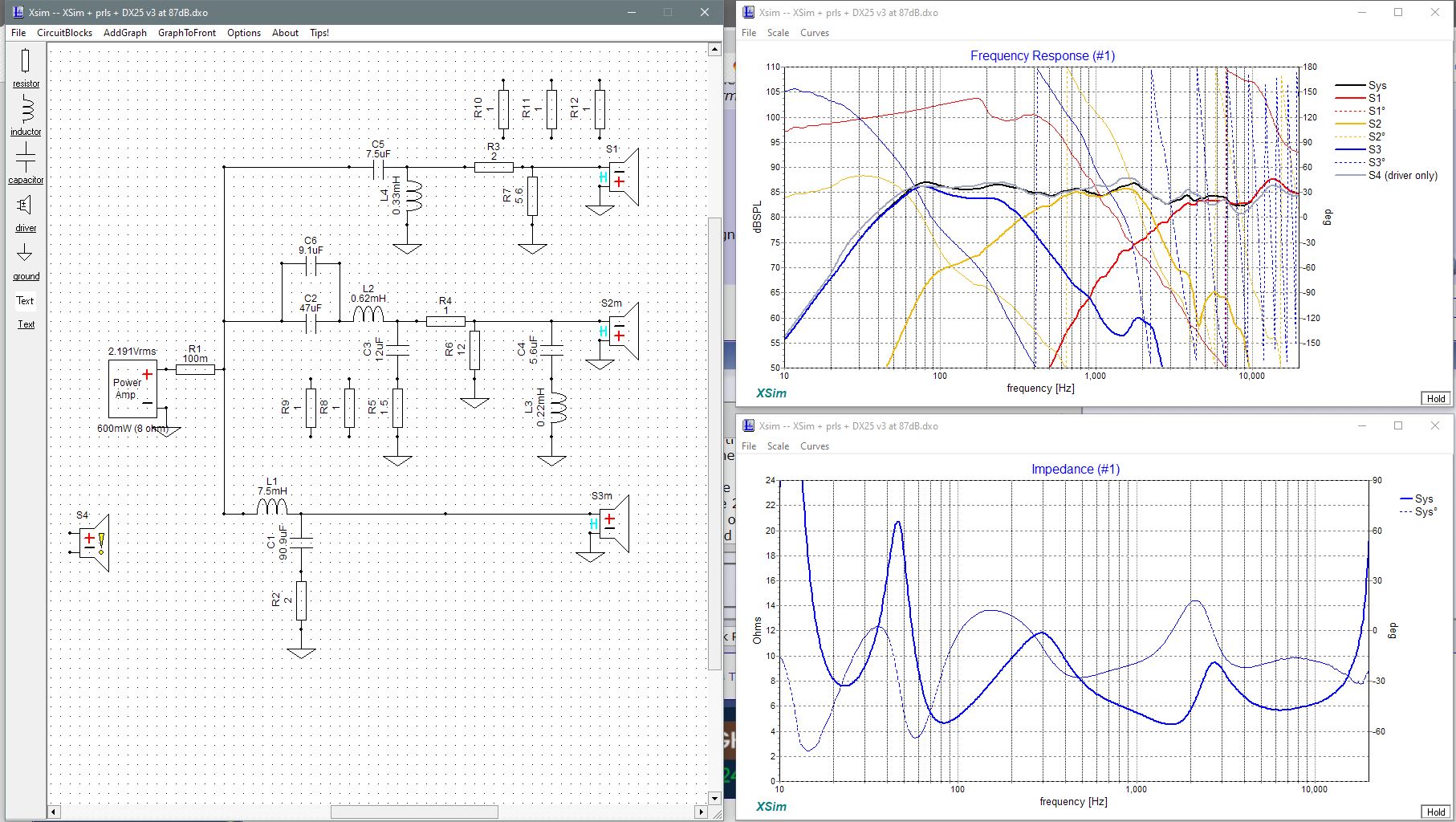

The impedance of the 1st design stays just above 4ohm but when you pull all the resistors on the mid and tweeter to get them to play louder in the 2nd design, the impedance minimum drops to about 3ohm. Still, that's fine for a 4ohm nominal amplifier. Unfortunately, the design isn't very efficient meaning it will need a fair amount of power from the amp. I tried but wasn't able to do anything about it while trying to maintain a FR as close as possible to the target summed response.

Correction: I said there was only 1 new component on the 2nd xo. There's actually an additional capacitor too (C6-4.3uF) plus the addition of one of the extra resistors, R3. The 9uF cap gets moved around too.
Another word on capacitors. They're not available in every single value, so it's ok to add 2 values together to get what you need. Capacitors add together when they are wired in parallel. Large values can get expensive which makes no sense for this build so you can use non-polarized electrolytics for the 2 highest ones, 47uF and 90uF. If you can't get an exact value, close enough will probably be fine. Maybe let me know and I'll see if the change is significant or not.

Regarding the mid chamber, I did a volume calculation on the design using the 2 slanted panels and I only have a volume of 4.4 - 6.3 liters depending on how big I make it. This is due to how shallow the speakers are. I'll try to figure out a larger enclosure.
