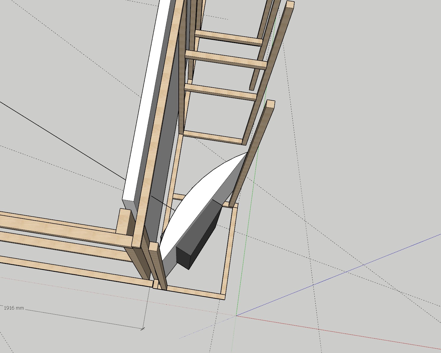

I am actually thinking about building a baffle "wall", most likely a size of about 1x1 meter. And the speaker will be mounted in the middle. I'm was watching some videos from Anthony Grimaldi, and seen there that he actually recommends separate baffle walls for each speaker, not one big wall. That comes well considering that I have tower-subwoofers, giving me enough space for that. I will however not make it top to bottom, but only about 1m high, as I want to leave myself space for acoustic measures like HH-resonators and plate absorbers. And the rest of the space, whatever is left, will be filled with sonorock (also inside the baffle wall).

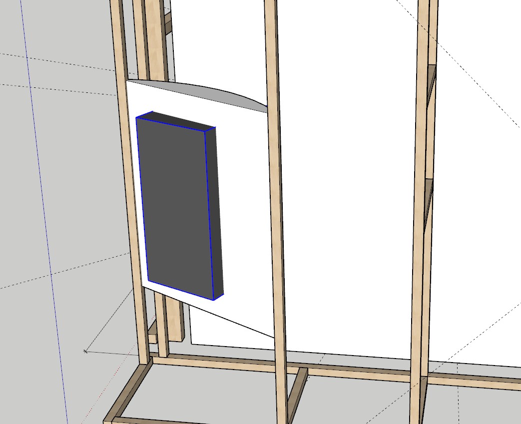

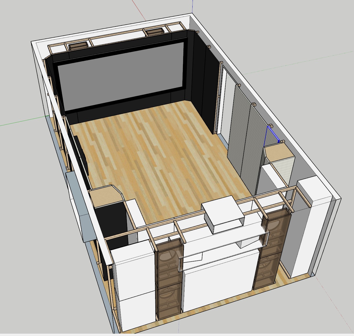

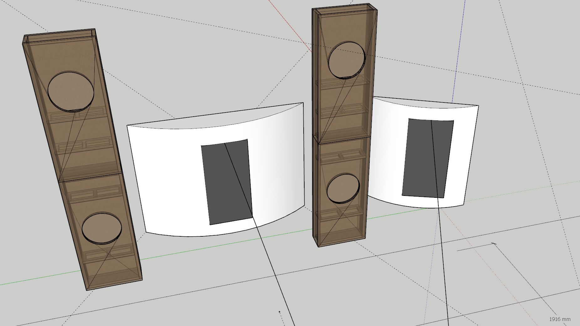

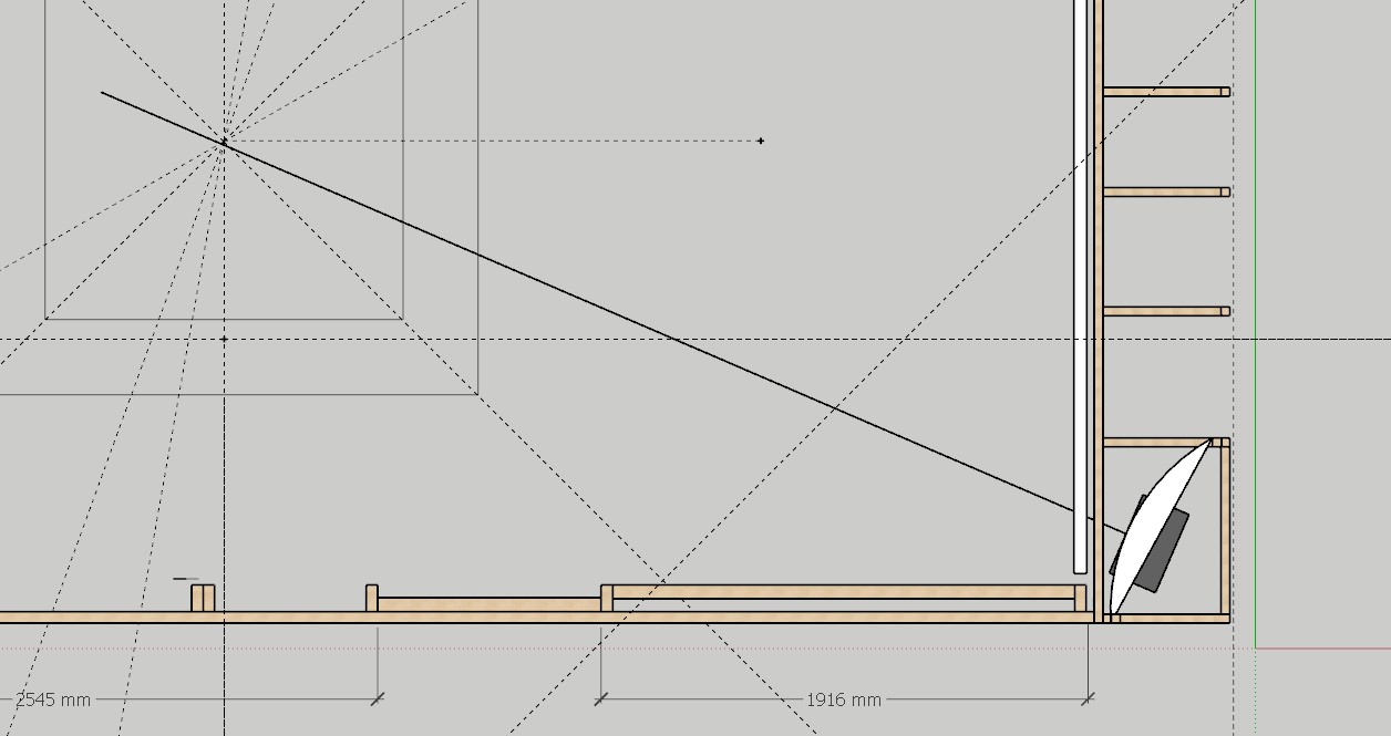

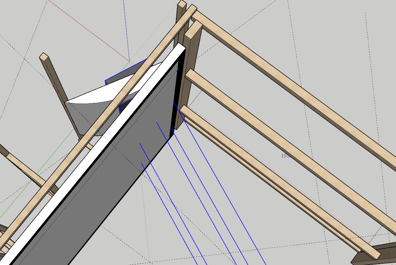

Here are some screenshots.

1m baffle is a good idea IMO. Much better than the slim/deep tower trend these days. Allow you to use the depth of the room much better. How the screen will impact HF response is hard to guess but I still think horns and compression drivers give you more flexibility in terms of sensitivity adjustment. Find some high sensitive 8” PA drivers that have a smooth response way over 3000hz makes it easier to match with a horn maybe at 2,5kHz and less DSP needed. Especially since you don’t need deep bass in these you have better options selecting PA.

You misunderstood maybe. The speaker is smaller. The black surface is the speaker rest is just a wooden wall made of couple of layers of some chipboard or something. Simply so that I can bend it. There will be a hole in the wood where I put the actual speaker. There will be 2-3mm of space on each side of the speaker itself, since I can't do it 100% flush, but that should be fine IMO. I could also do it flat, but I think rounded surface will diffuse more.

Interesting project for sure. So the speakers should be about 30*70 front baffle to hold a few 8" and a tweeter of some kind and maybe 30cm deep to give around 50l. How do plan to keep them "stable" in the 1m frame? Be aware that the frame will somehow be part of the speakers baffle when estimating baffle response. But with DSP and proper measurement you can fix that easily as long as you have sensitive drivers.
I have to say though, you're stealing a lot from the room with building in everything. How big is the room?

Speakers will simply reside on a shelf behind the wall. It's no problem, since there's wooden construction around, and I can fix it almost on anything.
I have absolutely no idea what you mean with stealing a lot from the room with building in everything??
The room is 25m2, 2,1-2,2m high. I posted that in the first post I believe.

I was referring mostly to the rear wall, it seems you take away close to 3-4m2 with all the things going on there. I'm not saying its a bad idea if you isolate it. Ill leave the further advice to someone with experience for inbuilt speakers, this is a rather complex project with lots of pitfalls. Keeping things more "open" would give more flexibility in position and mods if things don't turn out how you expected and with that budget that would be a shame. The speaker drivers are the last peace of the puzzle here, and the easy part. Room itself and damping is the complexity. You say you built the subs already? Care to share a pic of the room as it is now? Not with all the plans?

Oh yes, I know it's hard if you don't know what represents what. The wall is not closed. All walls are acoustically open, because they are only covered with acoustic cloth. Same front or back. All acoustic modules are going to be hidden behind those, be it absorbers or resonators. Also the rear wall will have surround speakers hidden, together with the subs.I'm not saying its a bad idea if you isolate it.
