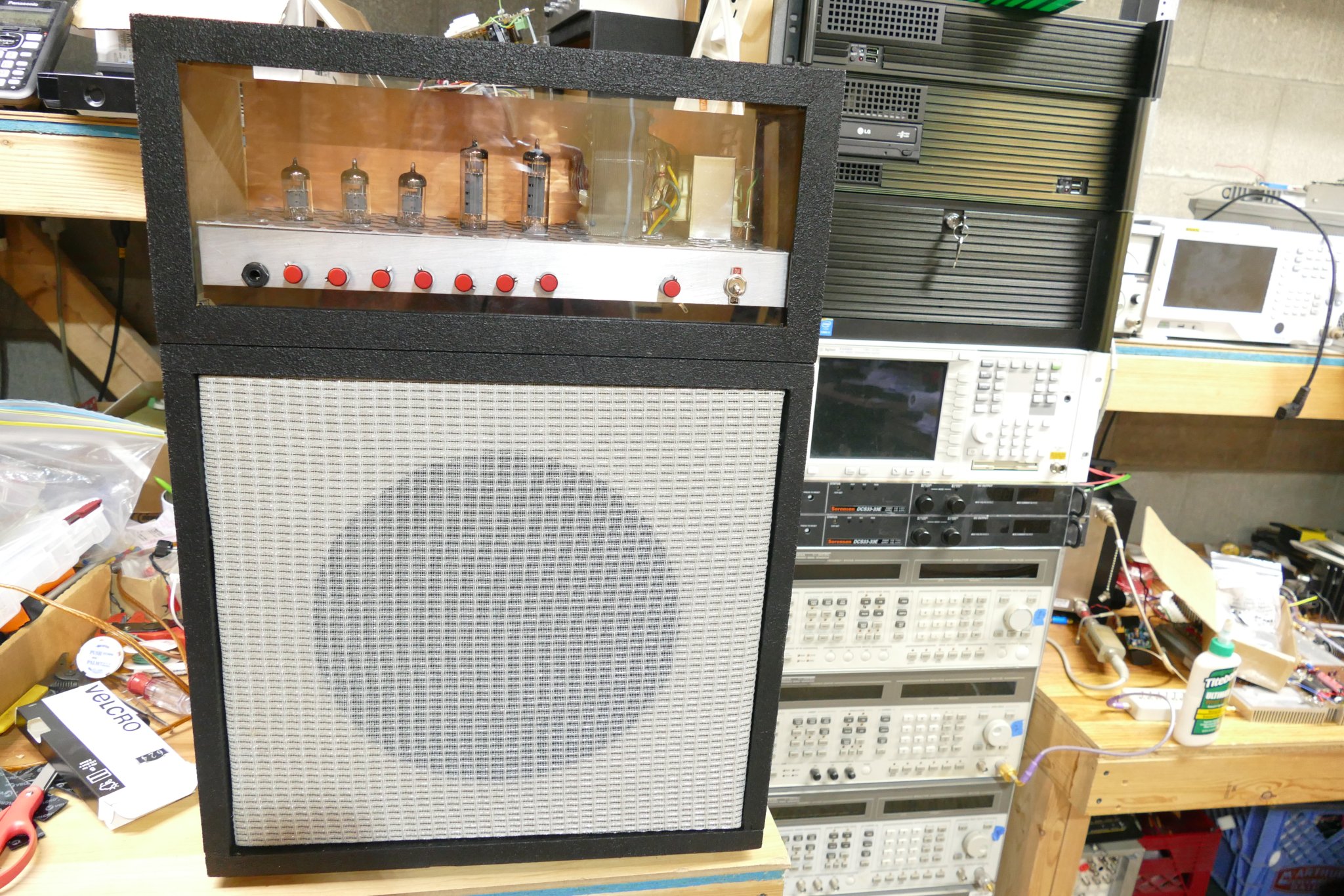

A tube amp in the 30-40W range for $200? Doable, yes. Remember that the original HBAC rules just counted the electrical parts, the cabinet, chassis and speaker were not included in the total price. Hijack this thread, No, I won't mention it again here.

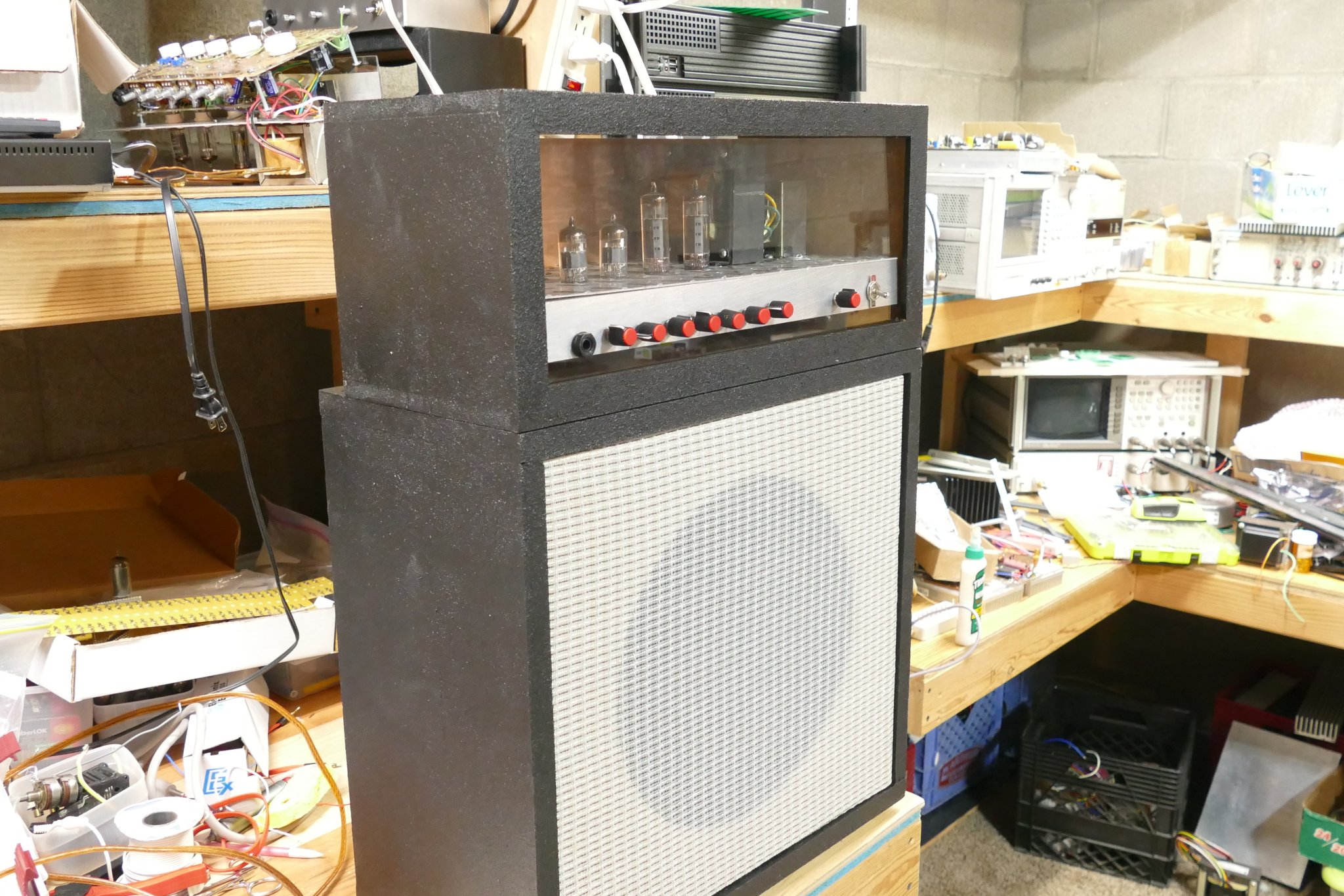

The amp head in the picture was built for the original Hundred Buck Amp Challenge. It squeezed in just under $100 and made about 20 watts. The lone knob on the far right is a Parts Express attenuator to let the amp play at full crank without upsetting the neighbors. 20 watts was loud through the 4 X 12 cabinets that I had at the time. When the amp was built, it used an Antek power toroid for the OPT it worked pretty good but resulted in about 17 watts of power. I had stolen that transformer for another project, and the amp went dark for over 10 years. I decided that I needed a new guitar amp, so I slapped a real guitar amp OPT in that amp and fired it up. Some of the pots are bad, but it works well and gets plenty loud with a single 12 inch speaker.Oh oh, had an idea. Memories of the 100 buck challenge coming back. A tube amp in the 30-40W range for $200? Is it doable? Just kidding, do not want to hijack the thread.
