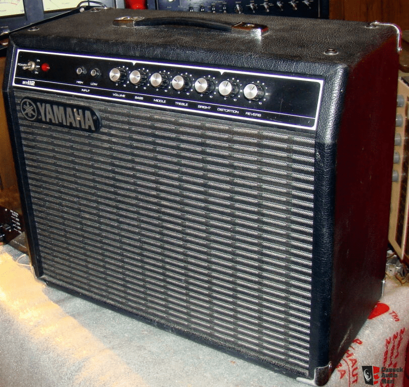

anyone but me remember these... with the built in distortion!!
i'd copy the output stage of a G 100, common TO3 transistors outputs as i recall should be dead simple.
