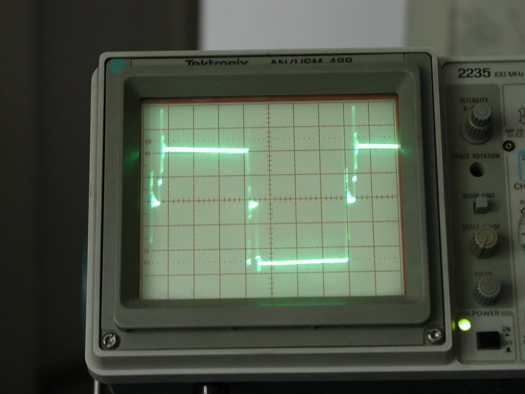

I mean Bmax here. For Amidon F power ferrite Bsat = 4700 Gauss (at 10 Oer.) So I don`t wont to operate close to this value...
So noise & spikes in output voltage are impossible to avoid ?
Output voltage can be seen on screenshots, I marked with red color what I mean.
I`ll try to add snubbers across secondary to eliminate these spikes .

GUYS, can you to share some of you screenshots from well loaded SMPS trafo`s primary, & output voltage please ?

At 30-50kHz, a 4T + 4T primary is usually OK. For your B value of 2000G, is this your B(max) or B(sat)? B(max) is the number you want to work with for calculating under normal operating, and B(sat) is the never-to-exceed value (this is essentially the point of core saturation).

Waveforms look pretty good.

Yes I did, on smaller one(300w, probably limited by other smps, which has ~12.5v on output at that time), but that was regulated, on big one I don't have nor for input nor for output.
Like I said aim for freq around 30kHz or lower, and from what I can see, your snubbers aren't good enough and you probably have big dead time...less dead time will (I think) result in less oscilations...but I would fix snubbers first.

Luka,
The formula that I used:
..................(2/Fsw)*Dmax*(Vin min - Vds on)
N turns = ------------------------------------------- *10^6
...........................Acore*Bmax*2
whwre: Fsw in Hz
Dmax for single pulse (</= 50%)
Acore in cm^2
Bmax in Gauss
So I used 2000 Gauss from zero to Bmax to get number of primary turns... Is I should to use value from Bmin to Bmax (4000 Gauss) here ?
Yepp, I didn`t setted up snubber yet, just placed it to see is it able to help. Now I got sweet set of multilayer ceramic caps, so next weekend I`ll play around fixing snuber. Else I think to rewind trafo`s secondary with 2 18AWG wires instead 1 18AWG...
I mean from zero to Bmax.What value do you have and from where to where?

About output spikes:
Be quite careful, what you see on the scope may not be there. Short the scope probe ground lead to the probe input. Lay the probe near where you measure the spikes. If the spikes are still there, then the scope probe cable or scope AC power cord is acting as an antenna. The scope is displaying a signal that's not present in the conventional sense across the probe/ground input.

I mean sunubbers...ok anyway just tried my again, 12.2v in ta CT, 87.7v out @ 230w
Pri
sec
3x1mm, 6 turns for pri, 1x1mm, unknown turns for sec, I guess about 23... it is a bit odd I did get 300w but I not sure it with this core setup, and a bit big dead time for my taste, lol don't know how that happened...any pic are here

I`ll try to check my scope as you suggested, but I`m not sure that original 200MHz Tektronix probes are good antennas. Will see.
Luka,
Thank`s so much for the pics. Now I have an axample of what I should to get. It`s seems to be that Tektronix scopes are DIYer`s favorite choise.🙂

Seems to be that I found solution for regulated version of my SMPS🙂 🙂 🙂 . I added inductor between diode bridges & output caps, & placed the transisent voltage supressors across primary windings. See cshematic.
The result: output voltage absolutley flat
, without any spikes, glitches and other garbage 😀

First I played around output inductor. I inded 2 different inductors - first about 2x24 turns of 18AWG wire on toroid extracted from old PC SMPS, second winded on ferrite torroid from http://www.tscinternational.com/tscwebcat2007.html , material- ASTM P7070, size OD25mm ID 16mm H8mm , Al = 1724. It contain 2x17 turns of 18AWG wire - i`ts around 50uH.
With first, PC inductor , SMPS produsing some acustical noise when loaded. At 210W load, noise louder than at 320W. MOSFETS are cool without heatsinks even at maximal load.
With second inductor (50uH) there are almost no noise, but MOSFET`s are became very hot
within seconds at 210-320W load. 😕
Without inductor , regulated SMPS - output voltage full of big spikes, 2 MOSFET`s are destroyed by overheating
Anybody can to explain me a nature of the process above please - why heat dissipaton on MOSFET`S is so different ??? How to calcuate the exect value of output inductor ?
Generally, after adding inductor, the output voltage became almost ideal, just very small, almost invisible spikes were occured.
After adding the transisent voltage supressors , output voltage became absolutley clean and flat 🙂

As Herman mentoined the probes of the scope are able to catch EMI from SMPS... Very possible. I cheked my probes in several differet ways - placed near loaded SMPS, connected ground only to MOSFET`s drains , etc. Yes, probes are able to catch some RF EMI, but the original 200MHz Tektronix probes are very poor antenas
😉 The spikes at output were here, these disappeared after I added the inductor, not after I replaced my probes with GHz rated, $500...700 set.🙂

Hi Luka,
I tried this way, result is in post above.
Whats wrong in using diffrencial mode inductor ?
Do yo know from wich material made cores of PC`s SMPS output inductors ? Is it iron powder ?
Yes, such way my SMPS working fine.Ps: from what I can tell from pic, you have it in diffrencial mode, flux cancels itself out,
I use 2 wires in same direction, and cross one end of the wires so that you have looking from above

Hi Luka,
Yes, if inductor connected in differential mode everything is just great 😀 Transformer, inductor, all of semiconductors are running cool without heatsinks at any power. Its more than important in my country, where summer is so damn hot
. I think that if inductor connected in differential mode, it acting as impedance between trafo + MOSFET`s to output caps + load. It saving output caps & MOSFETS from high current stress during MOSFETS turning on (front of each pulse). I think it making SMPS less effective, but I think that better to loose several % of effectiveness, than add more MOSFET`s, large & expensive heatsinks, cooling fans etc.😉
Try differential mode inductor yourself, may be you will like it 😉
Else I found good sourse of cores for output inductor - https://www.amidoncorp.com/items/36 These toroids are the same as used in PC`s SMPS, so I`m going to order a couple larger ones. These should to be very good for output chokes.
