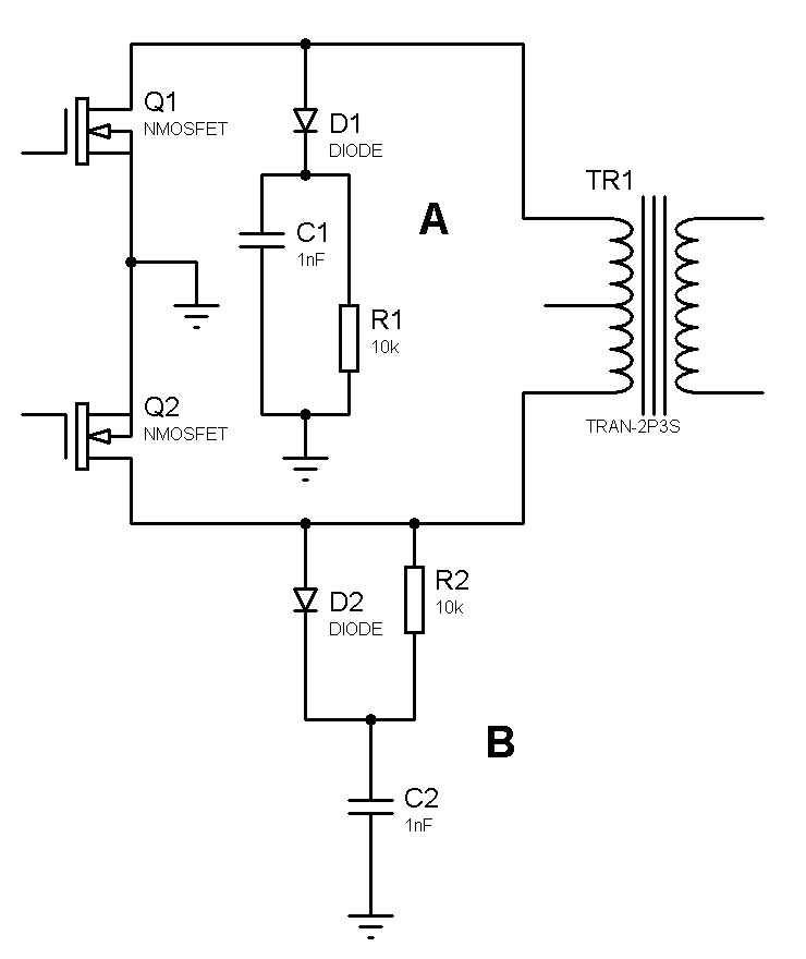

Nothing serious. You will need to make the RC filter anyway, and most probably inject a little bit of slope compensation with it.But here is new problem came - spikes in current ramp. I did`n tried yet to manage these with RC filter, but pleasure from inductor tests was some broken
Well, you didnt really thought that a punny 22R in series with 1nF can be really considered as "snubber" for 50KHz 300W power stage, did you? I bet that you may run the circuit again at 50KHz with those removed. The drain spike will increase ~15-25V. I have no physical explanation as to why things suddently became "worce". The heavy high voltage ringing on the drains at turn-off is something i am very used to. not to have it-thats suspisious. You may revert to RCD dampers. Those will be most effective in controlling the overshoots.I replaced them with 0.047uF small red polypropylene caps. The ringing was reduced, but 6.9R resistors connected to caps became VERY hot.
Well, measure the efficiency and the heat generated. Then decide.I think that if I`m operating at 50..100KHz, 18AWG wire is not the best choice for trafo... First - due to skin effect, second the windings that made of thin wire should to provide better coupling - less L leakage, & less reigning... Is it such ? Is 20..22AWG wire will be good here ?
Oh, and you should consider placing the GND line on the scope display lower. A one division above the lower end is the best, i would suggest. Now, as you did, important information on the drain spike was lost.

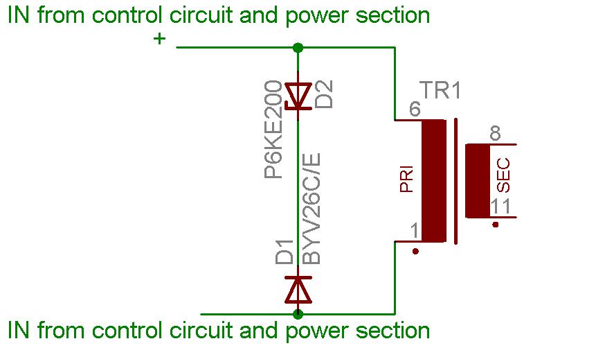

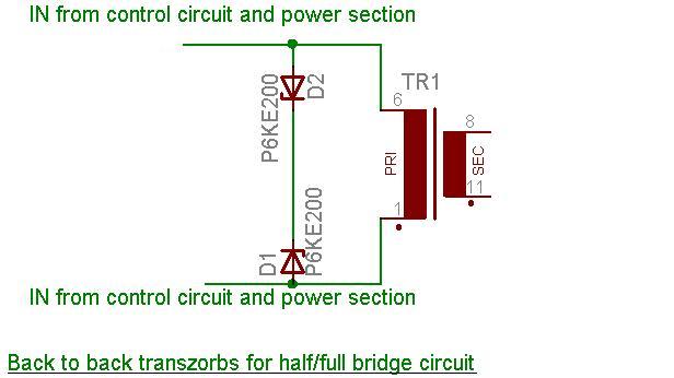

RC Snubbers are not recommended at 100khz at high voltage. In high frequency, high voltage, you better use ultrafast diode and transient voltage suppressor (transzorb/transil). You can try with BYV26C/E or UF4007 diode and P6KE200 or BZW06-188 transzorb. It will work much better than an RC snubber in high frequency, high voltage operation.

Are you sure that 209V acting TRANSIL will be good for damping of 30..50V overshots ?
Hi Tolik,
30-50 overshots?
This circuit is to suppress transients over 200v even in the range of kilo volts and is to be connected across the primary of the transformer. If your design is half-bridge or full bridge, you should use 2 back to back transzorbs.
I do not quite understand why you are talking about 30-50v overshots as spikes here would be >200v. But if you need to suppress 30-50v spikes, P6KE30 and P6KE51 are available.
Since transients will be suppressed at the primary, no significant spikes would be produced at the output.
