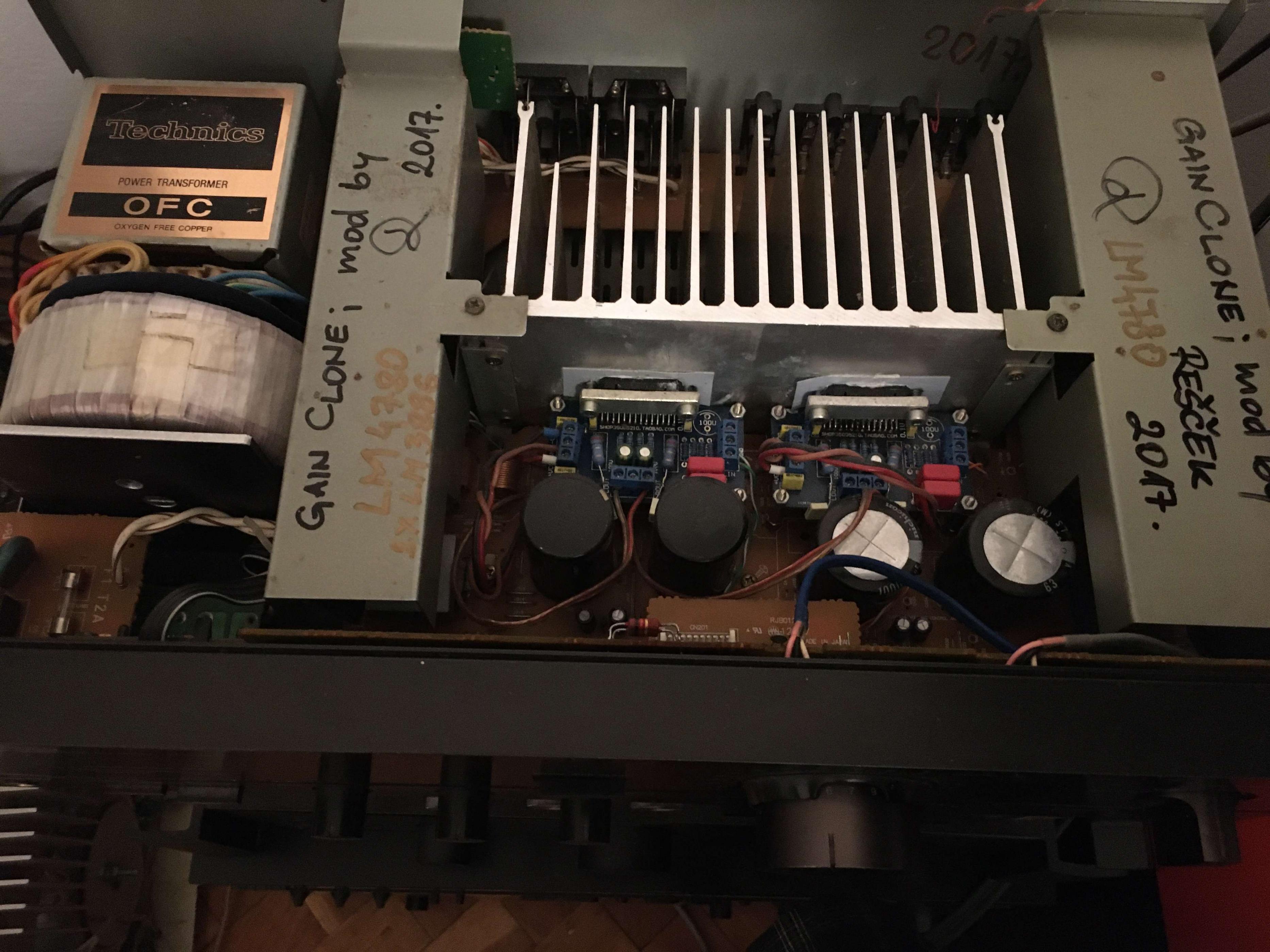

As I mentioned, I have 3 builds, one is in old Technics amp (as replacement of the burned amp IC) 2x LM4780 parallel, now is at my home because of some switch replacement (build for my friend) and I will take some pictures and show you. 10kohm will be OK, lower value of the resistance is good, but your preamp should be capable of driving it. I use opamp LM4562 as preamp.

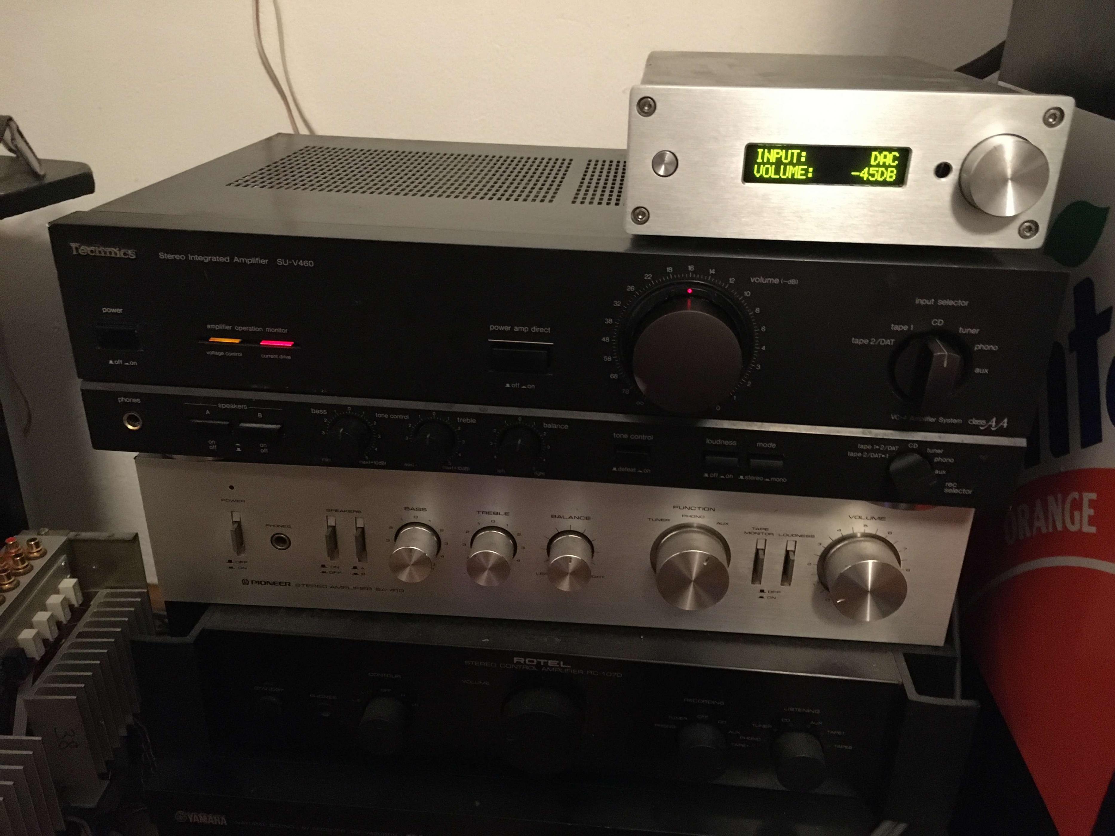

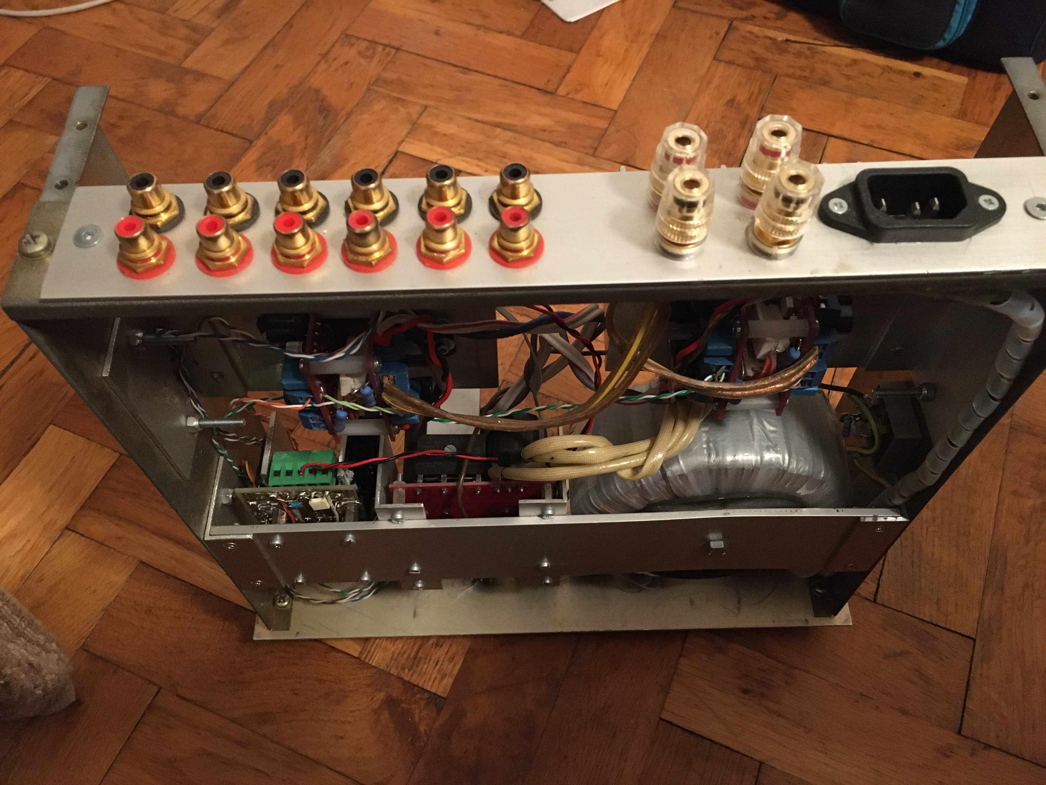

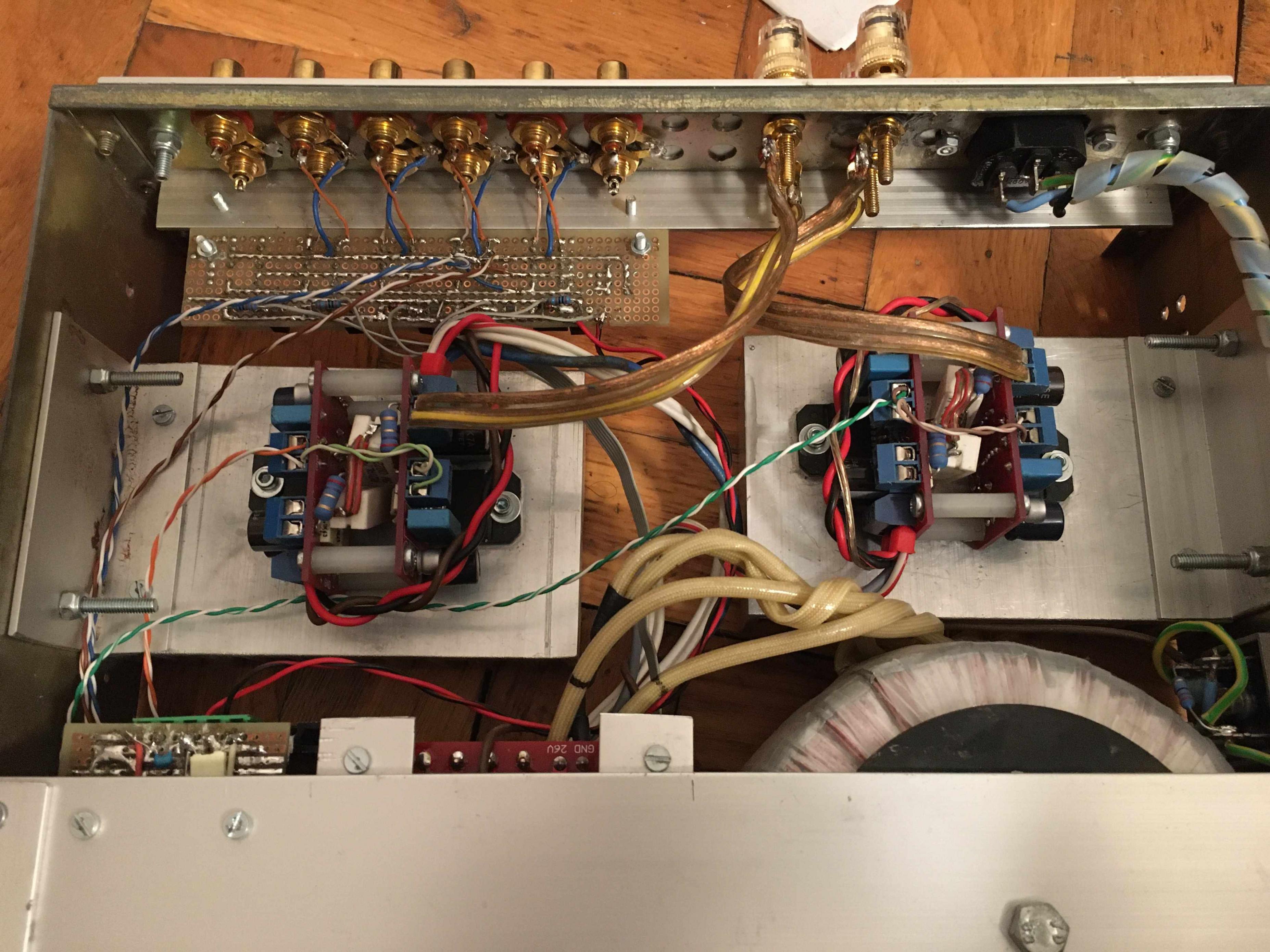

These pictures are my work, name of files describe it.
AMP pictures shows how twisted pair wires are placed inside the case. I showed these pictures because I don't have some final work. They are from still development phase (I wrote that these will not be published).
Preamp is based on X-Altra Mini One Line premplifier from hifi sonix.
And here is outside picture of my GainClone case (it's not recent), dual mono config with parallel LM4780. Today's picture I don't have, but when it will be returned I will make them.

Nice work on the technics, you added a toroidal ?, it must weight a ton now ;D
Your heatsink in LM3886 project seem insufecient though, you bridged them, im curious of the schematic, where you get that bridge config ?
Thank you for the fotos.
AudioTag, in Technics both channels work in parallel, not bridged, my goal was to achieve more current on the output for low ohmic loudspeakers (4 ohm) on relatively high voltage for this amp (+/- 36V without regulation, under load it will be little lower). Similar concept to your triple parallel config which is a bit better. I didn't fully understand why you have two amps with two VUs on the front, is it stereo combination, or parallel/bridge. My logic says that there are two stereo with 3 ICs in parallel in one case.
Torodial transformer in this amp doesn't serve as main transformer, original Technics serves for it. Torodial is here to lower primary voltage on primary of the Technics transormer, it is in autotransformer connection. So toroid transformer doesn't have equal power like Technics, it has nominal current of the Technics primary current at the secondary side wich lowers the primary voltage of the Technics transf. This amp has about +/-45Vdc which is too high for the GainCard amp. Minimal invasion was done inside of Technics case, everything is adopted to replace original IC and AA clas in the output stage and results are estonish good. For the control of the output relay it is incorporated uPC1237 circuit to switch the output relay and monitor DC output.

The ics on the technics are LM3886 ? seems like other ones, LM 4780 ?
The bridge config i was mentioning is on the foto named AMP_Gainclone2cr.jpg

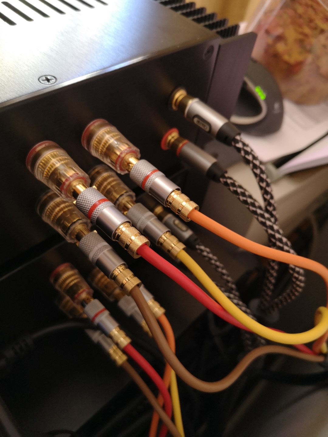

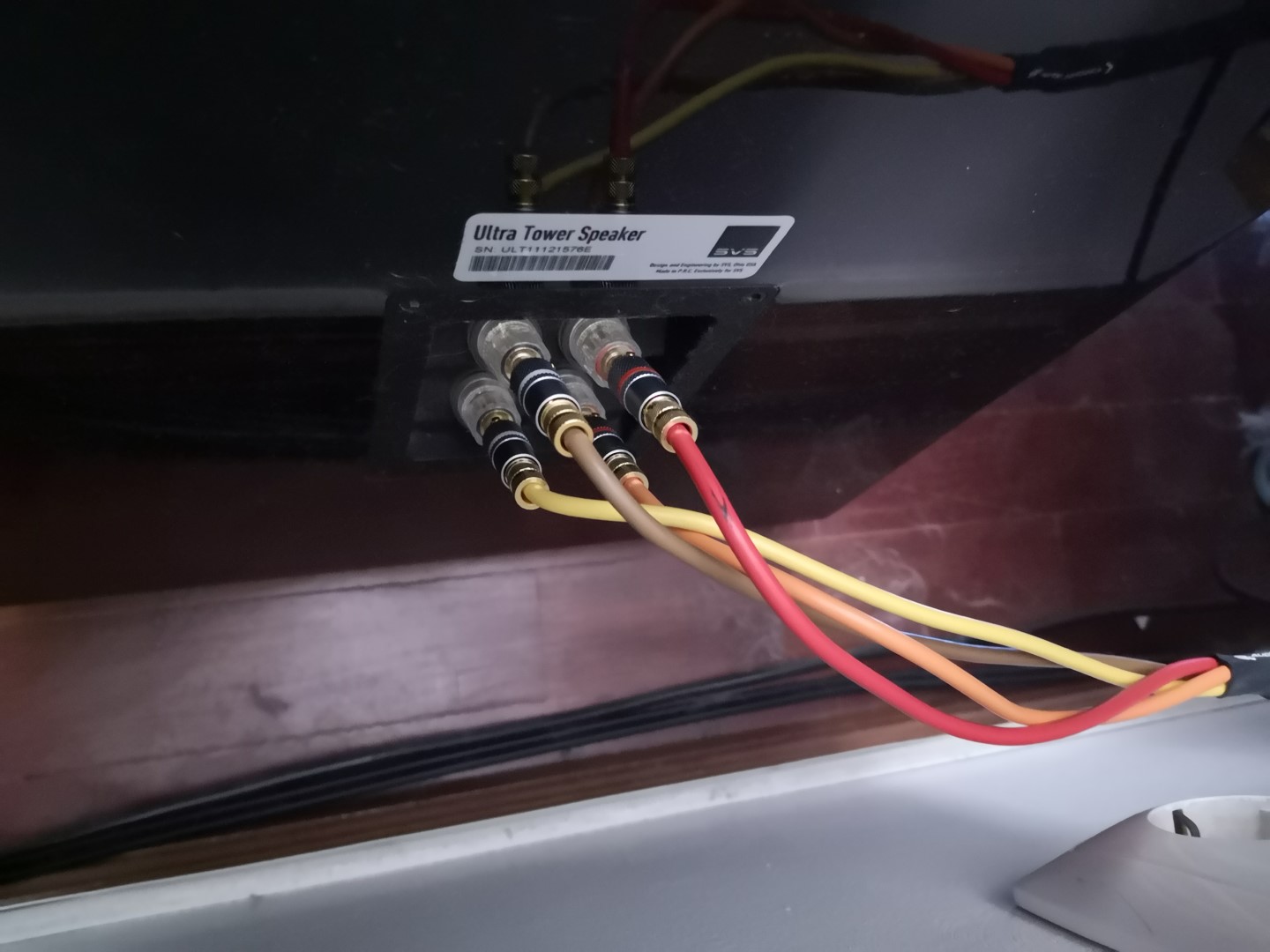

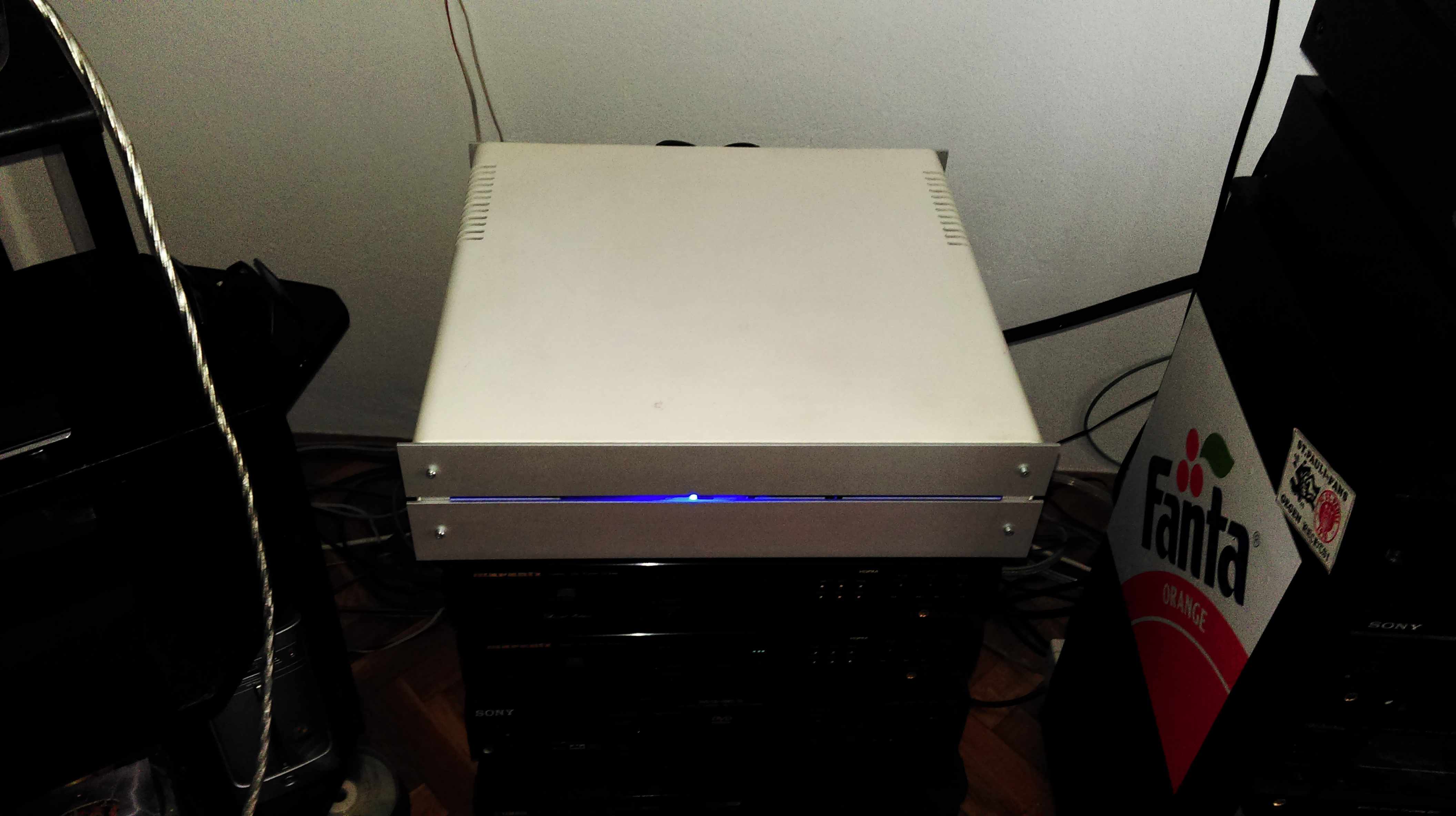

Answering your doubt about my system:
I have a pair of bi-amp capable speakers that need a good amount of power, The SVS Ultra Towers. so i use an amplifier for each speaker. 2 modules of 3 x LM3886 for each speaker. I can use the amplifiers for stereo independently but i chosen this bi-amp config because i needed more power.
See pics of cables, of course the vu meters measure equal because i use one channel for each amp.
As you know LM4870 are 2xLM3886 in one case.
On AMP pictures there are 2 modules of LM3886 in parallel also.
I prefer parallel combo more then bridge as described before, more current on the output (2x11A peak).
Heatsink should be OK for that use.
My modules are cheap one and I should upgrade it with some zoebel circuit on each chip and added output resistor for parallel operation. As you can see between two modules are resistors and zoebel, wire for parallel connection so speaker output is taken from one module.
Twisted pair is between two inputs but not connected ground wire on one side, usually output side, because there are ground wires for the power and easily ground loop is possible.

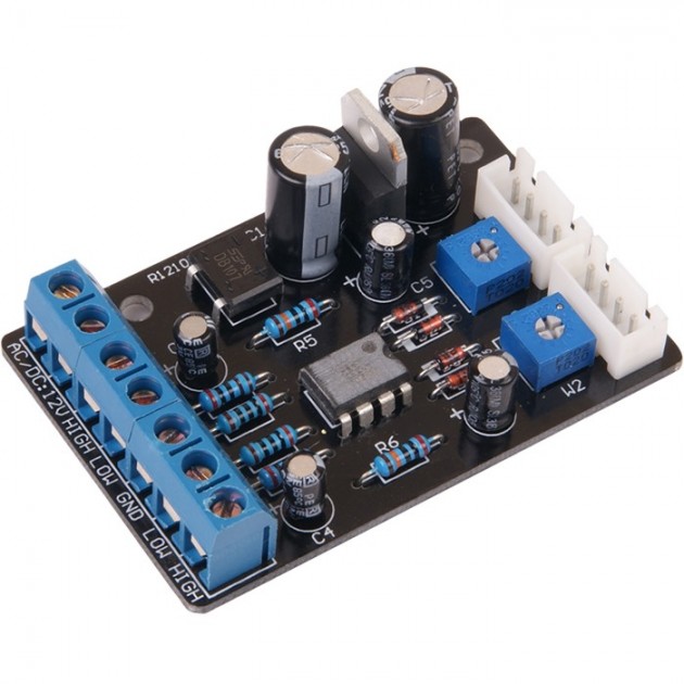

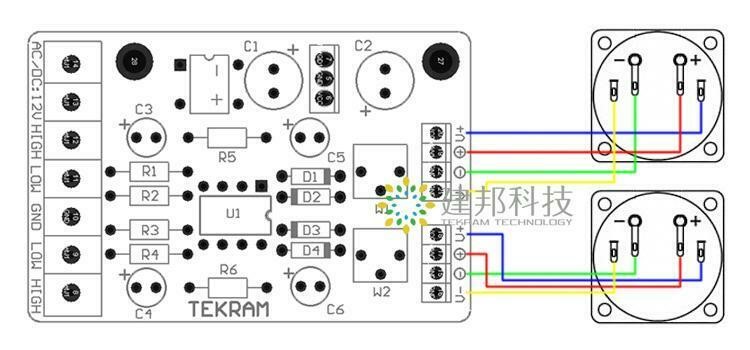

Yes i would like to learn how to calibrate the vu meters accordingly to DB. This vu meter can work in ac or dc 12v to 15v, I’m wearing a AC led transformer to power the vu meter controller that powers the vu meters the backlight leds also
I send you some pictures and schematic attached.
① LOW, GND, LOW: It is the driver board’s Low-level signal input terminal, you can connect it to CD Player/PC sound card/preamp, etc, audio signal ,LOW、GND、LOW Corresponding to: left channel 、GND、right channel (Adjusting two Potentiometer to control the pointer swing.if it with full Signal but the pointer swing not reach your expectation or the Volume change to lower or distortion,you can move R2、R3 resistor)
②HIGH、GND、HIGH:
It is the driver board’s high-level signal input terminal,you can connect it to the signal via amplifier,the two HIGH terminal corresponding to amplifier’s two RED terminal, GND corresponding to one of the black amplifier terminal.
2.Driver board output:
V+, V-, Terminal: It is the backlight,support 2 set 12v backlight terminal,when connecting pls note the positive or negative electrode
+,-,Terminal: it is the driver board’s output terminal ,connect it to VU meter’s “+”“-”
3.Power supply
Woking voltage:AC/DC 12-15V (we recommend adopting the independant power supply)
Huh, I thought on direct current pass on input of your low/high signal.
As I can see it is probably DC blocked, so we can't do simple adjust by internal power supply of the amplifier with simple connection to power supply rail. If it is not DC blocked, if you connect input wire to positive rail it will show something and it will remain on some value. After that adjust the value between +3 and +6dB.
Your VU should show 0dB when you reach full RMS power. The VU meter works by input voltage, so you need to put peak voltage to the input and adjust the level accordingly.
You have your reference GND which is common for both channels (maybe best place to take single GND from power supply board for the VU board). If I understood correctly you have separate transformer for supply of the VU board, which is good, so you can't mess up with grounds.
Amplifier is capable of delivering peak power which is +3dB, when it is? when amp output reaches near maximum of your + or - V of your amplifier power supply.
Short time connection to positive or negative rail voltage should simulate pulse (or some ac signal) on your input which will be shown by VU, needle should go between +3dB and +6dB, adjust your potentiometer to show value between these numbers (better closer to +3dB).
Second option; I assume that you don't have dummy resistor of 8ohm/100W, so I don recommend adjustment by sinus signal below 400Hz and measuring RMS signal on output according to the supply voltage (when you do that way you should calculate maximum RMS voltage, positive rail voltage measured by voltmeter-approximately 2V and then divided by square root of 2, then you have RMS value which is equal your RMS power which is possible to measure by the measuring instrument-DVM). For this last task you should have audio generator (or android phone with app) and enough mV (or 1V) on output of your preamp, to achieve maximum power on output of your amp, when you achieve this, you can adjust your VU to 0dB. This measurement shouldn't be long, because amp is not generator for delivering energy, 15-30 seconds what is enough to adjust VU per channel.
Hope that first option isn't complicated, so with short connection of VU high input wire to positive or negative rail of power amp supply will help to adjust the VU. Do that channel by channel.

Sangram, you are missed somethnig, where is current input on that VU driver board, I see only voltage input, which are insufficient for power measuring.
VU meter driver board may have logharitmic scale to drive properly needle on instrument, so your comment is not adequate.
Calibrating with lower voltage level asks for some calculation. AudioTag will tell us is he ready for such thing.
Maybe it is difficult to understand what I wrote, but this is simplest way to adjust measuring equal to what amplifier can do.
Whitout knowing what is power supply voltage you can't have proper indication.
Is the dB scale equal for voltage reference, or for power reference? Think about it.
What is your reference wattage of this amp?
What is your reference voltage for this amp?
How you calculate dB for voltage and how you calculate for power?
Or you will assume -10% as reference output voltage (taking into lower value of voltage because of transistor Vce drop and possible ripple due high load) for lowest power gridvoltage and then calculate, but you need to take into account how much is higher or lower ac voltage on your transformer.
For your case with lower value it is possible to implement my second method, but you need the calculate what is voltage on the output which will show proper dB.
