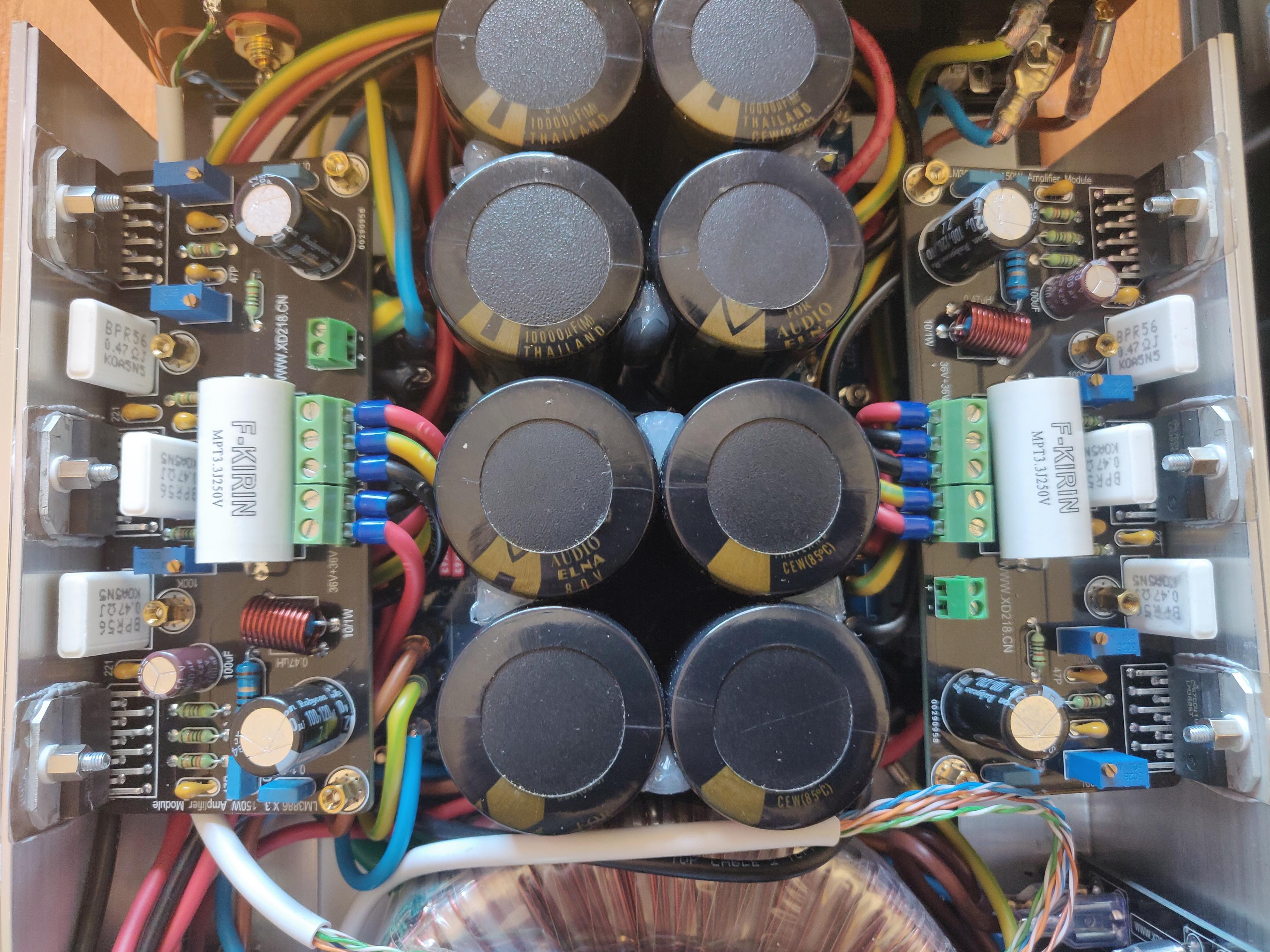

Thank you, i was about to remove all the capacitors in my build 😀, hehe.
joking, i have 4 Elna 80V 10000uf capacitors for each amp module, you think its enouth or to much ? 🙄

@AudioTag,
OK, I understand that you are using one pair for the signal and other one for VU input, but I see that you put it orange (orange and orange/white together) for let say minus and blue (blue and blue/white together) for signal, that is not correct, so you don't have twisted pair which eliminates unwanted noise. Twisted pair means blue for signal and blue/white for GND of the signal. At your second attempt, signal wires are also too close to the transformer and you pick the 50Hz noise. Put it at least 5cm from transformer (also signals for the VU).
Did you take measures against ground loop (you have one transformer, one rectifier and common ground for both amplifiers)?
I have 3 builds with lm3886 in parallel, I will say that sound is very good, there is no need to build something else.
AudioTag, resolve the wires for the input and you'll be surprised with sound details and quality. It has enough power with 3 chips in parallel for low ohm speakers (4 ohm, impedance may fall below that when music is playing).
This combination with unregulated power supply +/-36V will give you about 120W/4ohm, so it is well enough for home.
@AudioTag,
Greetings Pitbul.
I will rewire my input cables acording to your advice and as far from possible from transformer, thank you for the advise.
As concerning to groundloops i simply dont use ground in my stereo devices, because all my AC network is coming from a isolation/ galvanic Transformer 220v - 220V. that was the only way to eliminate ground loops forever, i had that issue even b4 building this amplifiers.

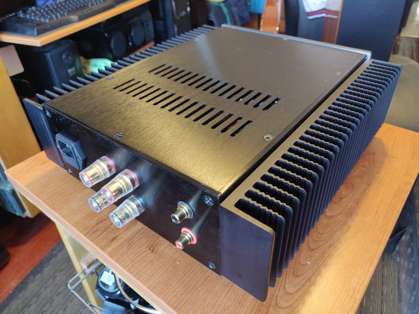

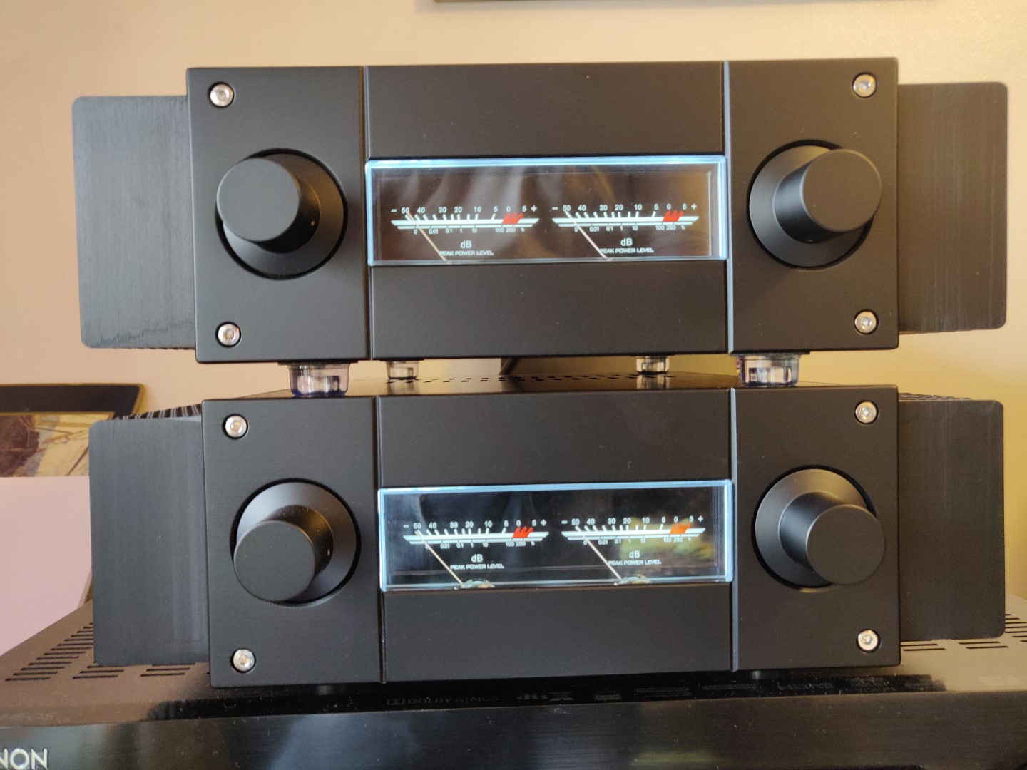

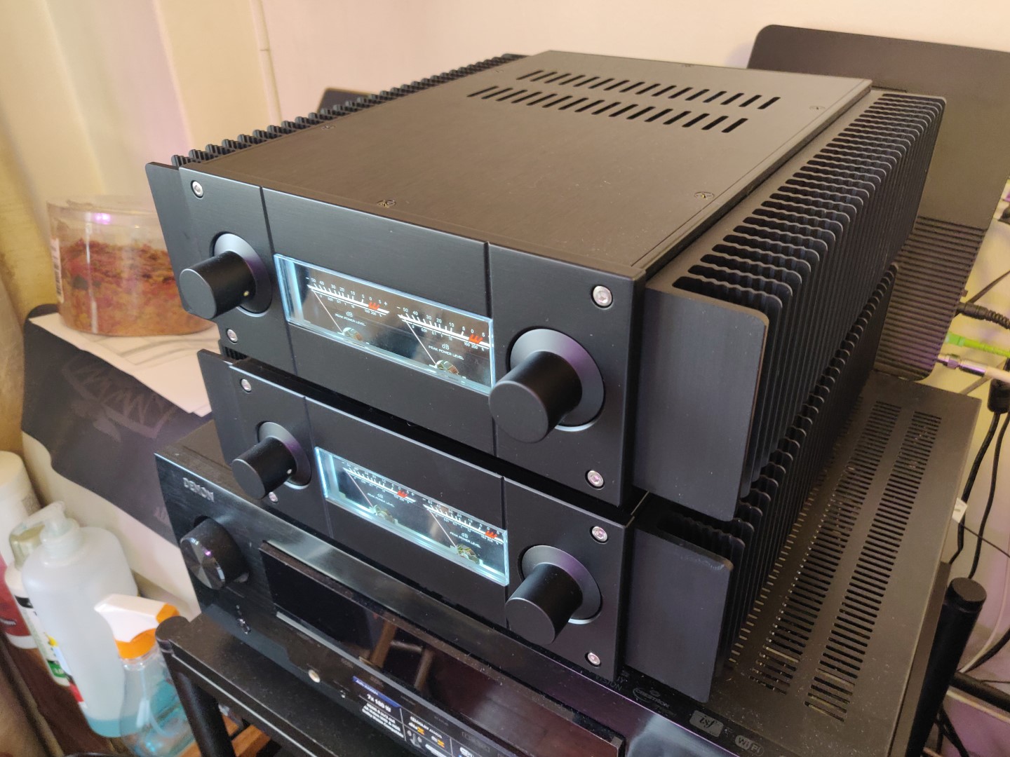

great job with the enclosures Audi tag,looks proper professional job..
Hi BrodJack.
Thank you very much, i tried to make it as nice as possible, you think it looks better with the heat sink or without ?
I was thinking on ground loops inside the amplifier case. If you have hum try to lift ground on one side of channel input wire, leave only one ground to the inputs of the amplifiers (if chinch common is interconnected on inputs). Also you have VU meter driver circuit, you should be careful about ground signal on that circuit, only one reference wire should be.
