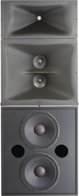

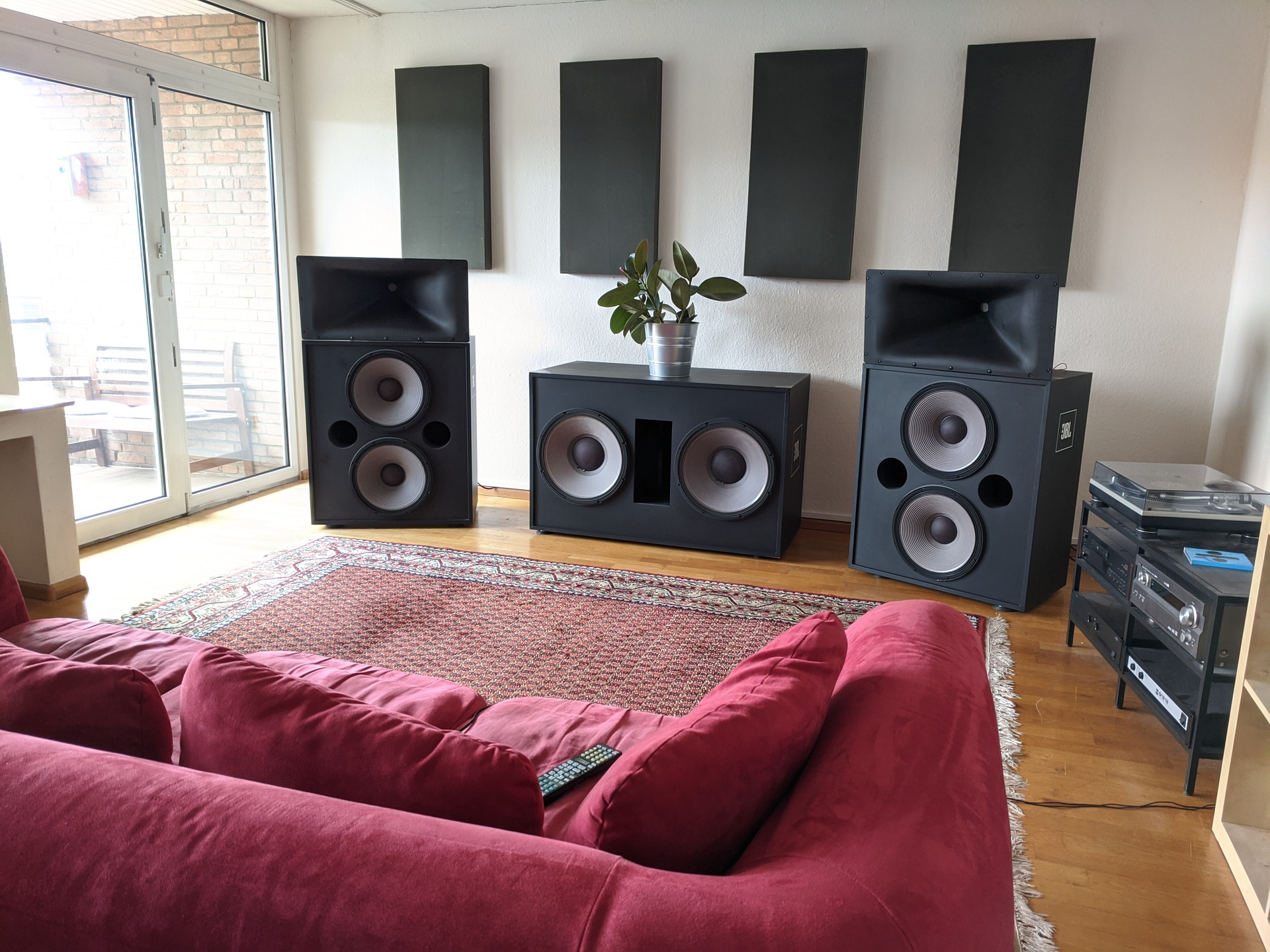

If you want a more modern sound than the old Altec, the big JBL Cinema systems like the 4722 are also very good sounding and look impressive. Especially if you combine them with the massive 4642A subs that JBL sells with it. This is a home setup picture from the internet. These are build to fill big spaces with good sound, not only a sweetspot and they do work.
Making this your system will attrackt people, as JBL is still a big name and the look appeals to many. But most listening bars lean on old designs like from Tannoy and Kiplish, that are not neutral or low distortion, but live on hype... If i would do it, would use JBL cinema rig like this, but adapted to the space i have. Or if i do it diy (not so easy, name brand of system is also a customer attracking facrtor and they will sound a lot better than any Tannoy or Kiplishhorn will.
The old Altec Lansing VOTT is also a good id, but it has a certain oldskool sound that does not fit everyone and i would not call it hifi. It's good sounding lofi (hifi from the prehistory), not hifi in a modern sense of the word. But in Japan (where listening bars started) it's still that kind of old systems or variations of it that rule listening bars. Older JBL systems are also popular, Bust Western Electric or Altec Lansing are magical names there.

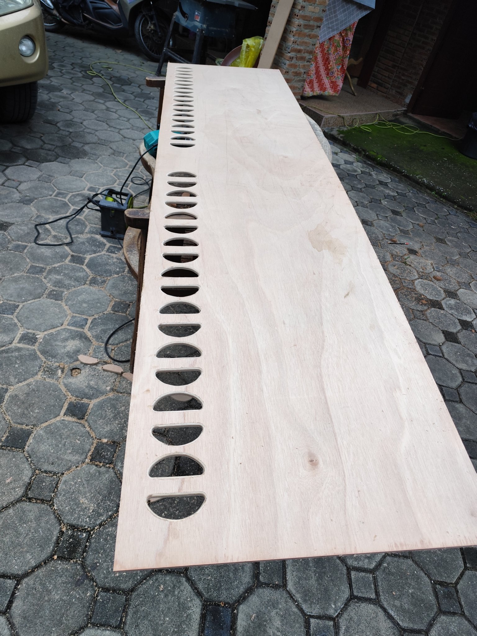

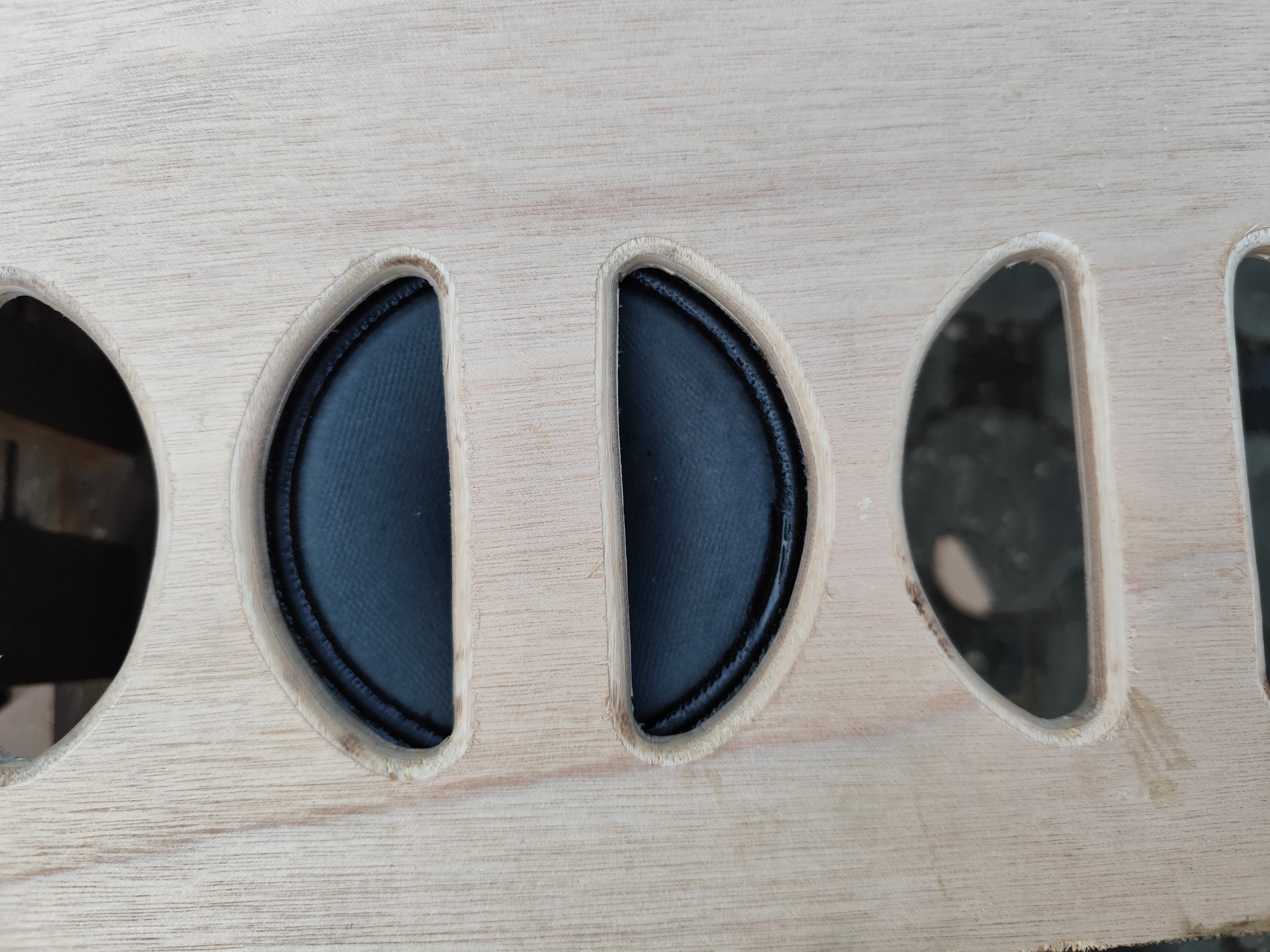

UPDATE:
I have a system figured out and started cutting wood.
The envisioned room will be 8x24x3 meter. There will be 5x straight open baffle line arrays in the center of the room creating two 8x12m listening spaces.
Each line array has 6x15" woofers, 18x4.7" vintage alnico fr drivers and a ESS heil AMT 1 tweeter.
The digital source will go in to a miniDSP flex 8 which will handle crossovers, eq and room correction. The MiniDSP will feed 3x Schiit Syn surround pre amps that have analog circuitry to create 5.1 surround from a stereo RCA input signal and have controls to effect how the signals are routed and can switch between stereo and 5.1 on the fly.
So when it is not busy and there is enough sweet spot space available for customers I can run 2 speaker stereo. When it gets busier I can switch to using 5 speakers.
