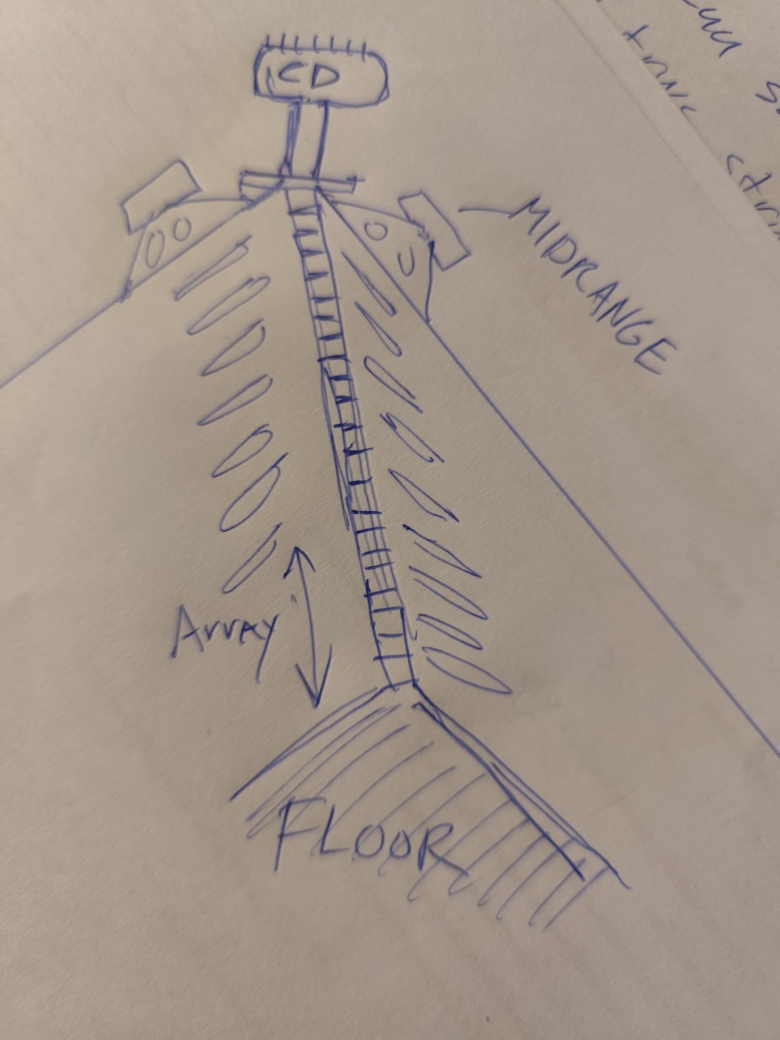

Most ideal speaker for uniform coverage is a corner line array. Should have the widest "sweet spot due to both even dispersion and slower volume decrease per distance doubling. So not being equal distance from both speakers has less L/R volume difference.
Have a flat ceiling....best for maintaining cylindrical line array wave. Make a triangle piece of ceiling and floor in the speaker corners reflective to help extend the virtual line array. I may even actually make it a mirror.....would be a cool visual......seeing the line going into the floor and ceiling to infinity.
I can build the room with a recessed corners so drivers can sit behind the wall/corner so the speaker is not in the corner but in the wall in the corner.

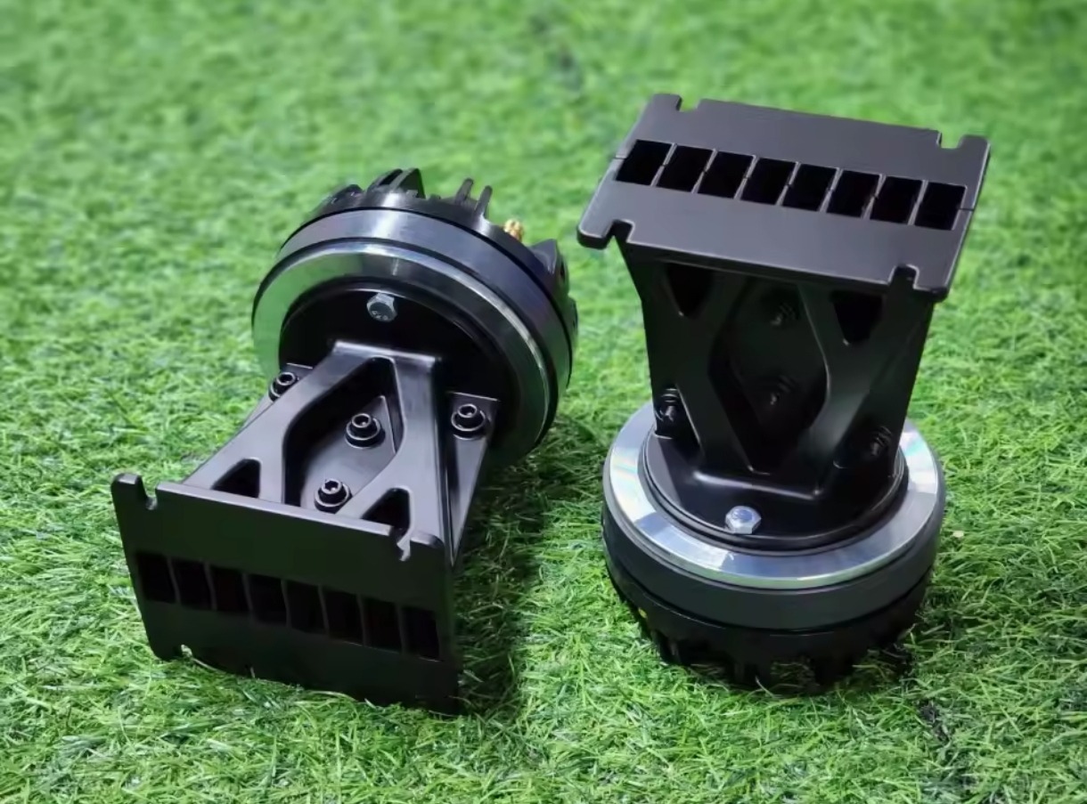

As much as I like to stack 20 heil AMT's that would gobble up too much budget. I am now toying with the idea of a corner loaded line array synergy horn. Wall to ceiling line array compression driver manifolds exiting exactly in the room corner with midrange and woofer holes at appropriate 1/4 wave distances also from floor to ceiling. Should cost a quarter or less than using Heils. If the bar is a raging success I can always upgrade.

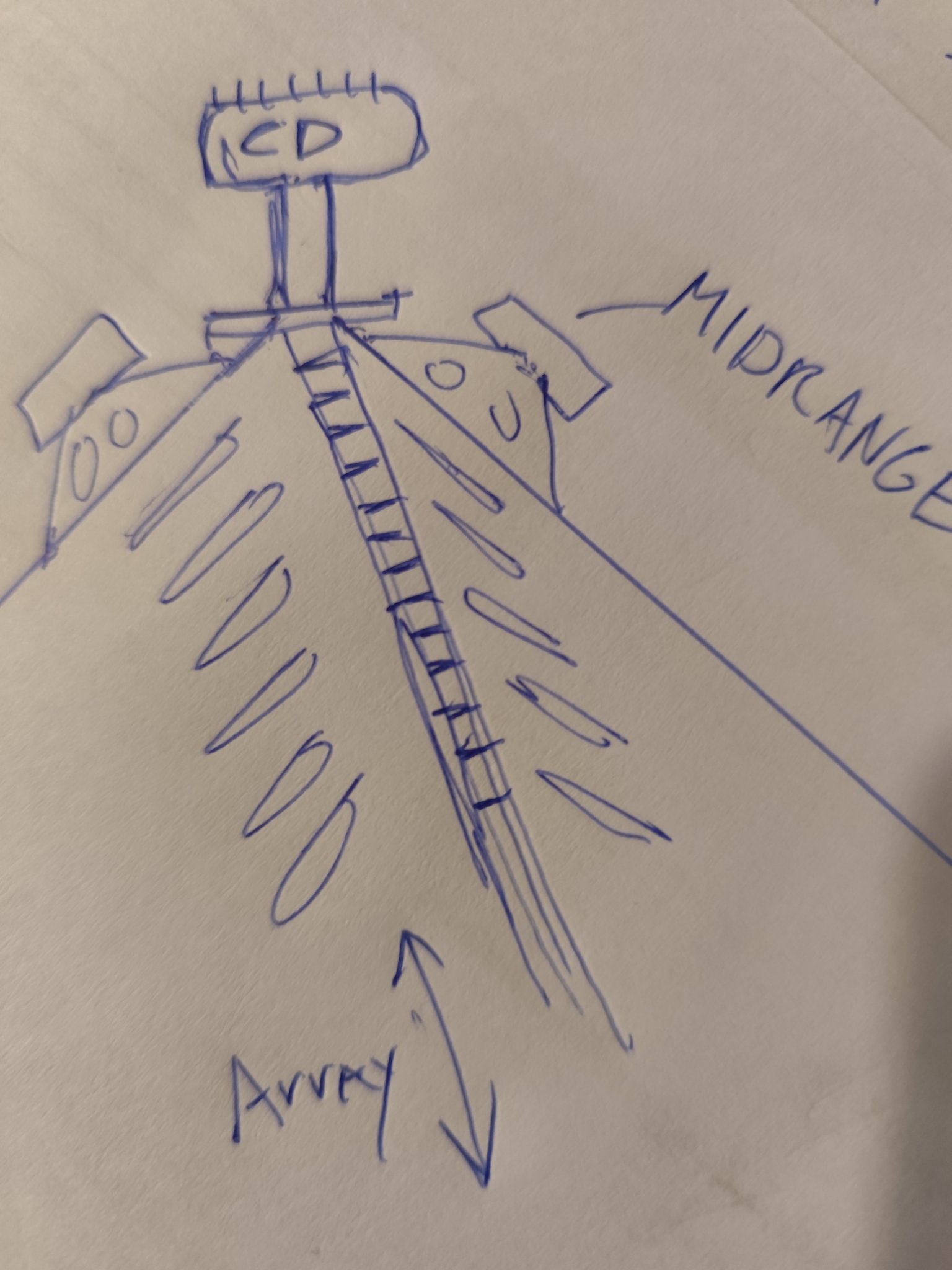

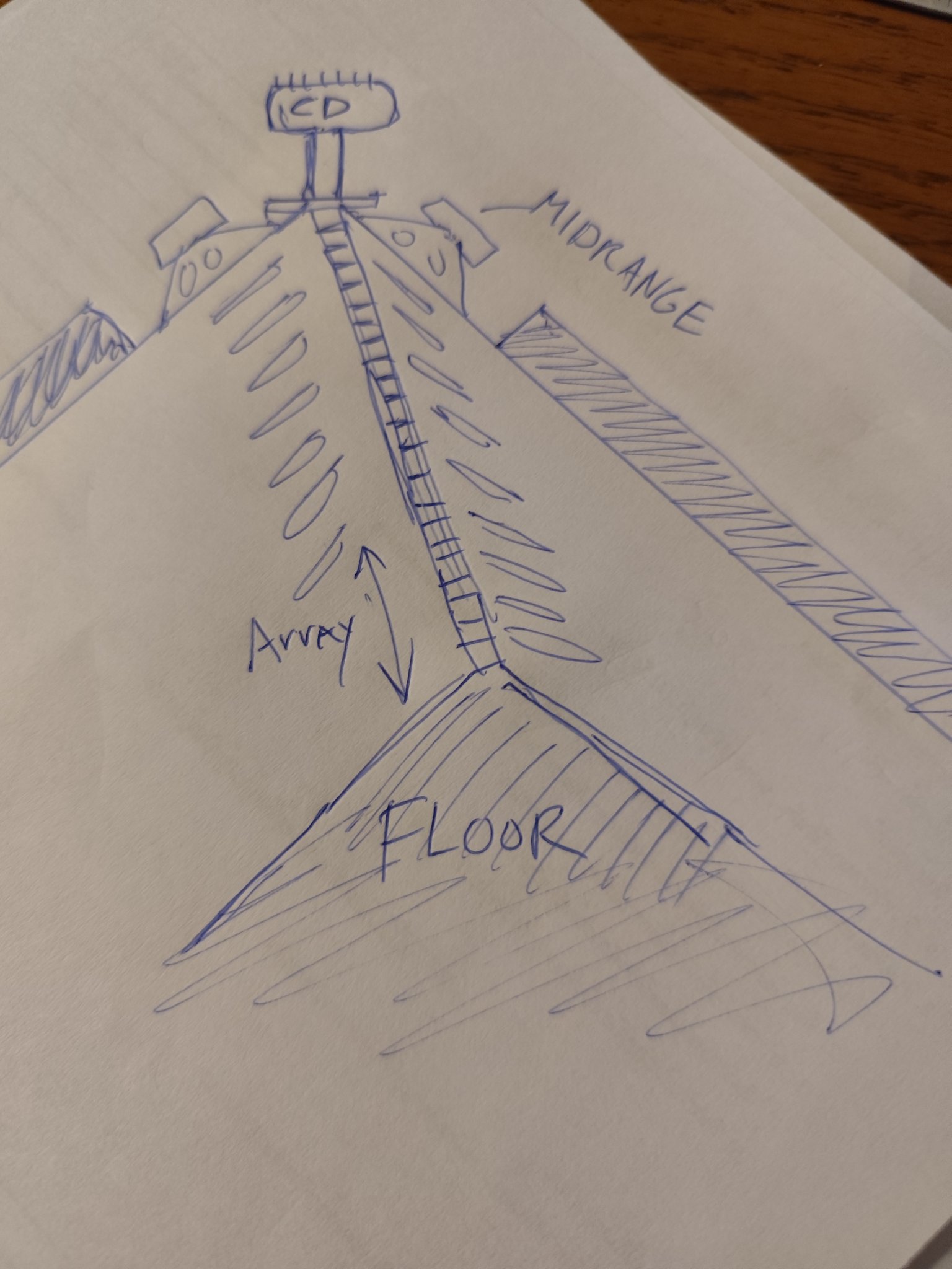

I am now working on a trapezoidal space with 3m tall open baffle line arrays (24 full rangers and 12 ess heils per side) with a big horizontally oriented mono OB sub (4x21") in the center hanging from the ceiling. There is a dancefloor in the ⅓ narrow part of the trapezoid behind the speakers and the last ⅓ of the wide end of the trapezoid has a raised floor....or maybe there are even 3 levels....a bit like an amphitheater.
I think the wide dispersion line array in combination with a raised floor in the back should give a lot of good coverage. Or am I missing something here?

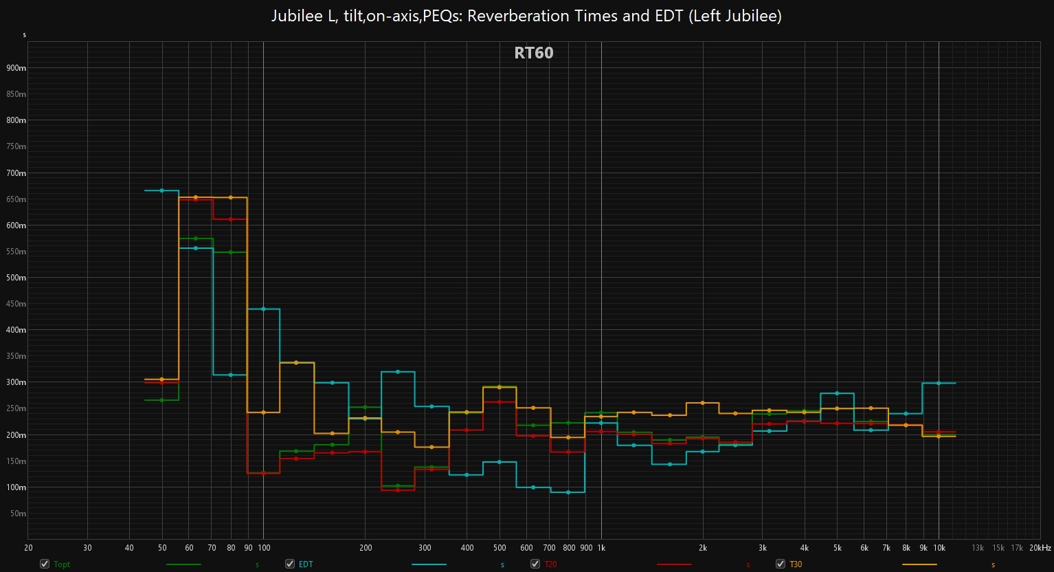

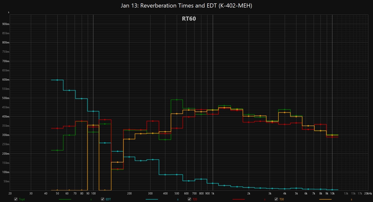

And the same measurement done about 2m farther away from the left front Jubilee (fully horn loaded loudspeaker) at the main listening position:
(So it appears that where you take the RT measurements matters a lot.) My room dimensions are 40' L x 15.5' W x 9' H (5510 cubic feet), (12 x 4.7 x 2.7 metres--152 cubic metres). The listening position is about 11 feet from the front wall (~3.4m).
There isn't much to be done here with EDT and RT20--they are quite low already due to the full range directivity of the loudspeakers. The story here changes dramatically if you try to use loudspeakers that basically lose their directivity below 1-2 kHz (i.e., virtually all cone and dome loudspeakers). I don't think that you'll be able to play music for 80-100 people using something as low efficiency as electrostatics or other non-cone dipoles, so the choices are either loudspeakers having full-range directivity control, and those that don't have it (i.e., direct radiating woofers, etc.).
So it looks like you can really control the diffusion problem simply by good choice of loudspeaker type--i.e., full range directivity. Certainly, if you want to add convex-type diffusors to the side walls and ceiling (if that ceiling is below 10-12 feet [2=3m]), you can do that and further decrease the EDT and RT20 times toward the back of the room.

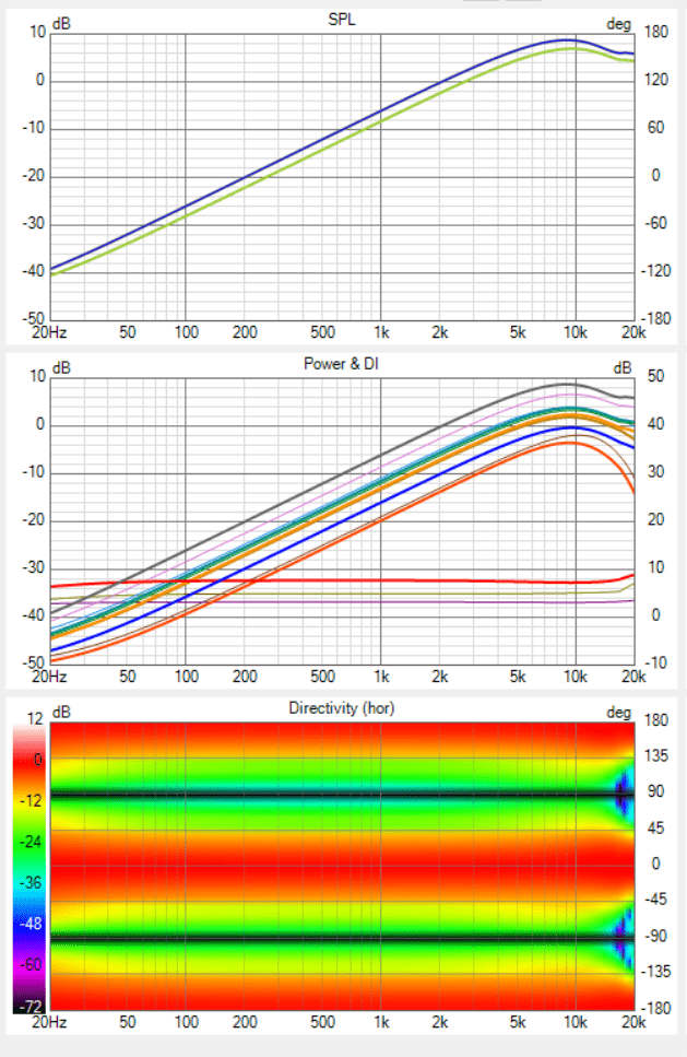

Wouldn't open baffle also qualify? Especially in the bass region it has little side radiation.So it looks like you can really control the diffusion problem simply by good choice of loudspeaker type--i.e., full range directivity.
An open baffle is a cone-type dipole--with loss of directivity control determined by the diameter of the baffle. So if you want to control directivity down to 200 Hz (like the full-range MEH and horn-loaded loudspeaker RTs and EDT plots above), you're talking about a baffle that is something approaching 34 inches diameter. That's fairly large for an open baffle.
In a room the size that could entertain 80-100 people, you probably would want to control directivity down to ~100 Hz, so the baffle diameter would need to be increased to something like 72 inches/1.8m. It's probably better to use an infinite baffle arrangement with the loudspeaker front baffle being coincident with the front wall surface,
The problem with open baffle designs is "what do I do with the backwave?" which generally needs an incredible amount of diffusion on the front wall to break up the specular reflections, as well as at least 11 feet/3,4m of standoff distance from the front wall to get enough backwave arrival delay relative to the direct arrivals to be outside Haas integration period of the human hearing system (i.e., at least 20 ms,,,and that really isn't enough delay).

What about a hybrid solution? Imagine a long listening room where you put very large open baffles in the middle, like partial room division walls. So maybe the room is 24 meters long and 7 meters wide but is divided by two 2m wide floor to ceiling baffles with a 3m opening between them.
Not sure if the baffles should touch the sidewall or there needs to be a gap?

Hi Cask05,An open baffle is a cone-type dipole--with loss of directivity control determined by the diameter of the baffle. So if you want to control directivity down to 200 Hz (like the full-range MEH and horn-loaded loudspeaker RTs and EDT plots above), you're talking about a baffle that is something approaching 34 inches diameter. That's fairly large for an open baffle.
I think you have mistake. Pattern of OB would be good down to DC, and it typically gets better the longer the wavelength as asymmetric construct of cone driver gets small compared to wavelength. However, SPL drops like a stone, which is related to baffle size. The dipole peak, usable bandwidth, comes down in frequency with baffle size.
Here ideal 1" driver in ideal 1" OB and pattern is ideal down to DC.

- A floor to ceiling array of any kind, with different drivers, will need quite a bit of listening distance for the sound to come integrate. It did not sound like you had so much space.
