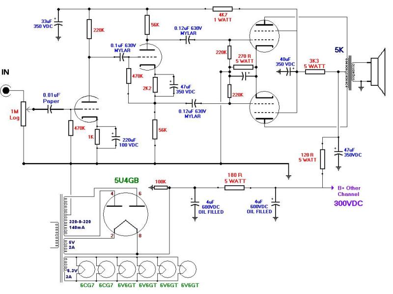

try this
This is fairly easy to build and sounds nice. You can use 6V6 or 6W6 and the input could be 6CG7 or 6SN7.
Using 5U4GB up the cap values to 40uF (I had the vintage oil filled caps on hand and liked the look) more capacitance IS needed.
With your Tranny you'll need to play with the resistors in the B+ filter to get to the 300V @ 70mA.
You could also use some chokes. download PSU designer.
