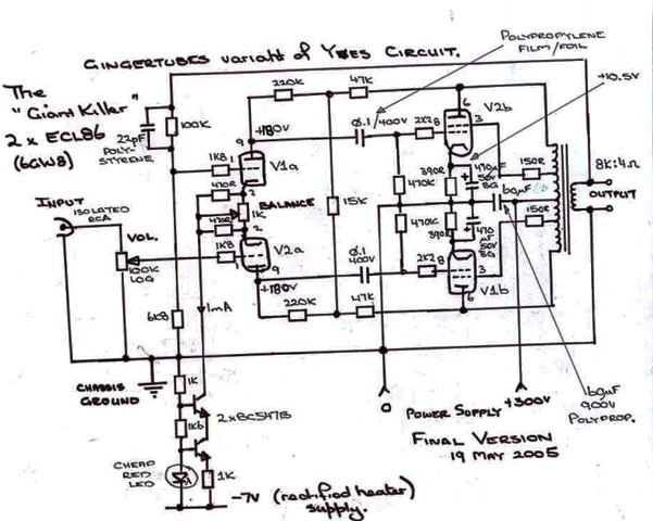

An even easier Baby Huey build would be to use the ECL86 tubes - this was the configuration of the original BH and sounds wonderful - schematic attached. This was my first venture with tubes 2 years ago & I modified a Rogers Cadet II into a BH - not difficult at all
Original thread from Gingertube: http://www.diyaudio.com/forums/showthread.php?threadid=53969&perpage=20&highlight=&pagenumber=1
cheaper too! ecl86 are fairly cheap.

If you can pick up a cheap working Rogers Cadet II or III you will have everything you need - 4*ECL86, PS trafo, output trafos, retro case, knobs, etc, etc - just a tiny bit of re-wiring to do & you'll have an excellent amp. This is what I did & I still have 3 ECC807s to sell on ebay for ~ £70-90.
Being in the UK you may well get one of these Rogers easily.
Edit: I have schematics for the Rogers if you want & can give you directions on the re-wiring

I will have a look out for the Rogers amplifiers, but as this is probably my first and only tube build, i may stick to all new parts, depending on how good of a deal i could get on the rogers.
Adam did you have any hum problems with your amplifier, or anything related? I really dont fancy doing all this p2p wiring to have to take it all out again!

Very Very tempting. I think i will go for it, maybe the simple version that jkeny posted.

To minimize hum, use solid core wire for the heaters, twist tightly, and tuck into the edge/corners of the chassis only venturing out when connecting to a tube socket. Keep the wires twisted as close to the socket as possible. Wire the output tube heaters first, then end up at the driver tube(s). Keep the heater wires as far away from the sig wires as possible.

Takening on board advice given in the huey thread, i had power down one side, then ran the signal down the other.
