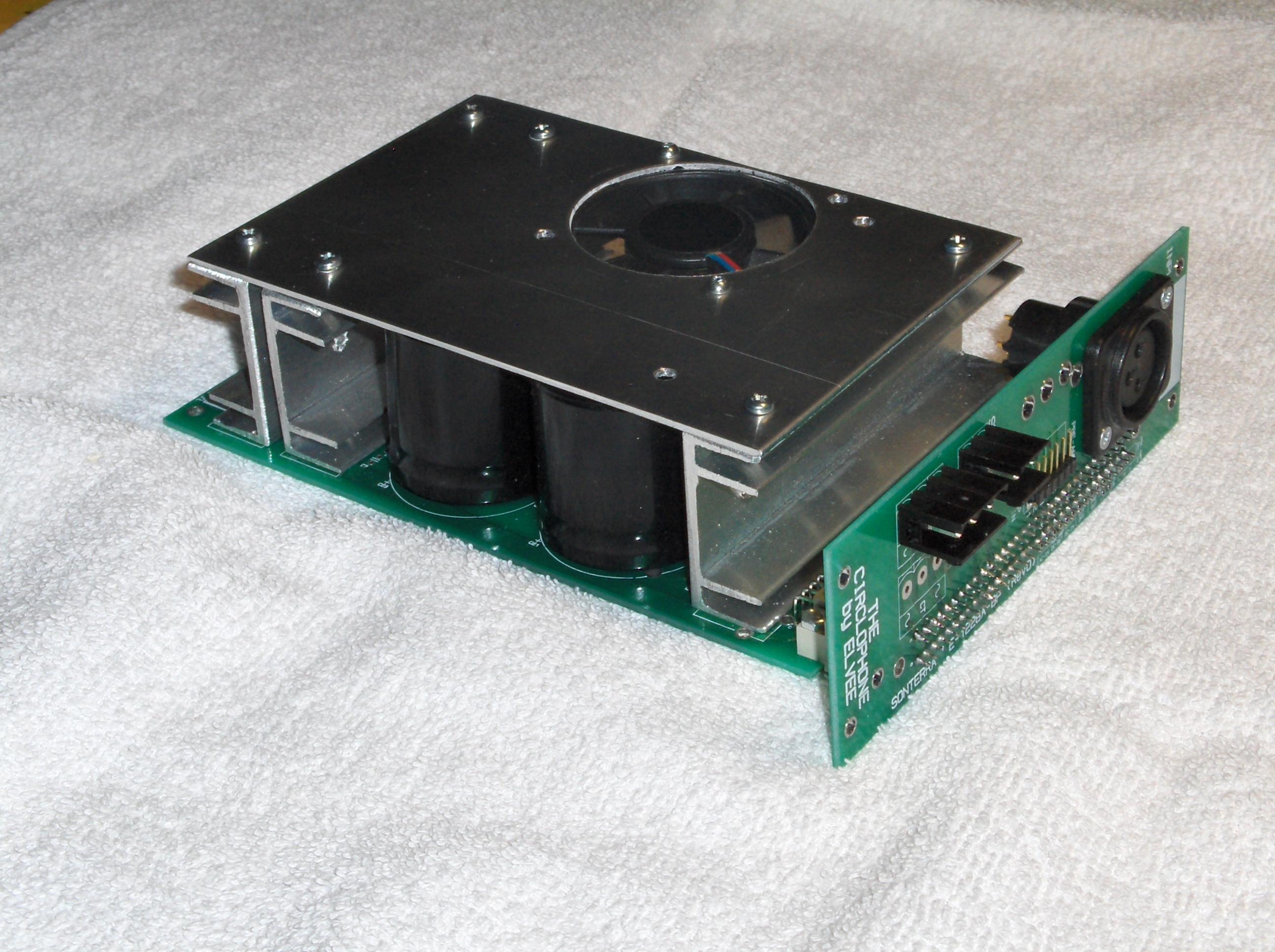

Large list of boards, most with board (albeit not so much gerber), at Post#1. http://www.diyaudio.com/forums/soli...ccessories-beginner-friendly.html#post2968086
I do have some unpopulated spare boards and heatsinks (not drilled). Elvee had one assembled unit for evaluation, ask him his opinion. Pix of assembled unit attached. The unit is in a standard DIN format (100 x 160 mm) c/w connector back-plane. E

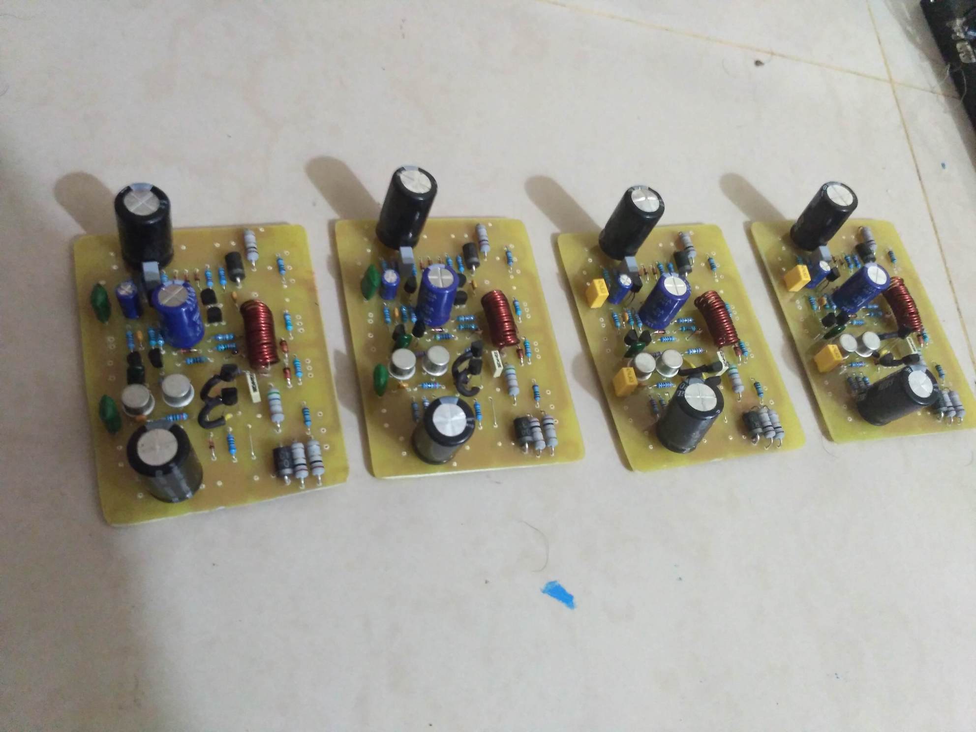

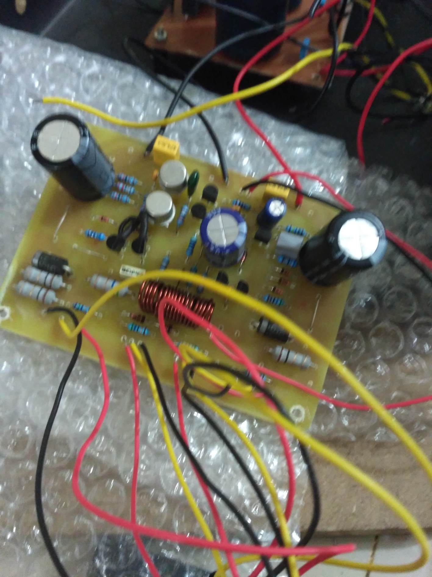

Hello Folks,
After reading lot about Elvee's Circlophone , decided to replace my existing chipamp set up (LM3886 and TDA7294) with 5 Circlophones ( stereo for mid range and tweeter , mono for subwoofer )
I am using Alex's pcb ( slightly modified to take 470pf cap).
Power supply : 20-0-20 AC 200VA transformer -1 each for midrange-tweeter and Sub
Simple 10000uf per rail PS capacitors .
Single PS is used for both the channels
Output -Cdil 2N3055HV6- (cdil is an Indian semiconductor manufacturer )
Drivers- Cidil BD140
VAS- Cdil 2n3019
First connected mains bulb tester - Pass
Voltage across R8- 193mv
voltage across R11- 123mv (is this normal :scratch2: ?)
Since these voltage looked fine as per the folks who have built it, connected test speaker , it sounds really good (as anyone who tried Circlophone ) - Not yet connected to biamped set up. I am sure its full capabilities will come to light then.
After half an hour of listening
2n3019s--- slightly warm- comfortable to touch
BD140-- Slightly warm- comfortable to touch
2N3055- much warmer than above 2 - can touch , but not very comfortable
One thing is bit strange :- i can hear faint hum when I place my ear close(3 inch) to speaker and also there is on off pop.
In isolation, these voltages are normal (maybe the voltage across R11 is marginally higher than usual, but nothing to worry about), but the voltage across R11 should be very nearly the half of R8 (it should even be slightly smaller than that in fact).
If this was measured with a load, it could be an offset issue. Did you measure it?
The quiescent dissipation in each 3055 is ~6W, and if their heatsink is not very large, the temperature rise could be significant
My suspect list
1) Output and other transistors are of bad quality
2) I am missing something related to ground (you can consider me as inexperienced )
3) Ceramic caps used for all the pF values
4) Power supply capacitors are insufficient
1)Unlikely, not consistent with the symptoms
2)Highly likely
3)No
4)They would need to be really small to cause that
Ok... now measured voltage after connecting 8 ohms load.
R8- 183mv- R11-90mv. Wow 🙂
placed all the amplifier boards inside enclosure. connected PS ground to metal enclosure , faint hum which was there in test set up, vanished into thin air so as on off pop -( You were Spot on sir Elvee ) .
Connected the entire system to 3 way active crossover and speakers and turned on the switch--- wow! 250 watts of pure bliss started filling the entire room .
