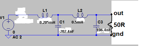

I don't know if this information matter but I let you know: the source impedance of noDac connected to the input of BA-3 is 50 ohms.
I'd keep that R1 in place, especially with that low noDAc output impedance.

The noDac it's an USB I2S output filtered with a 4th LPF, attached schematic, there isn't the output coupling capacitor that the value depend of input impedance that for BA-3 47K is 1,69uF but I installed 4,7uF that's the value that I have on hand..

What is the DC V at the 50 ohm resistor?
Not recovers 190mVrms, increase but only till 18mVrms but in place of 1kHz like connected to SG measures 0Hz.
I guess the resistor of the filter right? wait a moment I'll measure.Try what Boky is suggesting above, though it seems the BA-3 is working fine.
If you disconnect the BA-3 and play a sine wave through the JLSounds, do you get a sine wave at the 50R resistor? You would either need an oscilloscope for this or an RMS meter that can measure the frequency. 60 Hz is best. Trying to make sure that you are getting signal that you want from the JLSounds. If this works, then it is likely a question of loading.

I am not sure then what’s going on. I would imagine it is a question of loading. You could try shorting the 1k with a wire and clips and see if that does anything.
Another thing to confirm is that the BA-3 is working properly. You could hook it up to another source that makes regular output, like 2Vrms, and see if it makes normal sound. Be careful though, it has 20 db gain. Turn down the volume for this test. If it works, then we know it is the interface between the I2S output and the BA-3.
Check the BA-3 output stage bias as well. How much current is flowing through R10 or R11?

About lowering voltage of SG when connected to BA-3 could be the problem that the noDac it's also connected to BA-3?
I am not sure, but probably better to connect only one signal source at a time
