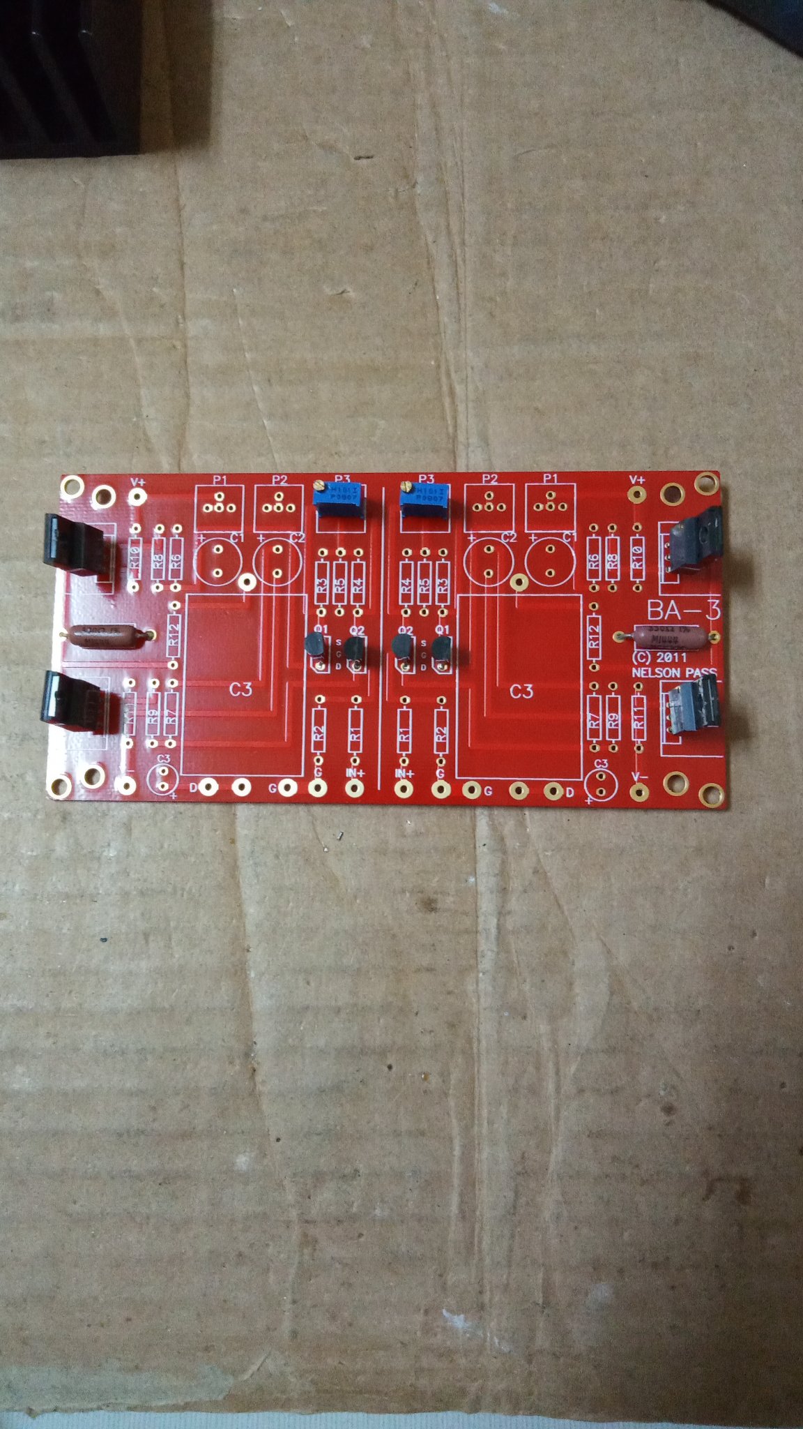

Hi guys, as tittle said "Building BA-3 as analog output stage of noDac", well the noDac outputs 0,19Vrms so I was looking for something with a gain x10 to get near the standard 2Vrms, helping me to take the BA-3 option because I own original SK170BL, SJ74BL, K2013 & J313 from when I used Erno Borbely stuff, also it's not complicated to do it and adjust (very similar to Borbely), don't take to much room inside noDac box and is a lot of more easy and a lot of less money than make a DHT 4P1L with the same gain of course I don't expect the same SQ.
I read with attention NP BA-3 article, it seems with standard resistors values BA-3 fits nicely the x10 gain I'm looking for.

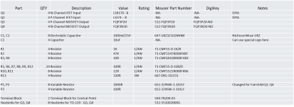

Attached NP BA-3 article to know if it's the latest or there is other new and also B.O.M. for a balanced unit that I will not do because all my system is SE.

Q3 is the P-channel device, so that would be the J313.
In the article, the bias is set to 50 mA for the output stage and approximately 8-10 mA for the input stage. I'd guess 60 mA is the total bias current.

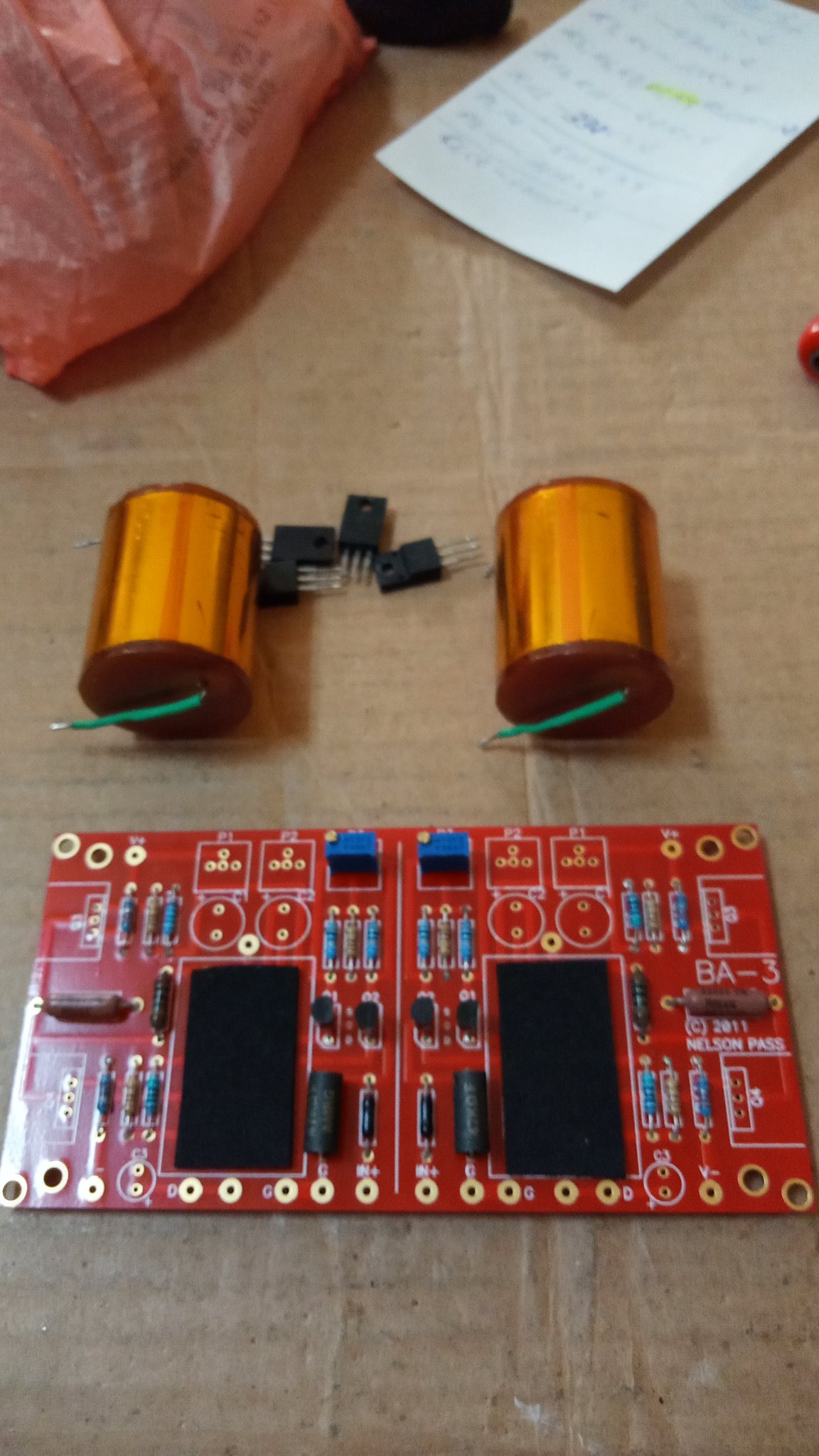

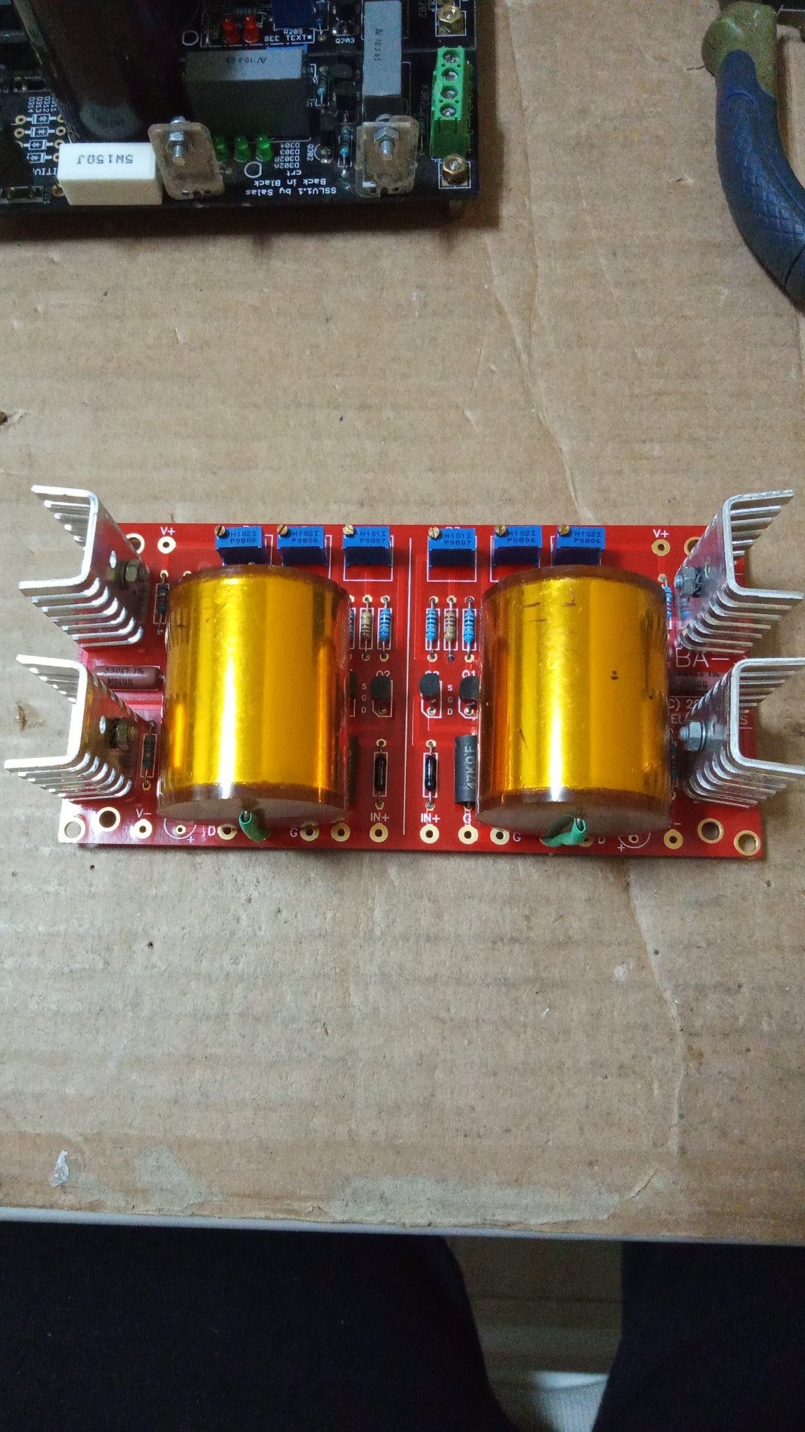

Thanks Ra7. I have to make a new order to Mouser because the electrolytics that I have are 50-63V so bigger diameter than PCB allows, four 1K trimmer and four heatsinks that also don't have in my stash. Attached pics with work in progress.
Nice! Once you have the parts it can come together in an afternoon.

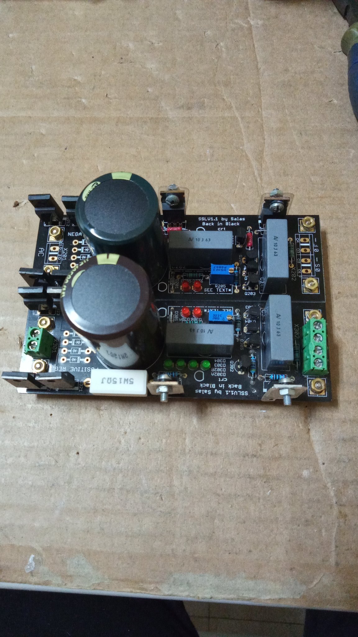

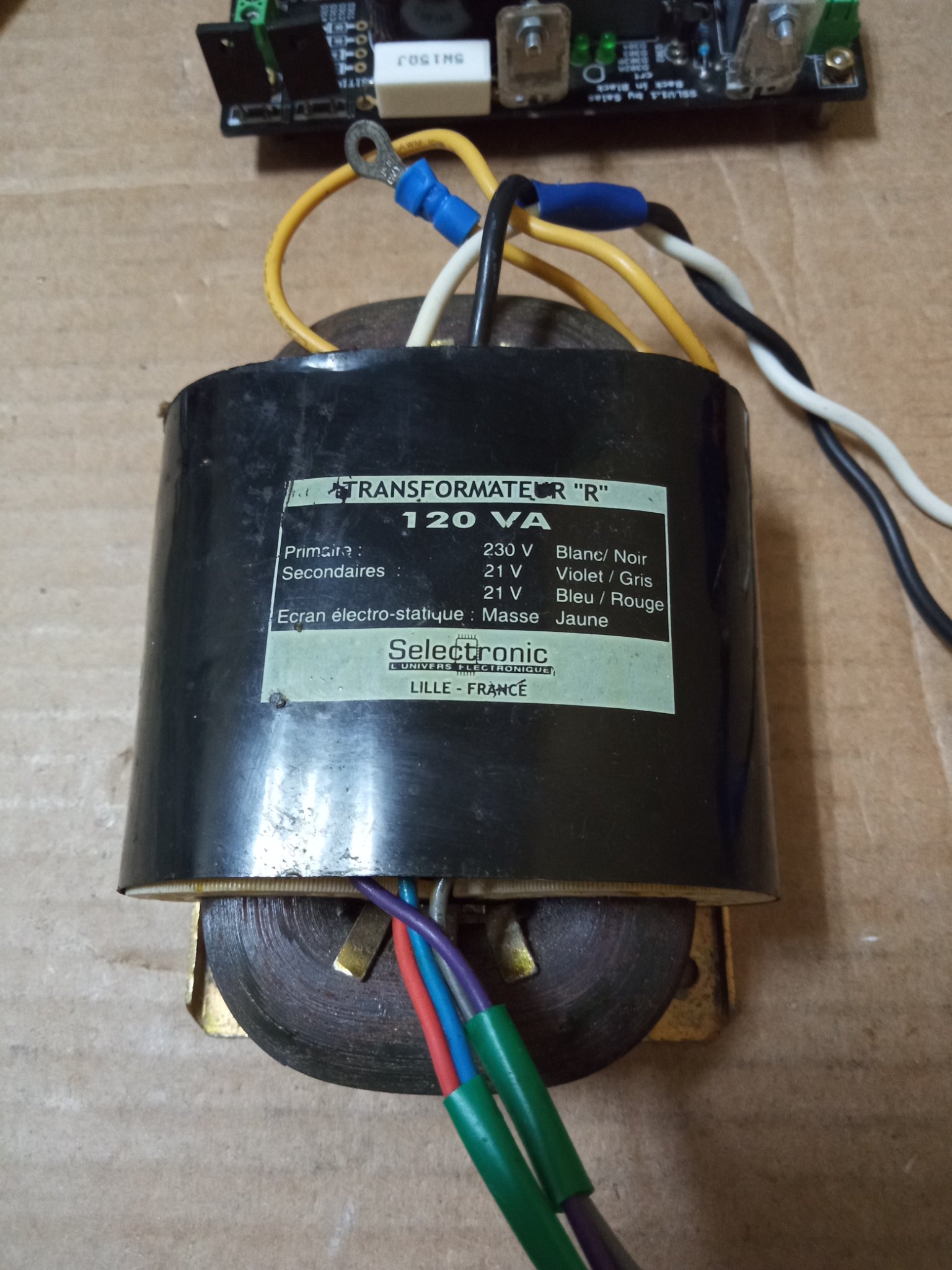

I have to decide what regulators I will use, I have on hand one +- regulator Salas BiB SSLV1.1 and a nice R-Core with dual secondary 21A 120VA so 60VA each secondary, the regs. have rectification & mains reservoir capacitor so be good to save space.

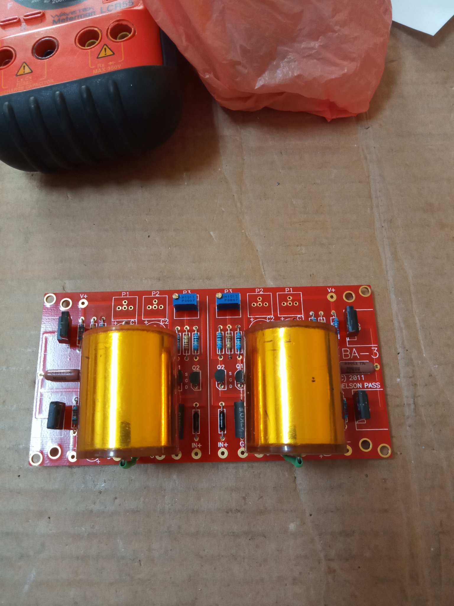

Listening the BA-3, could I bypass the 1K input resistor, I ask because the Vin it's too low circa 0,19Vrms so the resistor take off a lot of sound?
Some music sound weak and far.
1st stage Jfet only reach 6mA.
Also some music is masked and not heard or heard too little or blurred.
Let's see if it will sound better after the 3-4 hours of burning.
