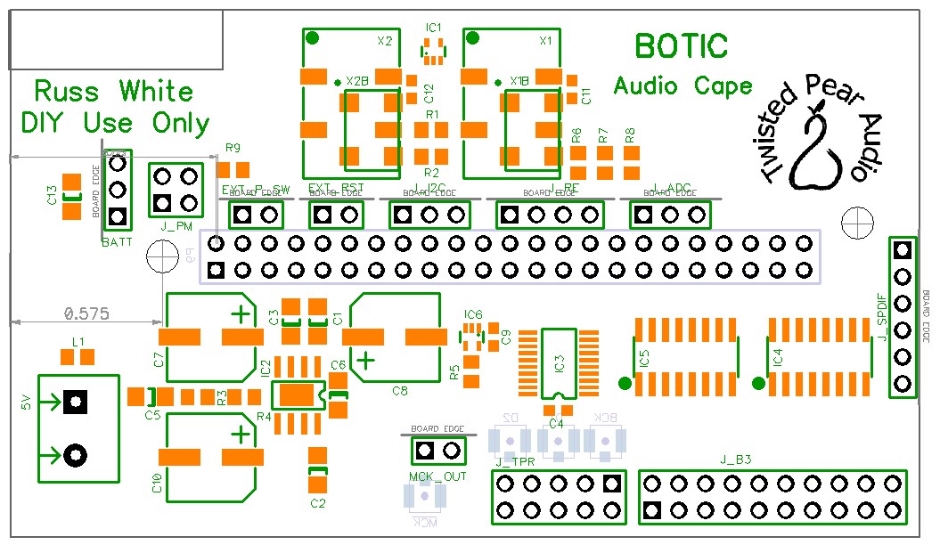

Figured simplicity with single BBB clocking would be paramount.
But clarify that if orientation can still be achieved with I2s lines< 10cm to (2) BIII's isn't dual 8ch DACs a feasibility?
I realize I was lost with any 2 BBB query, but local seller awaiting RevC had 4 RevB avail ...they're good barter now
Actually we run I2S lines about 30 cm and have no issues and compete with vinyl, so really it is about implementation we have found on the KillerDAC.
Just on 10 prolly won't cause huge issues, best to wire and test before doing a fully layout in an enclosure.

I don't really see the 10cm(3.9") limitation and the non-stackability as a defeating issue.
The 10cm number people throw around is a totally arbitrary number. The rule is: shorter is better, and don't cross noisy clock wires with any other wires (power, gnd, etc).
IF system layout is determined knowing ALL the physical/dimensional parameters.
We should be able to release more information about physical size very shortly. We are working on multi-board layout details now.

The 10cm number is not totally arbitrary. It's what one of the designers stated as the maximum trace length for which I2S was designed. And 10cm is still what many chip manufacturers (Samsung, Atmel) state as their maximum PCB trace length, for many other usages (besides I2S).
That said, the statement about I2S was made in the 80's. It was a time many people believed no PCB made in China could ever go beyond 50MHz. Ouch. 😱
Do you have documentation of this? If such a statement was made, it was probably arbitrary as well.
It seems it would depend purely in the impedances and drive capability of the chips involved, as well as routing precautions taken (including shielding).
34 year old data, surely there's more recent
It's not 34 year old data.
I believe it to be a technical parameter of a 34 (or so) year old technical standard, which is quite different.
I recall quite a lot of discussion around this a few years ago but life is to short and there are too many audio projects to complete to make it worth trying to find again and the main thing is a viable, not too compromised, end solution and I believe there is the expertise here to deliver that to us.
Ordering boards today. Here is the PCB in case there any last minute requests. 🙂
Since we only use P9 and I really needed to use both side of the PCB I offset the board so that just P9 is used and that way one can actually direct mount a B3. There are headers for Teleporter(MCK,BCK,D1,D2), B3, MCK, Rotary Encoder with switch, RST, PWR, ADC, I2C, and BATTERY.
