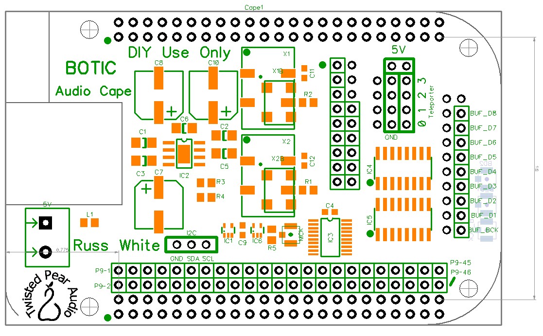

Nice! Can you use one more guinea pig?
Beta board preview
Here is what I have right now for a layout.
I have uFL to MCK,BCK,D1,D2 (B3SE mapped)
I added teleporter header.
I have a header that exposes most of the raw signals (I will document that later)
There is power that can optionally supply or be supplied by the BBB via L1
Header for direct connection to B3 or B3 SE
I2C header on dedicated I2C channel.
I made provision for the big Crystek, or smaller less expensive clocks. They are offset to better allow the use of two separate paste masks for production.
Feedback welcome.
Feedback welcome.
Cheers!
Russ
Feedback welcome.
Its everything I would wish for, can't think of anything else thats needed.
Waiting with eager anticipation!
Its got everything I could want except an insertion point for a Trident or similar regulator for the clocks... but I'd rather get a Biotic sooner than wait for that, especially given your comment a few posts back.
BTW, SPDIF input gone? Not an issue for me, just curious.

Power regulation?
Hi Russ,
Another question for your beta design: when you say,
"There is power that can optionally supply or be supplied by the BBB via L1"
do you mean that there will be regulation of the input power by the cape? BBBs come with an input pin for a 5 V supply. If I connect the supply to the cape instead of the BBB will it be regulated?

Hi Russ,
I am looking forward to this exciting development. Thanks for your fine work.

Looking forward to this, it looks pretty much spot on.
Can't wait to give it a try.
I can only add to the chorus of "Yay's" - it'll do what I want but then I am a simple man of dubious taste
Spec the best clocks you can Russ and put the first batch on order - I don't think there'll be any shortage of buyers. I assume this is going to be a pre-built board with all SMT?
I fear that may price it beyond my budget!
Russ, given you are allowing for the 2 sizes of oscillators are you planning different versions or just hedging your bets?
A provision to use trident shunt regulators for the board clocks and ICs would be perfect!
Will there be isolated and unisolated output on the board?
What kind of isolators will you use?
Will this be a readily soldered board or a kit?
I can't wait to get my hands on one of these!
