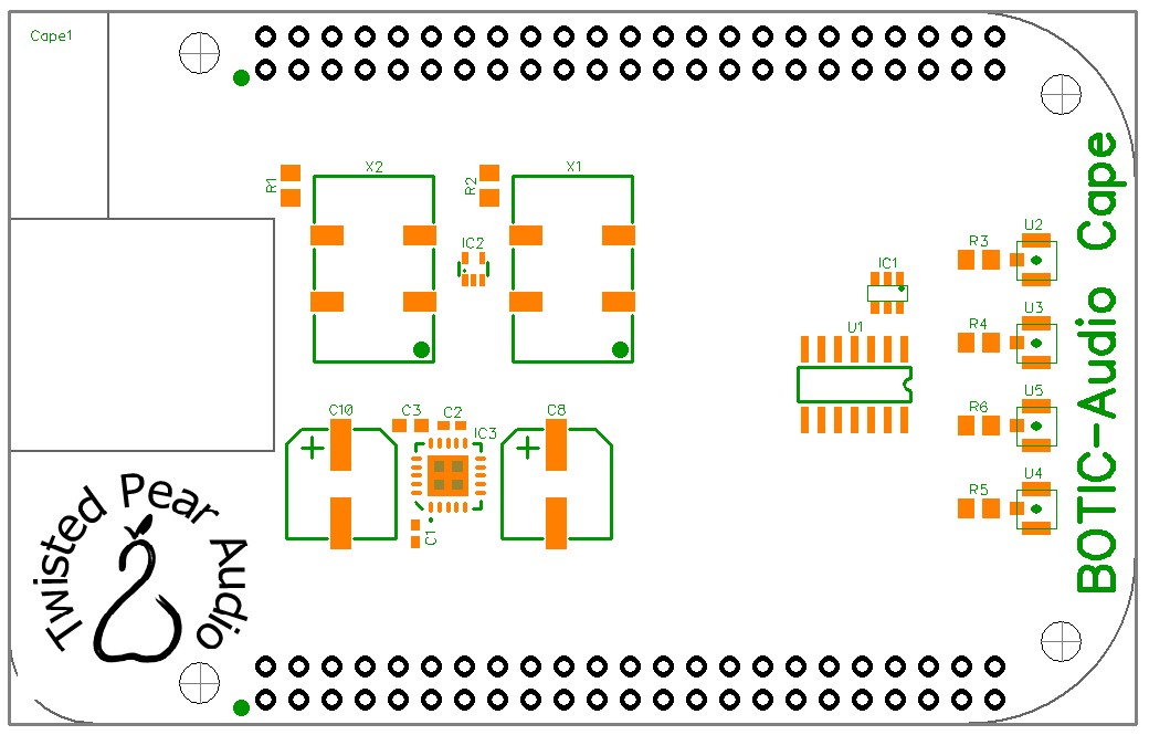

Here is a very early preview if the "Botic" cape. The Botic is a creek in Prague. The name is a tribute to the work Miero has done on the driver for the project. I liked the name - so it is sticking. 🙂
Some feature will be (not all populated on the layout yet)
1) Buffered PCM/DSD out (DSD will take some driver work) The buffer protects the BBB from accidental overloading of the outputs.
2) I2C out
3) Dual ultra low jitter clocks with outputs for DACs which need them.
4) Optional external power.
5) On board linear reg for the clock/mux/buffers.
6) ADC and/or Rotary encoder input to control volume externally.
7) I2C display could also be used.

russ, any chance we could have a dac onboard, such as the es90023 for simple lower cost integrated music server? Could be optional and I believe there is a large demand for such a product. It would be great for the secondary system, bedroom, etc.
Thanks! There is still some work to be done on it.
I forgot to add that we should also be able to support up to 8 channel output. Disregard the number of uFL connectors, as there will be more. 🙂 Also headers too.
I think I may do a seperate cape for those wanting a simple but high quality DAC. ES9023 would indeed be a solid choice.
I will mull it over.

Simple Cape
Hi Russ,
My preference would be for a simple cape as you have already described. Adding an on-board DAC seems like another direction (although it would be useful). My own needs are for extracting I2S signals out of my BBB and feeding them directly into my TPA BII.
Currently I am using a BBB with USB output feeding my TPA USB receiver, into my BII. Fantastic sound. Substituting the BBB for my mac removed most (but not all) of the drop-outs. I measured the signals from #P9-28 -29 and -30 with my scope and did not find square waves. But my BBB is configured according to Chris Connaker's instructions on ComputerAudiophile's website.
I've been following this thread with keen interest and want to thank the members for their valuable contributions. I am looking forward to the Botic.

My vote is for a simple board much as Russ has shared. DACs or SPDIF can be off board. Only thing is I would prefer a header for I2S out rather than U.FL or possibly both.
Great work guys.
Great work guys.
Russ,
How about pads for an I2S-out header to allow easy connection of a Teleporter? That could also be the point for adding a Q&D ES9023-DAC card!
Greg in Mississippi
Greg in Mississippi
Vote #2. If the I2S outputs were only to be provided from the Botic cape as U.FL connectors, wiring 3 u.FL cables to a (nearby) teleporter would be somewhat kludgey. A pin-compatible header for the Teleporter would be great.How about pads for an I2S-out header to allow easy connection of a Teleporter?
Pin headers will definitely be included - I always planned to make it easy to use the teleporter - especially for stereo use. 🙂
