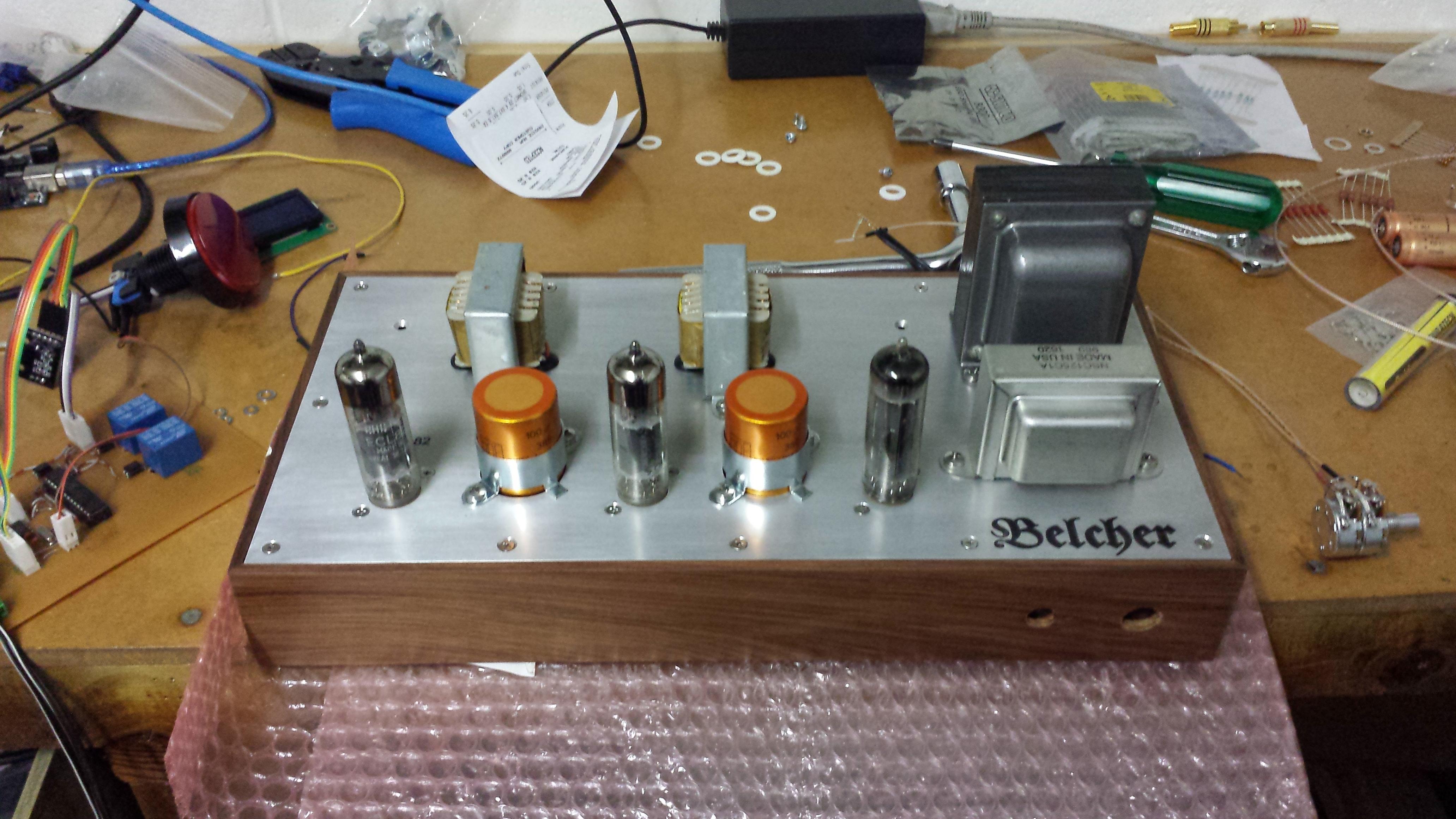

Ive just completed the amp today!
It appears to be working, but not very much volume at all, quite faint.
The left channel seems weaker than the right also.
Im yet to connect to my signal generator and scope, but ive just tested with music playing through my phone.
Only difference ive made to the original schematic is ive made it ultra linear, and i have wired the grids to the centre tap on the transformer.

Remember your barely getting a clean watt out of each, what sensitivity are your test speakers ?

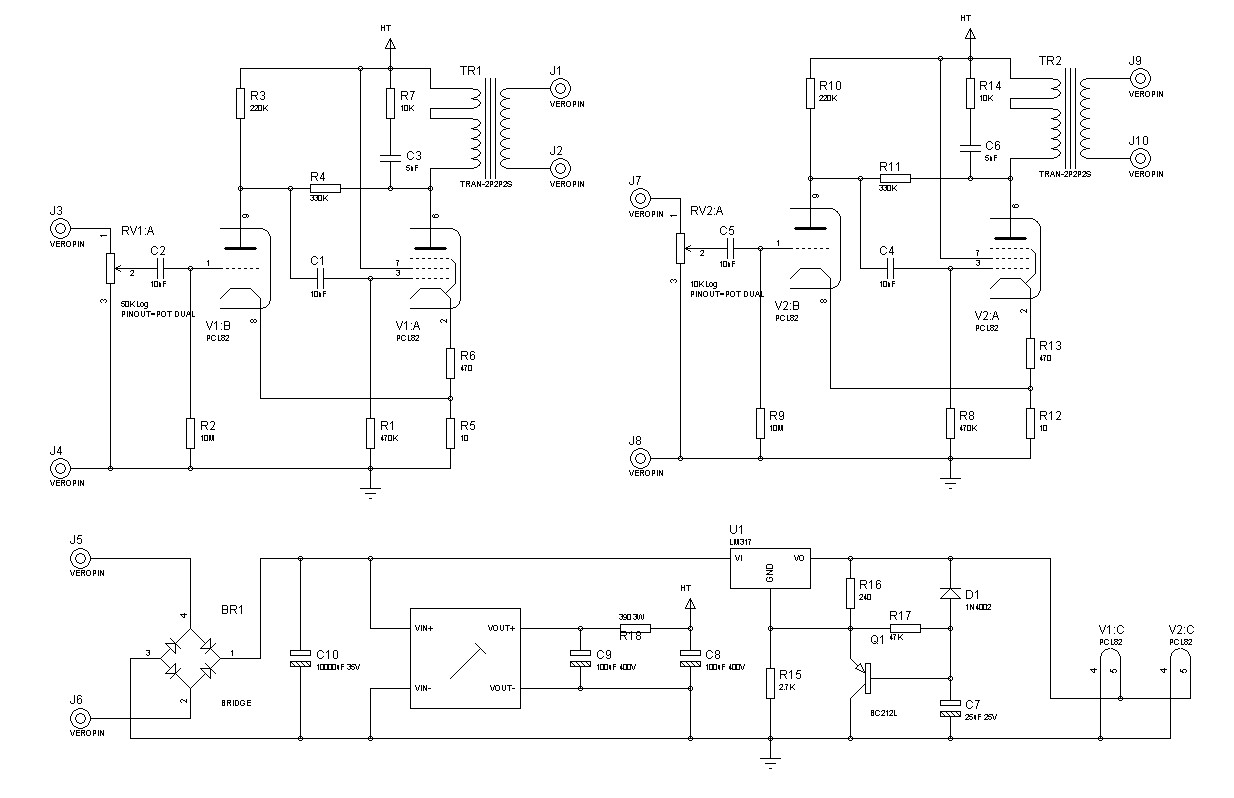

I did not find this schematic. Can you put it here on the forum ?
Ive seen many old stereograms with the ECL82 in Class A operation with much louder volume than this.
The volume of course depends on the input signal level. How much did you feed in ?
And have you measured how much is at the g1 of pentode side ?
The schematic was posted by the person who started this thread on the first page.

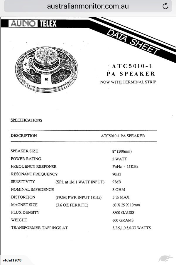

Yes a true full range driver can be a hard thing to source.
TBH i agree, a standard PA speaker or something with a piezo electric tweeter added would probably do the job.
Ive just found a pair of speakers here, IDK how good they are, they are made in Taiwan, but are full range and 93dB sensititivy.
What do you think?
Here is the datasheet

The triode section has a max current of 3.5mA and an amplification of 70, with a max plate dissipation of 1 Watt.
So 170V at 0.5mA looks about right to me.
I would also suggest trying some negative feedback. The distortion may get a bit messy in a pentode circuit like this without it. Also it provides more useable power too.
This is an excellent working point for this tubes triode. It has been proven by many other circuits to be good working. Even famous designers are choosing those values.
It isn't necessary to do 100uF on the anode of the pentode. Try 47uf, thats what good designers choose. The foil caps parallel are unnecessary if you choose good caps. No designs of the old days has used those and they sound brillant.
But remember, use dry electrolyts in the high voltage section, not the cheap wet types. They last many longer but are more expensive. The sound will be much more better.
How will this circuit perform?
I would be very concerned due to the lack of a bypass cap on the output stage.
Can you explain more please? i am new to tubes.🙂 This particular circuit was assembled and demonstrated as an example of a simple and good ecl82 amp. I also have seen such a schematic from radio museum.org, Only change being that the plate to plate feedback resistor was 3.3M, whereas the new one shows 330k.
Here is a short article on cathode bypass capacitors:
The Cathode Bypass Capacitor Explained - DIY AUDIO BLOG, AUDIO WORKSHOP
The lack of a cathode bypass cap in that design would make sense if it was copied from the output stage of some old AM radio, and I would assume that you are aiming a little higher than that?
There is positive current feedback via the tap on the output tube cathode resistance back to the driver cathode. Pick the correct point & the output impedance of the amp is lowered. But there will be more distortion.🙁
This connexion is sometimes used to get more gain but in conjunction with negative voltage feedback from the OPT secondary. Worked for me in a couple of circuits long ago,🙂
