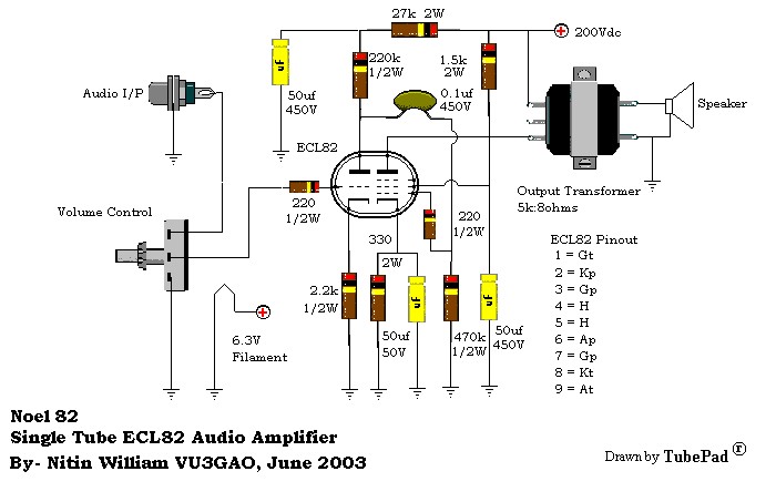

Im at long last working on this amp build and will post some photos when complete.
Couple of questions - the large 680 ohm 5W wirewound resistor on the HT supply, is this supposed to act as a filter choke?
Each ECL82 will draw 35mA of current. So at 270V, it would be running at 9W of power per channel on the HT supply. Would this resistor run rather hot? Should I use a larger power rating?
Question to nzoomed: Did you build your amp according to the schematics shown in the very first posting? This leaves something unclear: Do you feed one or both channels via the 680R/5W resistor? Where do you measure 270Vdc? At the right (PSU) side or at the left (charge) side of it?

You may want to have some closer look, as the ECL82's maximum plate dissipation is rated at 7 watts. What are the voltage drops over the cathode resistor and the OT's primary?

This datasheet even has a higher current rating than the one i got my figures from.
http://drtube.com/datasheets/ecl82-philips1969.pdf
Says current on the anode is 41 mA, and 3.5mA on the triode so is 44.5mA going by that, which would even mean more power!
As you say, thats more wattage than the plate dissipation, but perhaps there is some losses on the output?
OK, thats true, forgetting about that.
Its a big problem with Class A amplifiers.
Ive got an amp i built with an EL34 and the plate will glow hot when idle. Im trying to increase the resistor on the cathode to try and make it use less current.
