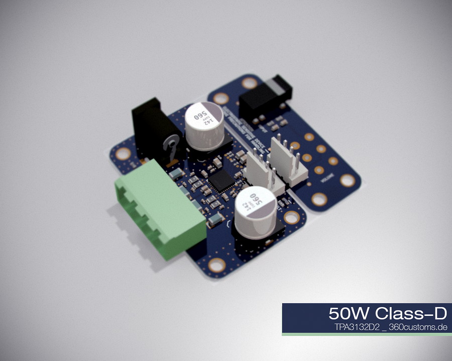

Damn, it doesn't look like anyone stocks the NJU7181 and i can't figure out what to search for to get an alternative.
If it's still your concern I would be happy to swap one or two NJU7181 for an empty board when it's ready ;-). NJU7181 is a sweet chip, simple and hardly to be replaced. There is a complicated alternative via a microprocessor though...

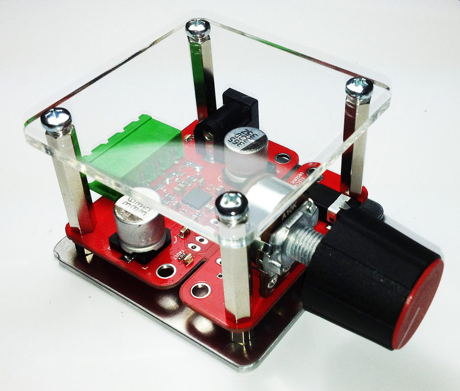

Doc, I noticed you're using a number of 0402s? No reason why not, but it looks like 0603s would fit nicely.
It's not so much the capacitor, but more how it changes the PCB layout that reduces the ESL with a wider capacitor, as I understand it anyway. Not hugely necessary on one of these amps but nice to have...
Dunno, maybe because i do everything in 0402/0201 at work.
We did some more tests with the result of having a solid 50W continuous output power with free air cooling at 2x8R.
Tested at PVCC:23V5, Iin:2.2A, 30Hz sine wave, 30 minutes.
Temps were:
tamb:18°C
tpcb_bottom: 95°C
tcapacitor_bulk: 56°C
tic_top: 142°C
Noone will ever run pure 30Hz for more than a couple of seconds i guess. 😀
Peak power is higher of course.

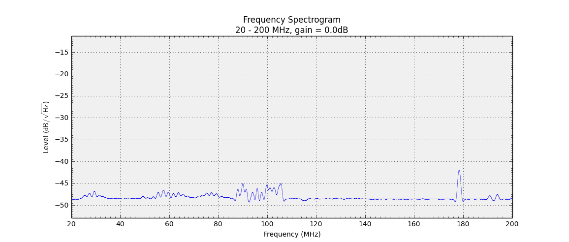

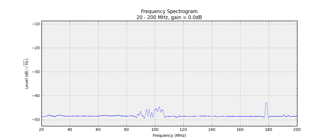

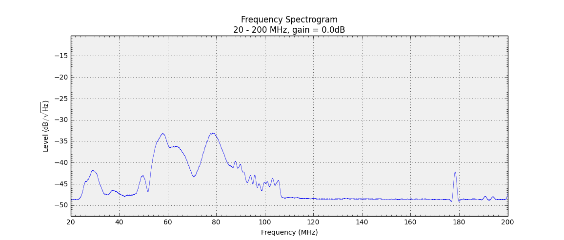

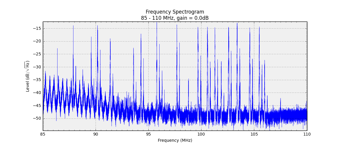

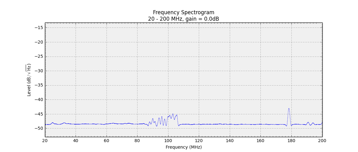

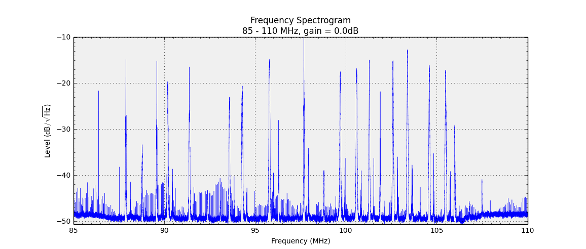

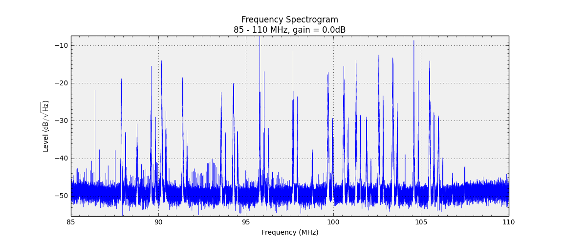

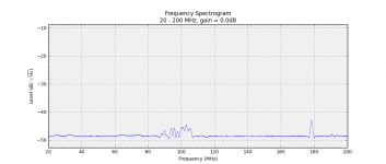

Comparing the MAX9709 and TPA3132D2 in filterless configuration:
1 channel loaded 8R 150cm cable
50cm distance from antenna (70cm cable)
Antenna <-50cm-> Amp <- 150cm -> Speaker
Idle:
MAX9709:
TPA3132D2:
MAX9709 with no speaker connected:
TPA3132D2 with no speaker connected:
Idle FM-range detail:
MAX9709 FM-range detail:
TPA3132D2 FM-range detail:
Idle:
MAX9709:
TPA3132D2:
