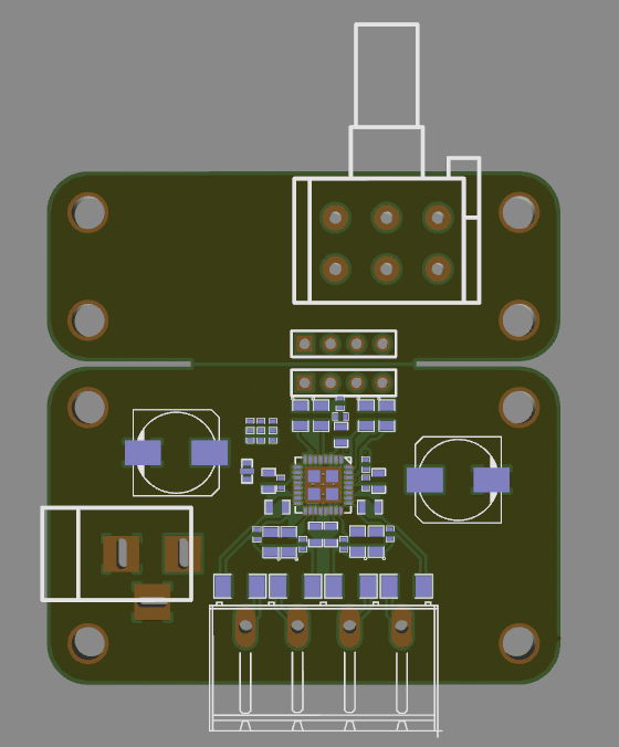

If done like the data sheet suggests it will work, and will likely damage the chip.
Should have read: ... will NOT work,...
I'm still not following. What would happen if, say, i used an 50V X7R here? The capacitance would be all sorts of voltage dependent, but how would that ruin my day?Ceramic capacitor are not very linear nor noise free when voltages near their rated voltage. You should always use ceramic capacitor with 10 times (4 times minimum) the voltage rating required in every case where the capacitor is in the direct signal path (bootstrap capacitors are in the direct output signal path).
EDIT: I get that an X7R is going to be really non-linear when biased near it's max voltage, but i don't get why linearity is really needed here. The bootstrap pins probably don't behave any sort of linearly.
I also recommend using the FAULTZ pull-up connection of MUTE as described in the data sheet. Although the data sheet is completely wrong in how it's actually done. If done like the data sheet suggests it will work, and will likely damage the chip. Do it as it's done in the eval board instead.
You're talking about the weirdness on page 19 in the datasheet? Still, why can't i just short MUTE to ground? I don't intend to short the outputs for extended periods of time.
Updated: https://github.com/rosvall/tpa3132-amp
This does feel less cargo cult. Star ground, every return path is clear. Nothing on top layer goes under the ferrite beads.
I'm keeping the input ferrite beads for now. I really hate those cable clip-on things.
How does it look to you?
Also, i feel kind of bad coming of so arrogant in my previous responses. It's not that i'm doubting you, i just really want to know the hows and whys. I'd like to get an intuition for this stuff.
Couple thoughts...
1. ADD 1210 x 2 bypass Caps (each side). Remove the 0805 stuff. The 1210 has the same ESL as a 0805. You can bypass with all the 0.1uf caps you like and it will not make a difference. High di/dt -> dv/dt.
2. REMOVE the FB on the ground. Changing the impendance on the ground plane is not going to help the noise issue.
3. The Main Power routing is too long and too narrow. Increase track width and shorten the distance. Route the Signal lines on the back side so the Power can be routed straight across.
4. I very much doubt you will be able to solder the TPA3132 to the PCB without wicking all the solder down those vias....plus the via density is too high. you need more surface area. You need to switch to the TPA3116. much easier to hand build.
5. Keep the snubbers on the chip side and remove post FB snubbers. You need to relax on the EMI / RF issues. You have them covered.

I need to read up on MLCC SMD caps. I don't quite get why their datasheets don't have any ESL or ESR figures.Couple thoughts...
It wouldn't help with common mode noise?2. REMOVE the FB on the ground. Changing the impendance on the ground plane is not going to help the noise issue.
Done! I think that part looks much better now.3. The Main Power routing is too long and too narrow. Increase track width and shorten the distance. Route the Signal lines on the back side so the Power can be routed straight across.
I've removed some of the vias. I do imagine it's going to a pain in the *** to put this thing together, but i like the awesome compactness of the QFN. Also, i think it's more elegant to use the ground plane as heat sink, than some clumsily mounted alu profile. Somewhere, probably in the tpa3116d2 thread, Saturnus mentioned mounting the backside of a board directly to a case/heat sink. I quite like that idea, even if it would require some annoying SMD connectors.4. I very much doubt you will be able to solder the TPA3132 to the PCB without wicking all the solder down those vias....plus the via density is too high. you need more surface area. You need to switch to the TPA3116. much easier to hand build.
Anyway, at the moment my plan for soldering it involves a toaster oven and a syringe of solder paste, and probably a lot of swearing 🙂
I do want to have them covered. The trouble is that i'm really ignorant and would rather be safe than sorry. I need to figure out how to calculate how much filtering is really needed.5. Keep the snubbers on the chip side and remove post FB snubbers. You need to relax on the EMI / RF issues. You have them covered.

In any case, thanks for taking the time. I appreciate it. I feel like this thread is really making me smarter, even if it might seem like an uphill battle for you guys.
OK ROSVALL,
I see we are making progress... Strong Work on removing the FB on the GROUND 😉
Couple thoughts...
1) Given the current size of 31 mm x 38 mm , you only need two mounting points. You will need the space for the issue in #2.
2) The routing for C6/C7 is weak...
The caps are 'bypassed' by the current routing The routing needs to go 'across the pad'.
3) The FB traces needs to be wider... seriously use some copper. 🤐... The Trace from the FB to the Supply trace is absolutely lame...
Go Big or Go Home.
4) I see you have narrowed the Supply tracks again... See #3
5) Any Chance of a 1210 ?? or is it
5) Final thought for the evening.... You are dumping all the heat into the GND plane. Any plans to remove it ?? The PCB's limited heat capacity is going to become very
when you turn the volume up.
Dwight
Couple thoughts...
Dwight
https://github.com/rosvall/tpa3132-amp/blob/master/tpa3132-amp.pcb.composite.png
Heh, thanks.OK ROSVALL,
Couple thoughts...
You're right. It's a bit sloppy.1) Given the current size of 31 mm x 38 mm , you only need two mounting points. You will need the space for the issue in #2.
2) The routing for C6/C7 is weak...The caps are 'bypassed' by the current routing The routing needs to go 'across the pad'.
Duly noted.3) The FB traces needs to be wider... seriously use some copper. 🤐... The Trace from the FB to the Supply trace is absolutely lame...Go Big or Go Home.
I admit they it's a bit thin and sad looking, but it's only supposed to carry like 2-3A.4) I see you have narrowed the Supply tracks again... See #3![]()
It's coming, i've just not yet found a cap that i like. And i still haven't found any specific figures on ESL and ESR, which bugs me. I'd like to at least be able to pretend to make an informed choice based on some numbers.5) Any Chance of a 1210 ?? or is it??
The idea (that i've stolen from Saturnus) is to mount the board on some sort of heat sink. I've still to find some appropriate SMD connectors to make that possible though.5) Final thought for the evening.... You are dumping all the heat into the GND plane. Any plans to remove it ?? The PCB's limited heat capacity is going to become verywhen you turn the volume up.
Dwight

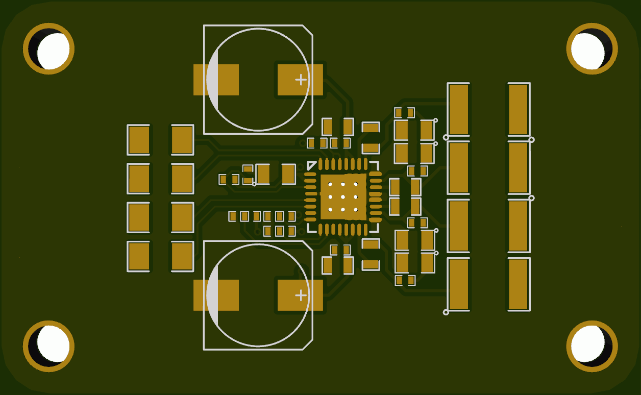

Placement of core components within 50x32mm (fitting DP5032 case):
Of course, power-paths needs to get polygonized and alot of via stitching needs to be done. (Beside adding connectors)
