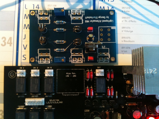

Hi regiregi22, me too 😉
Before, I've to power up my LightSpeed too, I'm in lack of 5V PSU.
Could someone point me a scheme for wiring DCB1 and LightSpeed PCB ?
Thanks !!!
I think Alon has a board like that? Maybe he can let you know if he reads.

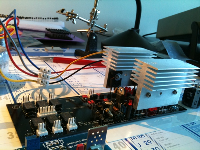

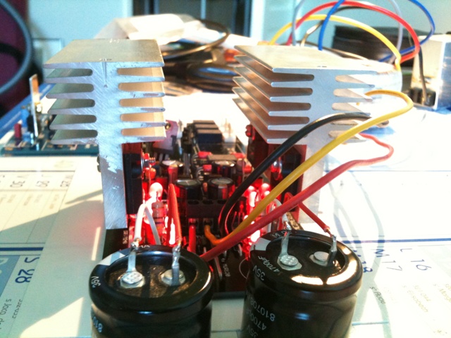

Pics of the build in progress...
As you can see very "high" built. I've planned to cut Mosfet's legs, same operation for 2SK170BL.
Another point concerns the free space between the LT7812 and the right Mosfets sink : find a heatsink that fits !
I'm using 5V relays and the LT gets hot.
Heatsinks are recycled, they came from old Compaq Proliant PSU, hand saw cutted yesterday.
Do you think it's a good idea to thermally coupling the 2SK170-BL quad ?
Bend the LT forward a bit and bolt one sink on it.🙂 Nothing to really gain by coupling the quad IMHO, its not about a differential amplifier.

I really love those heatsinks, it reassembles some kind of V8 engined car.Pics of the build in progress...
Oh, and I don't need a heatsink for the LT7812. Is runs at ambient temp even after some hours turned on. I'm using a 12v relay though.

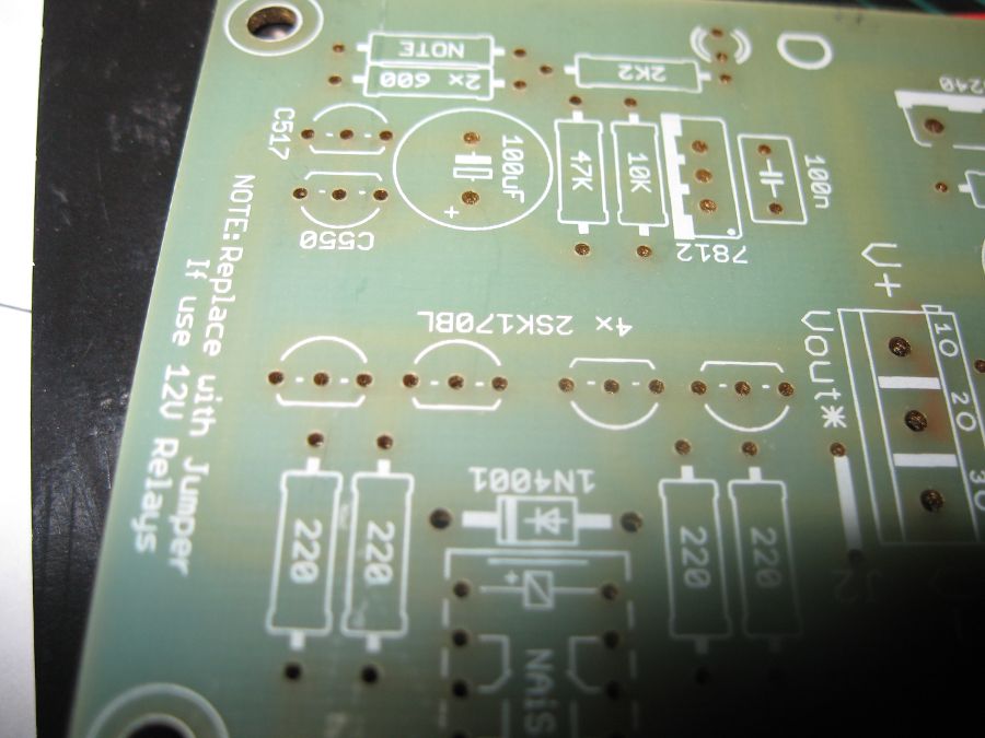

Posted this on the GB section, this thread is probably more appropriate..

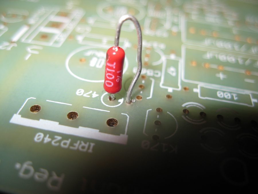

Ok, been stuffing the boards with parts I have available. If we are looking at the board horizontally on top right IRFP240 it looks as if there is an insertion hole missing for one end of the 470r resistor.
Also, the BOM states that there are 4 sk170 matched, where on the board do they go?
BOM does not have a part number for the relay, does anyone happen to have for mouser or digikey, please?

parts placement
Wendell, hope this helps. 470r one stands soldier style.
Relay I used is OMRON Mouser 653-G6H-2-100DC12
Thanks for the quick reply! Looking on the underside of the board gives a correct perspective.
And the matched sk170 beside the relay?
Yes. Near relay. The whole Buffer part (the rest power supply) is after the VOut* seen on right of pic. So all to the left is the buffer, not much to it. The Vout* jumper (white stripe) must be applied in order for Buffer to power up. Otherwise it's just a nice shunt reg supply. There are two other jumpers that need to be done in the power supply as well.

Hi Just saw this!!! Sorry Korben69
Its very difficult to explain, but if you havnt already set up your dcb1 with optivol, you could try having a look at page 167 post 1665 There i have posted some pics of my build...the pics are not very good quality, but you can see how the two are connected together. If you cant quite work it out by looking at the pics, then pm me and i will try to explain 🙂
On a side note, I would highly recommend powering the optivol, with a Salas Shunt reg set to 5v...i tried quite a few combinations of power supplies for running the optivol and by far the best was removing the power supply section of the optivol board and running direct with 5v salas shunt reg, i did try the salas shunt reg set to 8v as a prereg, and then this went into the optivol 5v supply, but this did not sound as good. Pics to follow.
Alon

Thank guys you for your answers 😉
Malka07, I'll send you a PM for my built, your help will be great. Very nice result, I like the "Zen look" !
I use a Mezmerize board not Hypnotize. I'll try a GoldMinireg as PSU for the 5V.
Your pics show that you've wired the LDR Output(L/R) to the Hypno Input(L/R).
How should I proceed with the Pot on the Mezmerize PCB ?
Should I just ignore it ? 😕 😕
