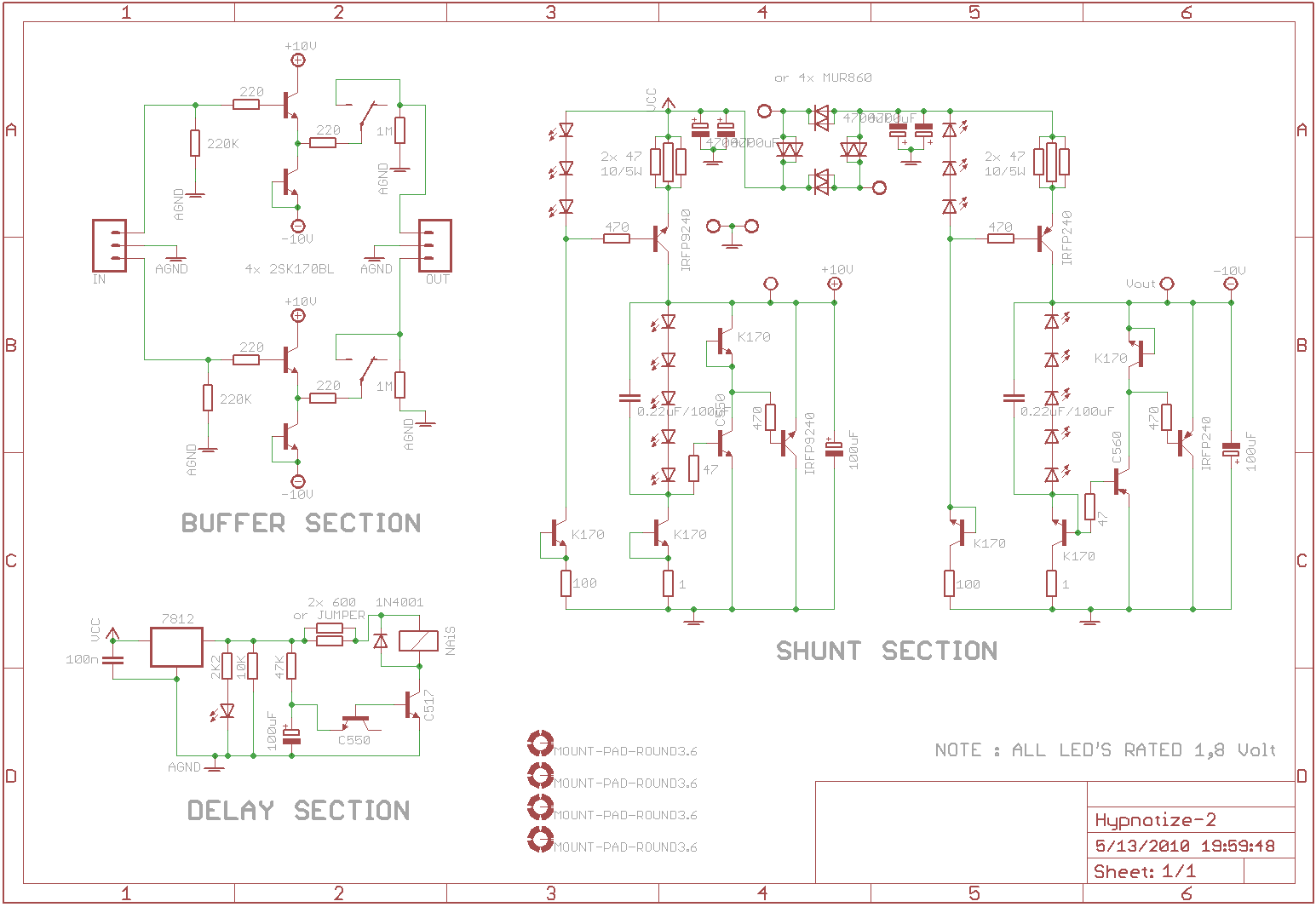

hum
I use BC546 for driving relay.
My System : Player<->DC B1-with shuntreg<->Gainclone 3886.
There is no hum when GC power ON and DC B1 still OFF, but after DC B1 ON and relay still OFF, i heard hum loudly.
tq
Sorry for late response.We have no reports here about such an incident before. If your amplifier has capacitor input you can hardwire the relay signal points always on. Without info I can't guess your system. Do you use BC517 for driving the relay?
tq
You need BC517 in case you hear any strange mechanical noises from the relay.
The solution for you is in the pages 177-178. Do that grounded cross mod and it will not interact again.
But the steady recommendation for any system from stadium PA to home, is we turn on the power amp last and we shut it down first. To turn on/off any device before it when power's on is risky anyway. So when you will do that Oenboek's mod don't forget and go on/off all the time with the power amp on just because there will be no tell tale noises.

hum
Last night i try upgrade grounding system of power source (line) and suddenly everything is quite just like "coffins ".
Thanks salas,You need BC517 in case you hear any strange mechanical noises from the relay.
Whatever. I did not experience it myself either nor it was picked up by the numerous proto testers. Something in some systems must be exaggerating it. Maybe grounding too as you say. Keep in mind the solution mod if it appears again with some other partner equipment though. Thanks for reporting.
Just want to report, that i have been runnning the dcb1 for a couple of days now since i did the grounded cross mod, and everything is fine, there are no problems to report with this mod, so if anyone is experiencing hum(buzz) when powering down the dcb1 while the poweramp is on, then as Salas say "The solution for you is in the pages 177-178" plus you get the advantage that it takes the relay out of the signal path
... Salas say "The solution for you is in the pages 177-178" ...
Would it be too much to ask for Post #s instead of Page #s - some folks elect to have more posts per page.
Thanks,
Not diffucult to estimate: from post #1761 to # 1780Would it be too much to ask for Post #s instead of Page #s - some folks elect to have more posts per page.

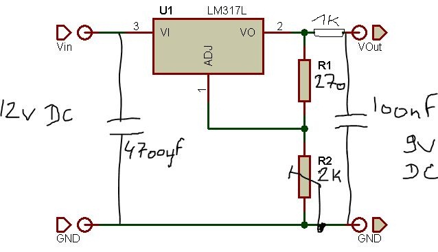

Quote:
Originally Posted by Salas View Post
Using a 9V battery and 1k2 protective resistor to feed, and you measure each one's ends for voltage when alight.
Hi Salas
Am I right using this for matching Led's with 1K at Vout ?
(posted before in the wrong thread)
Hi Salas
