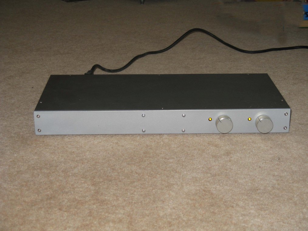

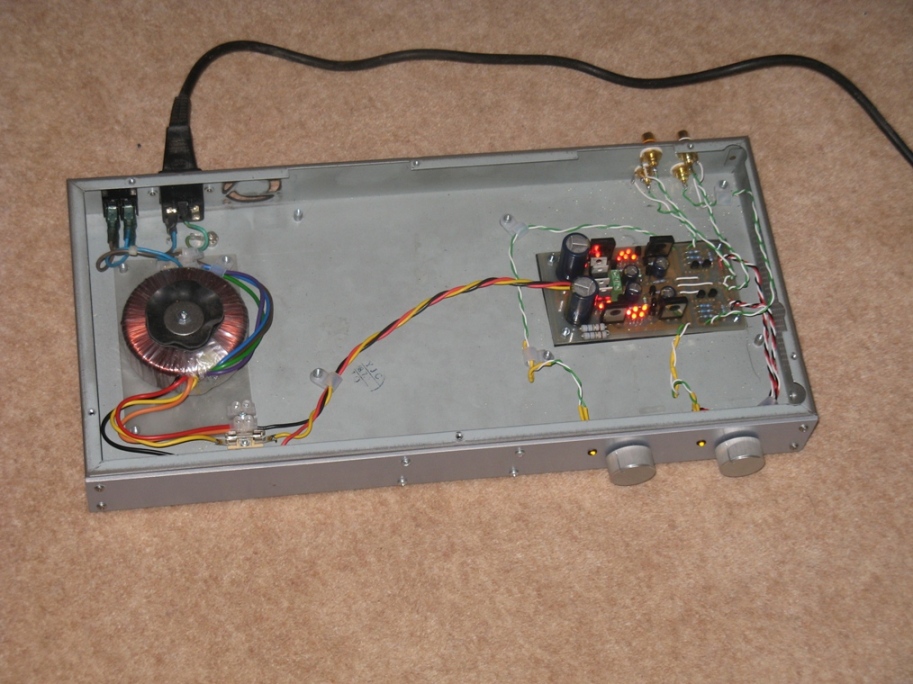

My finished attempt - old computor case, homemade PCB - sounds very nice so very pleased 😀 - I built this and a SymaSym 5.3 as a beginners project, but was only able to do it by referring to the two threads on this forum, which have supplied me with all the technical support that I have needed. My thanks to Salas and everybody else whose expertise has been shared via this forum
