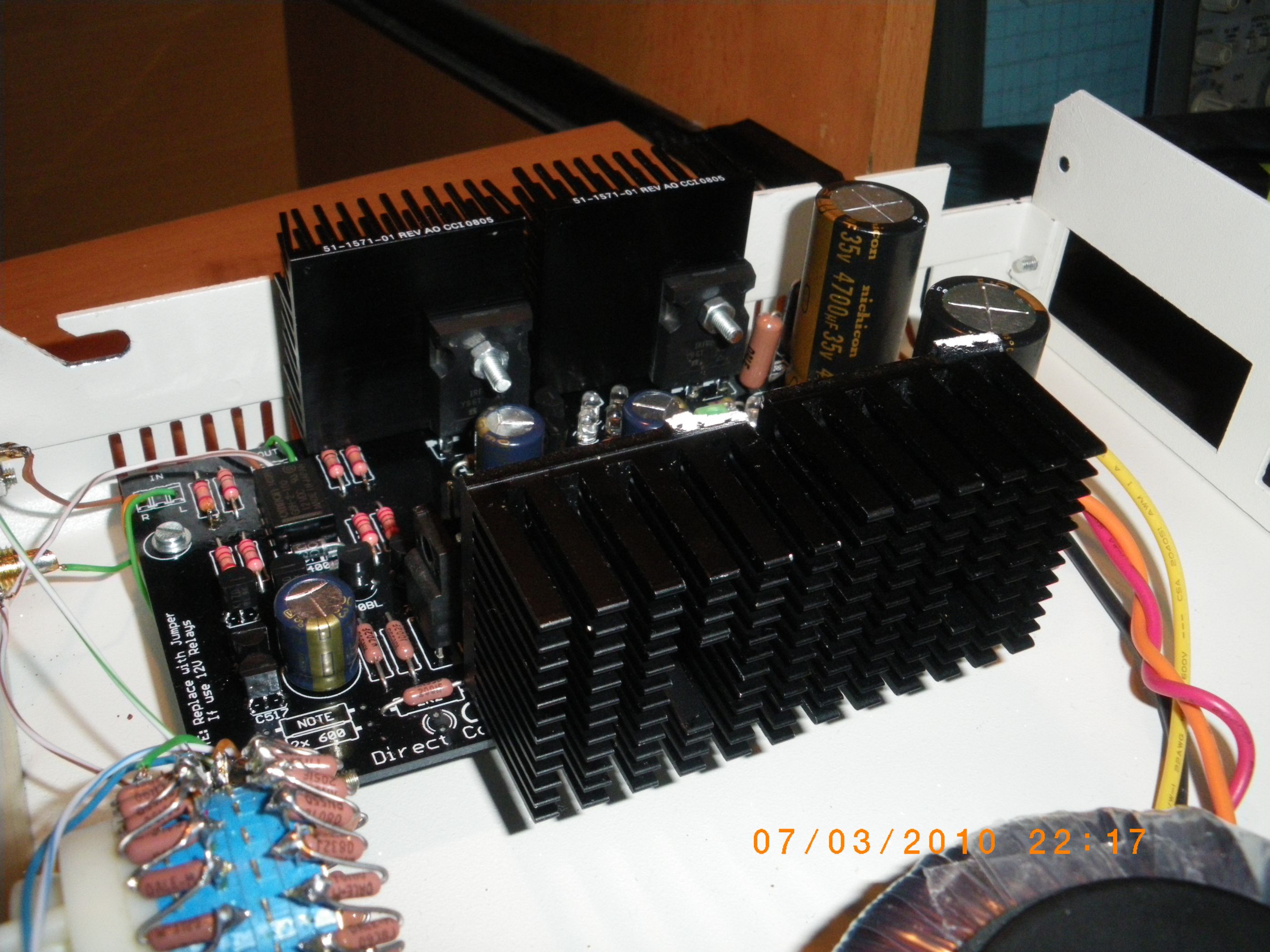

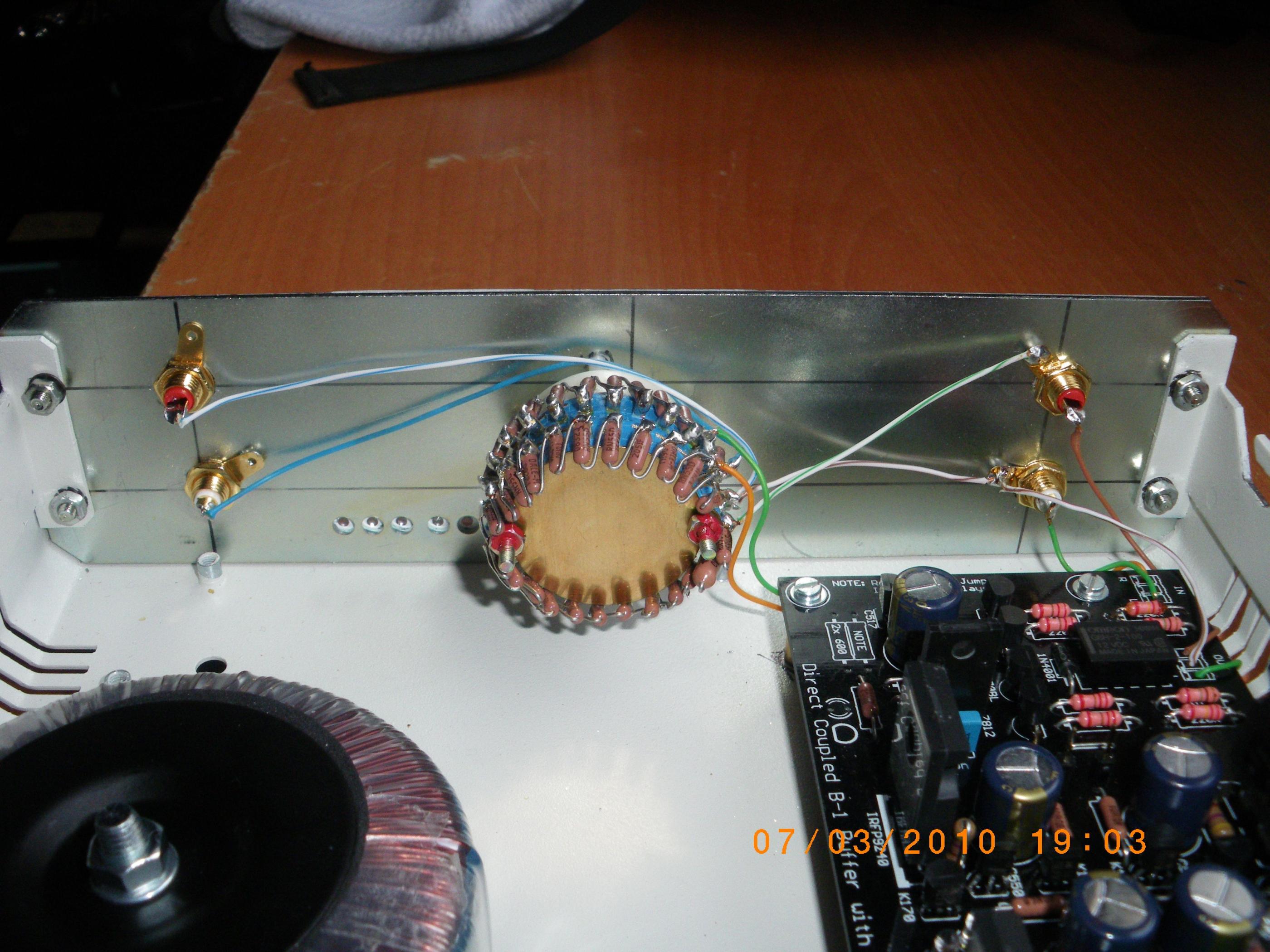

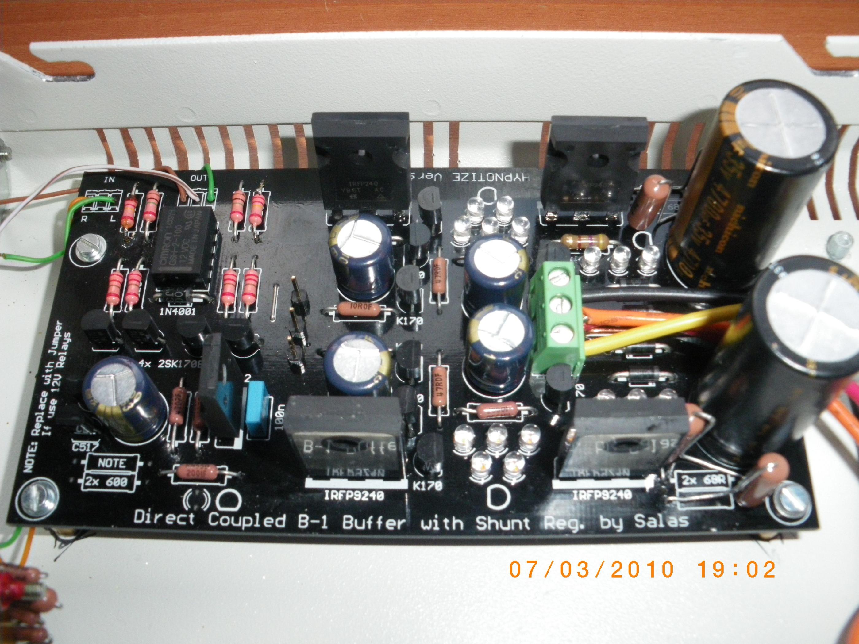

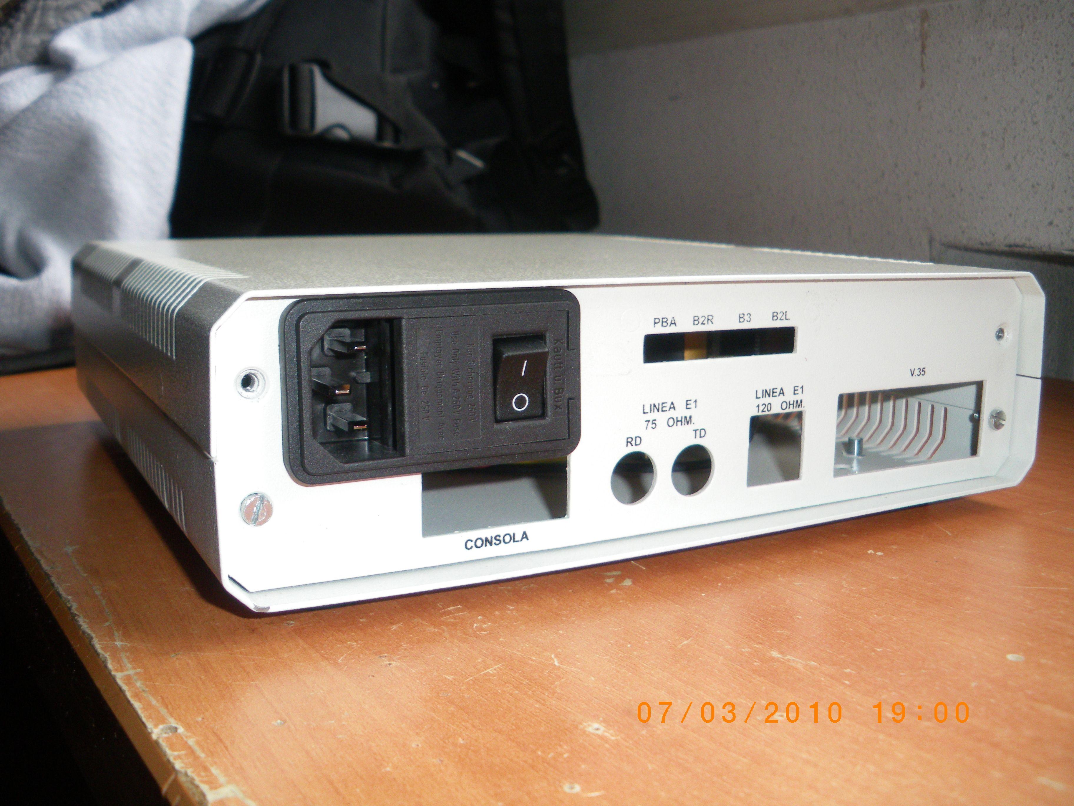

This is my DCB1. I dont plan to make it look better or painting it, my mainly end is trying to get best sound. I finished that DIY stepped attenuator last week, it's 20k. I found a bargain at ebay, a 24 steps double rotary switch for 10$ shippment included, so I had to bought the Dales from mouser. It is internal wired with single core cat5e wires. It has placed underneath an output cap for the delay-start regulator. Pannasonic FM and Nichicon Audio KW capacitors, Dale and Takeman resistors. An all-steel chassis construction.
It sounds excepcionaly clean, putting my ear near the cone at max vol I cannot hear even a slight hum from it. It was substituting nothing, I was controlling the volume with the pot of the emu0404. I plan to bypass it with a wire, it doesnt seem to be good enought for the task.

Yes its nice to see a shining one. Do short your Emu's output pot, will help. I see 3 gold flashed pins on the reg bus. You plan to supply something extra?
I don't plan to supply anything else, I just put those pins to work as test probes, to check voltages, etc.
I have another spare DCB1 board if in the future I plan another preamp or just the shunt supply to power anything like, maybe, a DAC. I haven't yet found a near perfect DAC which decided me to build. The same as this DCB1 or my PPAv2 headphone amp (which I consider both to be amongst the best devices in their class), I am still looking for a long term high end dac.

I replaced those 100uF caps with some film ones today, hoping to get a listen later tonight. On first turn on, its very subtle, but maybe its a little smoother than before, but I can't really tell yet.
The caps are from madisound, carli caps:
Carli Mylar 4.7 mfd from Madisound
I do have some Wima MKP 4.7uF (as well as much smaller values, 0.22 and 0.33uF) that I can swap in but they're not as easy to mount.

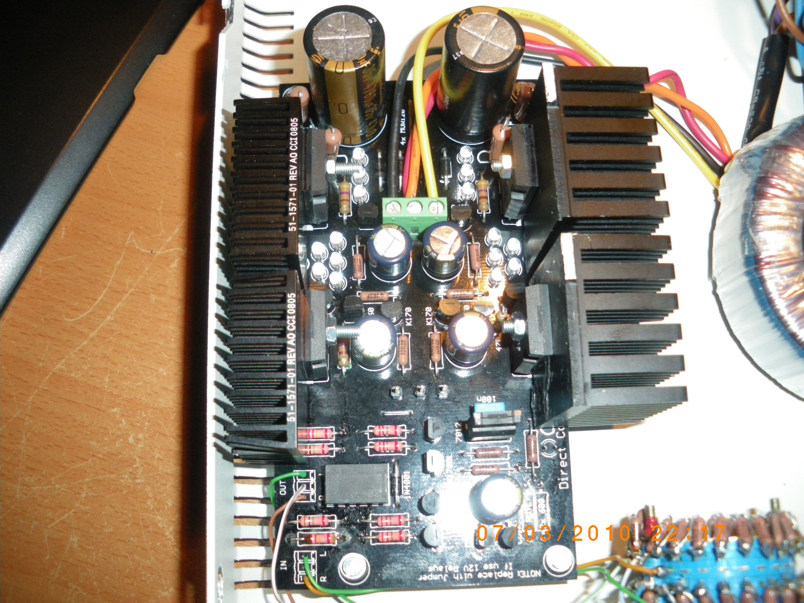

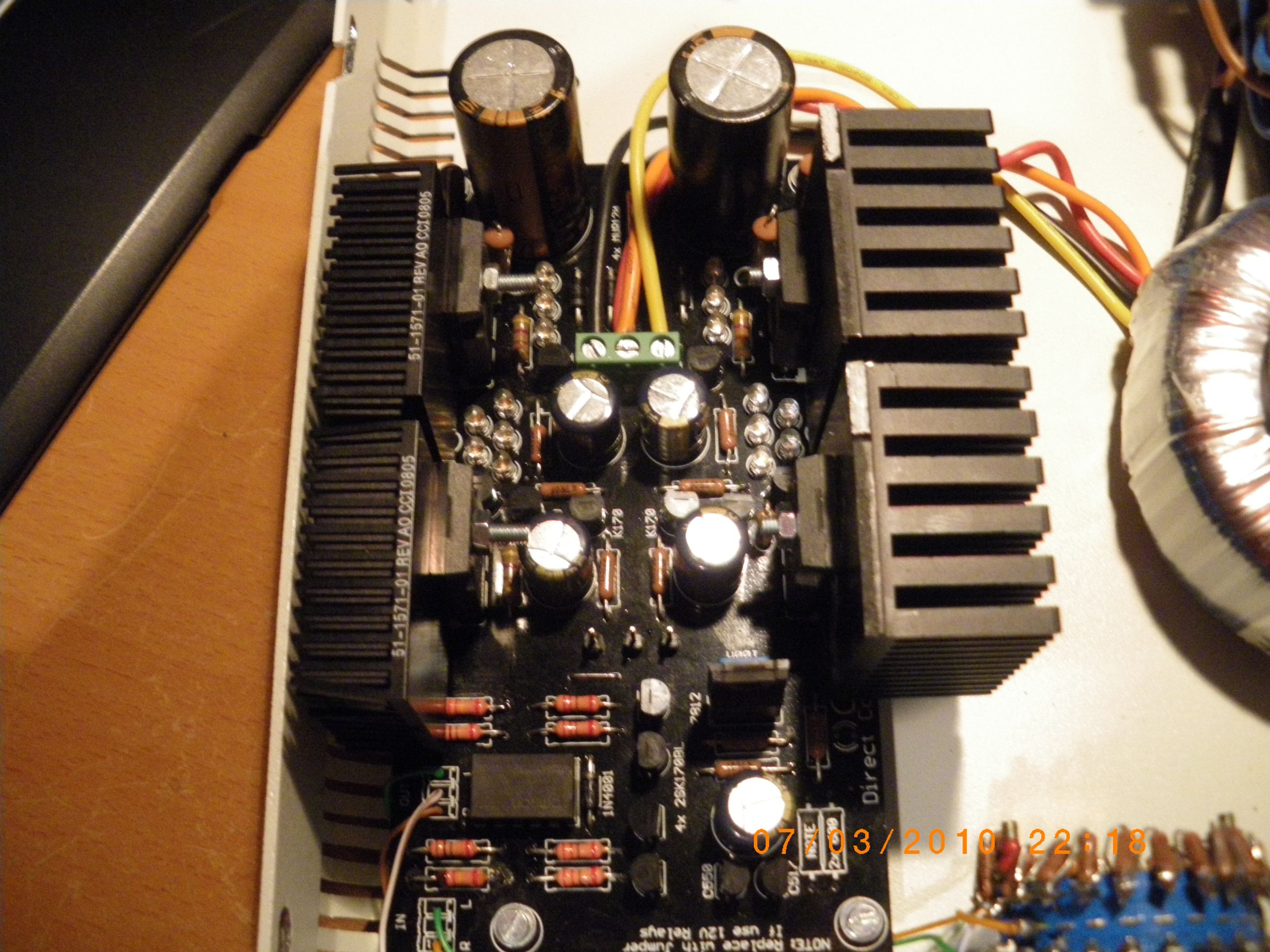

I'e been heatsinking it this evening, now it is ready for a big CCS.
What I have in my parts bin are 2W 2.2 Ohm, 2.7 Ohm and 4,7 Ohm.
I plan to put 2 x 4.7Ohm in series to achieve 9.4Ohm, what will give me (from 2.456v drop in R1) a 261mA CSS.
Or add a 3rd resistor of 2.2 in series to get 211mA CCS
With 261mA it disipates 0.64W and with 211 it does 0.5W. I think 2W resistors are enought for both options, what do you think?
