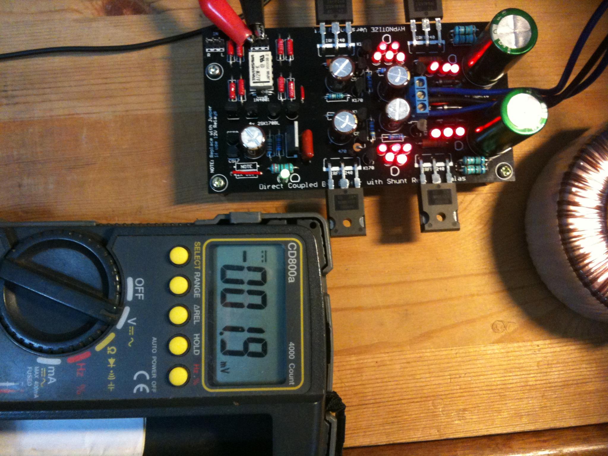

I have finally complete all the components soldering for DCB1. 😀 Now still waiting for Alps 20k volume pot from RS components, and source for chassis for it.
1. Main supply rail: +10.64V and -9.67V
2. Volt. drop across 68//68 : 1.613V and 1.750V
3. DC offset: R= 1mA and L= -2mA
May i know i there anything wrong with my DCB1?
Thanks.

the 68//68 with just 1.6V across it is passing just 47mA through the CCS.
The two B1 stages may be taking Iq~8+8mA, the shunt circuit could be taking 12mA. That leaves just 19mA passing through the shunt FET.
That may be a bit low.
Experiment with adding a further 68r to make three in parallel and maybe a fourth 68r in parallel. Each 68r passes ~24mA through the CCS.
